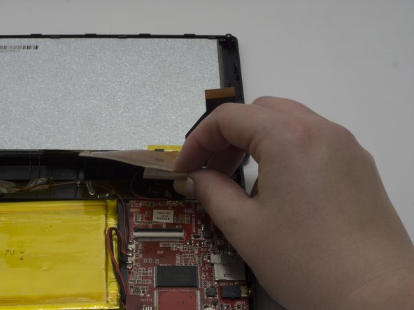

    • The flexible flat cables (FFC) attach to parts in the bottom panel with zero insertion force (ZIF) connectors.
    • Use the Opening tool to flip up the black retaining flap on the smaller connector.
    • Gently lift the cable, parallel to the panel, to detach it.

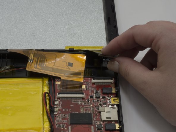

  5. Polaroid PMID701i 10 USB Charging Port Replacement: crwdns2935265:05crwdnd2935265:01crwdnd2935265:02crwdne2935265:0 Polaroid PMID701i 10 USB Charging Port Replacement: crwdns2935265:05crwdnd2935265:02crwdnd2935265:02crwdne2935265:0
    • Use the Opening tool to flip up the black retaining flap on the larger connector.

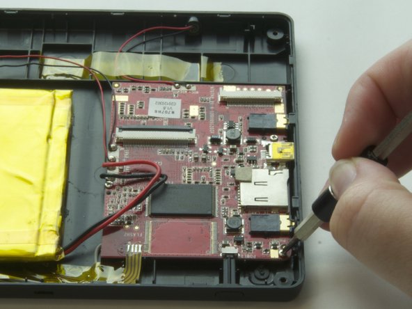

    • The motherboard attaches to the back panel with three 3.5mm long screws.
    • Unscrew the three screws with a PH000 screwdriver.

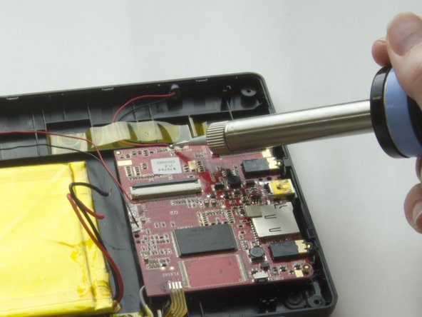

    • Solder beads attach the wires that connect the motherboard to other parts, such as the battery and the speaker.
    • Desolder the wires from the motherboard. For detailed information, refer to the Solder and Desolder guide.

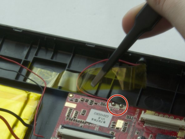

  8. Polaroid PMID701i 10 USB Charging Port Replacement: crwdns2935265:08crwdnd2935265:01crwdnd2935265:02crwdne2935265:0 Polaroid PMID701i 10 USB Charging Port Replacement: crwdns2935265:08crwdnd2935265:02crwdnd2935265:02crwdne2935265:0
    • Some of the wires attach to the panel with tape as well.
    • Use tweezers to gently lift the tape from the wires and plastic.

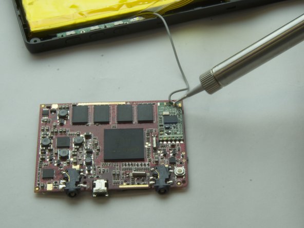

  10. Polaroid PMID701i 10 USB Charging Port Replacement: crwdns2935265:010crwdnd2935265:01crwdnd2935265:02crwdne2935265:0 Polaroid PMID701i 10 USB Charging Port Replacement: crwdns2935265:010crwdnd2935265:02crwdnd2935265:02crwdne2935265:0
    • There is a grey wire attached to the back side of the motherboard.
    • Flip the motherboard over to the side so that the grey wire and its solder bead faces up.
    • Desolder the gray wire from the motherboard.

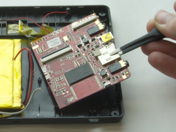

  11. Polaroid PMID701i 10 USB Charging Port Replacement: crwdns2935265:011crwdnd2935265:01crwdnd2935265:02crwdne2935265:0 Polaroid PMID701i 10 USB Charging Port Replacement: crwdns2935265:011crwdnd2935265:02crwdnd2935265:02crwdne2935265:0
    • Use tweezers to lift the motherboard from the panel.
