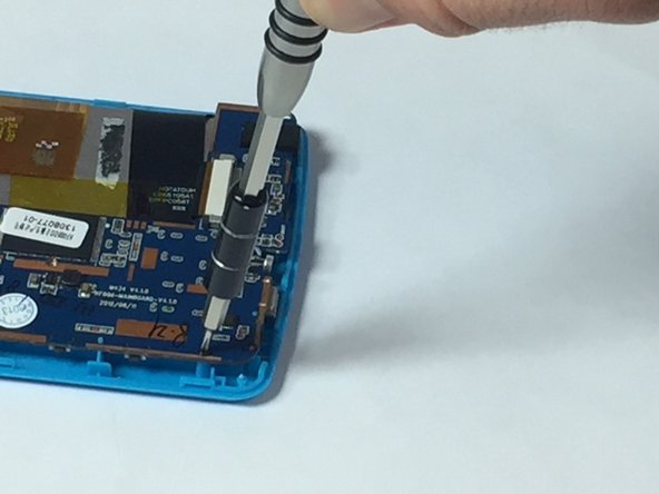

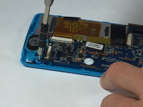

  9. Polaroid PMID4312 Motherboard Replacement, Motherboard: crwdns2935265:09crwdnd2935265:01crwdnd2935265:02crwdne2935265:0 Polaroid PMID4312 Motherboard Replacement, Motherboard: crwdns2935265:09crwdnd2935265:02crwdnd2935265:02crwdne2935265:0
    • Using the ph#00 screwdriver, remove the four 5mm screws connecting the motherboard to the casing.

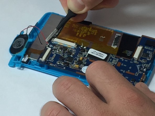

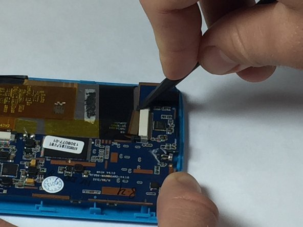

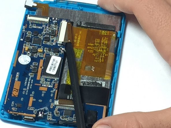

  10. Polaroid PMID4312 Motherboard Replacement: crwdns2935265:010crwdnd2935265:01crwdnd2935265:03crwdne2935265:0 Polaroid PMID4312 Motherboard Replacement: crwdns2935265:010crwdnd2935265:02crwdnd2935265:03crwdne2935265:0 Polaroid PMID4312 Motherboard Replacement: crwdns2935265:010crwdnd2935265:03crwdnd2935265:03crwdne2935265:0
    • Using a spudger or a fingernail, detach the two ribbons from the motherboard by pushing the plastic tab away from the Zero Insertion Force connectors.
    • As the name implies, no force is needed to plug in or remove the cable.
    • Be sure you are prying the plastic tabs connected tab and not the connector itself.
  11. Polaroid PMID4312 Motherboard Replacement: crwdns2935265:011crwdnd2935265:01crwdnd2935265:01crwdne2935265:0
    • Now carefully remove the motherboard.
