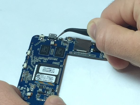

  12. Polaroid PMID4312 Charging Port Replacement, Charging port: crwdns2935265:012crwdnd2935265:01crwdnd2935265:02crwdne2935265:0 Polaroid PMID4312 Charging Port Replacement, Charging port: crwdns2935265:012crwdnd2935265:02crwdnd2935265:02crwdne2935265:0
    • Desolder each side of the USB port where it is attached to the motherboard.
    • The USB port will now be loosened from the motherboard.
    • Using tweezers, pull the USB port straight out from the motherboard without wiggling it up, down, or side to side.
    • The USB port is now replaceable.
