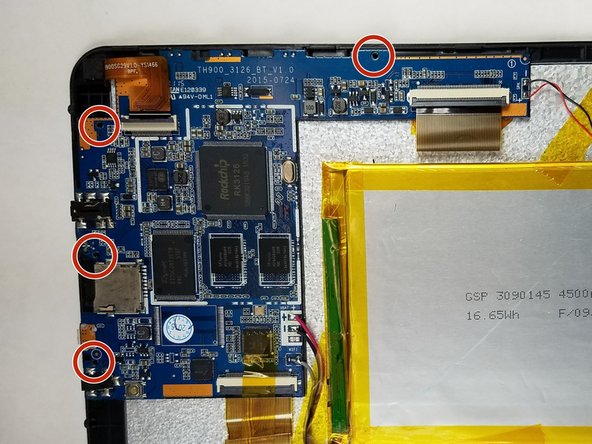

    • Using the PH00 screwdriver, unscrew the four 4.4 mm screws that are anchoring the circuit board down to the rest of the tablet.

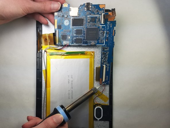

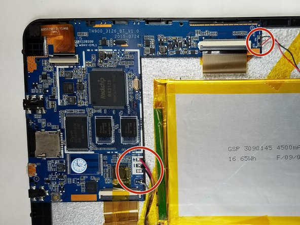

  5. Polaroid P902 Motherboard Replacement: crwdns2935265:05crwdnd2935265:01crwdnd2935265:03crwdne2935265:0 Polaroid P902 Motherboard Replacement: crwdns2935265:05crwdnd2935265:02crwdnd2935265:03crwdne2935265:0 Polaroid P902 Motherboard Replacement: crwdns2935265:05crwdnd2935265:03crwdnd2935265:03crwdne2935265:0
    • Using a soldering iron, desolder the points circled on the picture until the solder have liquefied enough to be able to remove the wires from the circuit board.
  6. Polaroid P902 Motherboard Replacement: crwdns2935265:06crwdnd2935265:01crwdnd2935265:01crwdne2935265:0
    • Gently lift the circuit board from the housing. You have now successfully removed the circuit board. Now, you can insert the new board to the tablet.
