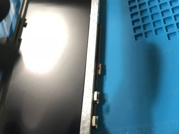

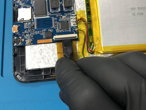

  3. Polaroid P902 LCD and Digitizer  Replacement, Ribbons: crwdns2935265:03crwdnd2935265:01crwdnd2935265:03crwdne2935265:0 Polaroid P902 LCD and Digitizer  Replacement, Ribbons: crwdns2935265:03crwdnd2935265:02crwdnd2935265:03crwdne2935265:0 Polaroid P902 LCD and Digitizer  Replacement, Ribbons: crwdns2935265:03crwdnd2935265:03crwdnd2935265:03crwdne2935265:0
    • Next using the flat end of a plastic spudger release the clips holding the ribbon circled in the first picture.

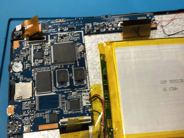

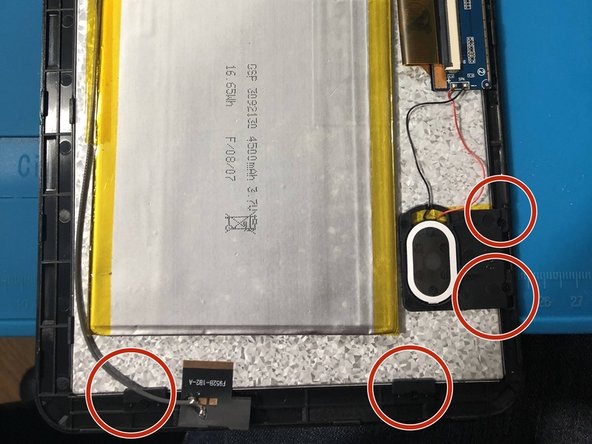

  4. Polaroid P902 LCD and Digitizer  Replacement, The Screws: crwdns2935265:04crwdnd2935265:01crwdnd2935265:02crwdne2935265:0 Polaroid P902 LCD and Digitizer  Replacement, The Screws: crwdns2935265:04crwdnd2935265:02crwdnd2935265:02crwdne2935265:0
    • Next switching to a PH000bit remove the 4 screws circled in the first picture holding the motherboard down.
    • Now remove the four screw circled in the second picture along with their plastic components.
    • Be careful when removing the plastic part holding the speaker in so as not to rip the speaker wire

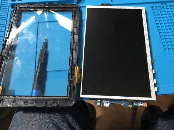

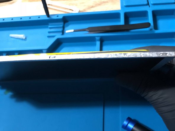

  5. Polaroid P902 LCD and Digitizer  Replacement, Removing the Digitizer: crwdns2935265:05crwdnd2935265:01crwdnd2935265:03crwdne2935265:0 Polaroid P902 LCD and Digitizer  Replacement, Removing the Digitizer: crwdns2935265:05crwdnd2935265:02crwdnd2935265:03crwdne2935265:0 Polaroid P902 LCD and Digitizer  Replacement, Removing the Digitizer: crwdns2935265:05crwdnd2935265:03crwdnd2935265:03crwdne2935265:0
    • Flip the tablet over gently, then applying slight pressure on the left hand side lift the digitizer from the LCD
    • it should just lift right off. However you may need to do a bit of wiggling. Don't stress if it doesn't drop right off.

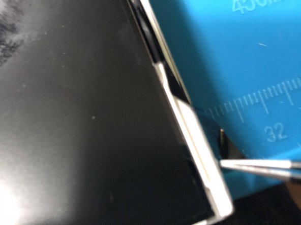

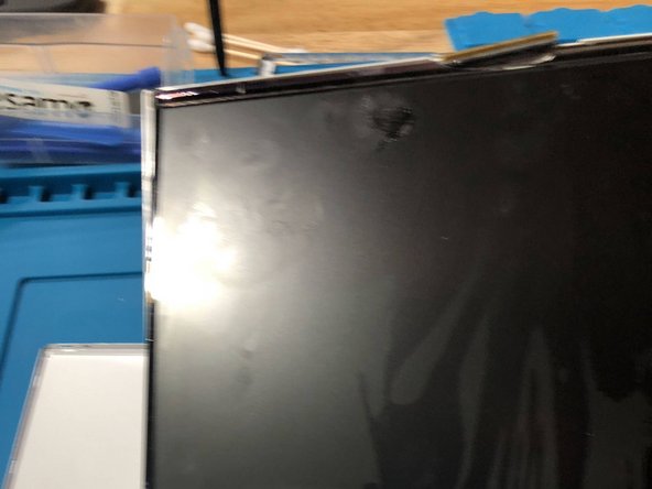

  6. Polaroid P902 LCD and Digitizer  Replacement, ALMOST THERE!!: crwdns2935265:06crwdnd2935265:01crwdnd2935265:03crwdne2935265:0 Polaroid P902 LCD and Digitizer  Replacement, ALMOST THERE!!: crwdns2935265:06crwdnd2935265:02crwdnd2935265:03crwdne2935265:0 Polaroid P902 LCD and Digitizer  Replacement, ALMOST THERE!!: crwdns2935265:06crwdnd2935265:03crwdnd2935265:03crwdne2935265:0
    • Now go around the edges of the metal and release the metal tabs holding the LCD in place
    • I used an iSesamo to do this, made it super easy
    • On the left side of the LCD screen after removing the top metal plate you will see a strip of adhesive, remove it and your almost done
  7. Polaroid P902 LCD and Digitizer  Replacement, FINALLY!!: crwdns2935265:07crwdnd2935265:01crwdnd2935265:02crwdne2935265:0 Polaroid P902 LCD and Digitizer  Replacement, FINALLY!!: crwdns2935265:07crwdnd2935265:02crwdnd2935265:02crwdne2935265:0
    • Now lift the LCD straight up and out of the bottom casing and you're halfway through the repair :D
    • Now insert the new LCD and reverse the steps. Pat yourself on the back o grab some snacks and check out your like new tablet.
