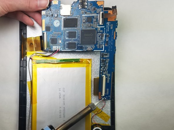

  5. Polaroid P902 Charging Port Replacement: crwdns2935265:05crwdnd2935265:01crwdnd2935265:03crwdne2935265:0 Polaroid P902 Charging Port Replacement: crwdns2935265:05crwdnd2935265:02crwdnd2935265:03crwdne2935265:0 Polaroid P902 Charging Port Replacement: crwdns2935265:05crwdnd2935265:03crwdnd2935265:03crwdne2935265:0
    • Using a soldering iron, desolder the points circled on the picture until the solder has liquefied enough to be able to remove the wires from the circuit board.
    • When using the soldering iron, be careful not to cause damage to the motherboard.
  6. Polaroid P902 Charging Port Replacement: crwdns2935265:06crwdnd2935265:01crwdnd2935265:02crwdne2935265:0 Polaroid P902 Charging Port Replacement: crwdns2935265:06crwdnd2935265:02crwdnd2935265:02crwdne2935265:0
    • Place the tip of the soldering iron on the four points circled in the image long enough to liquefy the surrounding solder.
  7. Polaroid P902 Charging Port Replacement: crwdns2935265:07crwdnd2935265:01crwdnd2935265:01crwdne2935265:0
    • Using tweezers, remove the charging port from the circuit board.
    • This should be done quickly as the solder will begin to solidify.
