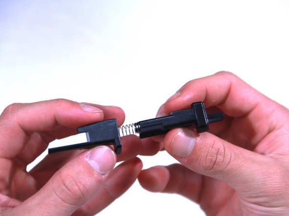

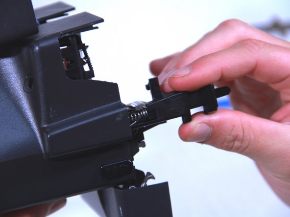

  4. Polaroid Onestep Close Up Shutter Switch Replacement, Shutter Switch Removal: crwdns2935265:04crwdnd2935265:01crwdnd2935265:03crwdne2935265:0 Polaroid Onestep Close Up Shutter Switch Replacement, Shutter Switch Removal: crwdns2935265:04crwdnd2935265:02crwdnd2935265:03crwdne2935265:0 Polaroid Onestep Close Up Shutter Switch Replacement, Shutter Switch Removal: crwdns2935265:04crwdnd2935265:03crwdnd2935265:03crwdne2935265:0
    • After the face plate is off, the shutter switch should slide out easily.
