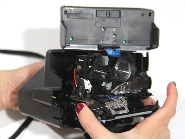

    • To remove the rear casing, use a spudger to leverage the sides of the metal frame at the bottom loose. If the spudger is in danger of breaking, it is safe to use a screwdriver.
    • With that, the entire inner assembly should be separated from the rear casing. Carefully remove it.

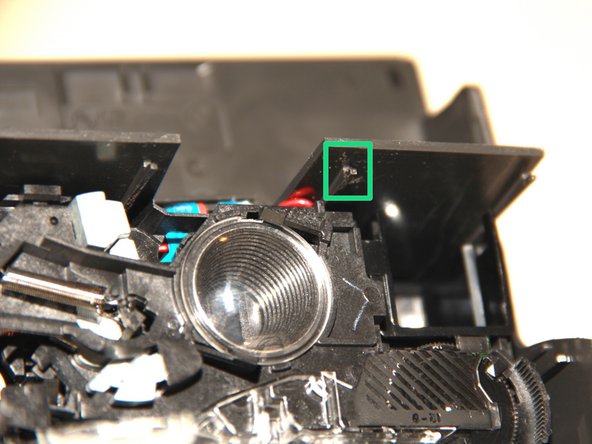

    • During reassembly, when re-inserting the core assembly into the plastic casing, remember not to let the small red wire (visible in the third image) catch onto the small black hook on the casing (green)! The wire must be held down so as not to be hooked.

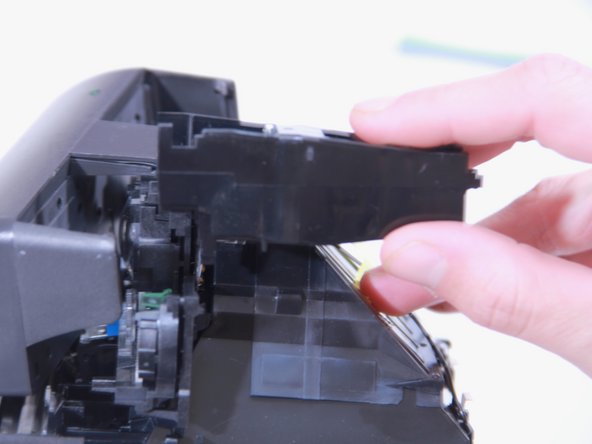

    • Once the rear casing is removed, lower the flash. The rear viewfinder lens assembly is located on the left side of the camera, when looking at it from the rear.
    • Simply wiggle the assembly loose.

    • In this case, there is a notch that is part of the lens shape (green) that fits into a matching groove in the enclosure (red). You will need to employ leverage to push the lens notch in and down while pulling the wall of the enclosure up in order to remove the lens.
    • WARNING: Removing the lens by exerting force on both it and the enclosure is very likely to break the fragile enclosure to some degree. The tolerances are very tight and the enclosure is reinforced in many different locations that may make the lens removal extremely difficult. Be very careful and think twice before attempting to remove the lens.
