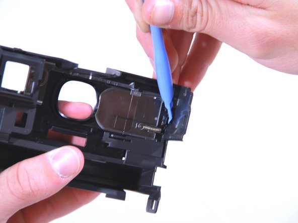

  3. Polaroid Onestep Close Up Forward Viewfinder Replacement, Removing Face Plate: crwdns2935265:03crwdnd2935265:01crwdnd2935265:03crwdne2935265:0 Polaroid Onestep Close Up Forward Viewfinder Replacement, Removing Face Plate: crwdns2935265:03crwdnd2935265:02crwdnd2935265:03crwdne2935265:0 Polaroid Onestep Close Up Forward Viewfinder Replacement, Removing Face Plate: crwdns2935265:03crwdnd2935265:03crwdnd2935265:03crwdne2935265:0
    • Insert the blue plastic opening tool between the rear case and the plastic tabs directly under the shelf, and pry it loose.
    • Pull off the face plate.
