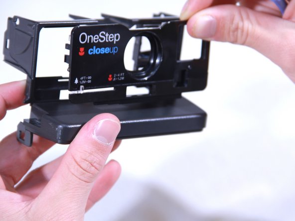

  4. Polaroid Onestep Close Up Close Up Lens Replacement, Removing the slider: crwdns2935265:04crwdnd2935265:01crwdnd2935265:01crwdne2935265:0
    • Pry off the slider (the light gray piece) by slipping it out from beneath the tabs (their location is indicated by the two red circles).

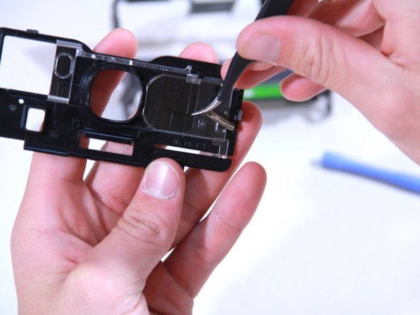

  6. Polaroid Onestep Close Up Close Up Lens Replacement, Removing the Spring: crwdns2935265:06crwdnd2935265:01crwdnd2935265:02crwdne2935265:0 Polaroid Onestep Close Up Close Up Lens Replacement, Removing the Spring: crwdns2935265:06crwdnd2935265:02crwdnd2935265:02crwdne2935265:0
    • Use tweezers to lift the ring of the spring off of the hook it is attached to.
    • Gently loosen and remove the spring.

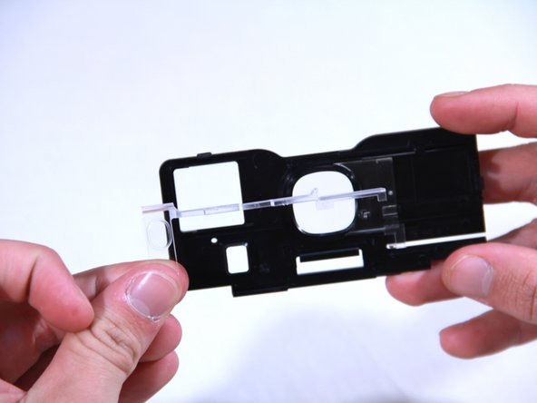

  7. Polaroid Onestep Close Up Close Up Lens Replacement, Removing the First Part of the Close Up Lens: crwdns2935265:07crwdnd2935265:01crwdnd2935265:02crwdne2935265:0 Polaroid Onestep Close Up Close Up Lens Replacement, Removing the First Part of the Close Up Lens: crwdns2935265:07crwdnd2935265:02crwdnd2935265:02crwdne2935265:0
    • Slide the CloseUp lens piece all the way to the left. It should separate without any resistance.

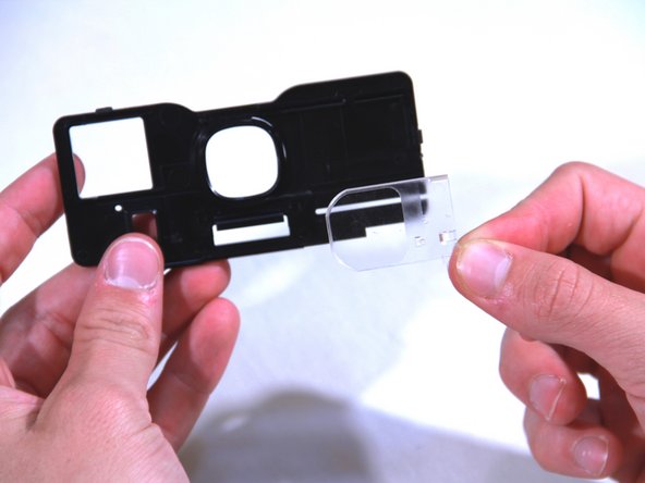

  8. Polaroid Onestep Close Up Close Up Lens Replacement, Removing the Second Part of the Close Up Lens: crwdns2935265:08crwdnd2935265:01crwdnd2935265:02crwdne2935265:0 Polaroid Onestep Close Up Close Up Lens Replacement, Removing the Second Part of the Close Up Lens: crwdns2935265:08crwdnd2935265:02crwdnd2935265:02crwdne2935265:0
    • Make sure the last plastic piece is set all the way to the right. Using the blue plastic tool, pry it loose. It should easily pop out.
