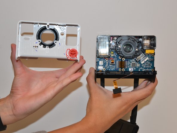

    • Remove the four 5mm screws on the base of the camera using a Phillips #0 screwdriver.
    • Remove the two pieces of the base.
  2. Polaroid OneStep 2 Shutter Switch Replacement: crwdns2935265:02crwdnd2935265:01crwdnd2935265:03crwdne2935265:0 Polaroid OneStep 2 Shutter Switch Replacement: crwdns2935265:02crwdnd2935265:02crwdnd2935265:03crwdne2935265:0 Polaroid OneStep 2 Shutter Switch Replacement: crwdns2935265:02crwdnd2935265:03crwdnd2935265:03crwdne2935265:0
    • Remove the four 5mm screws on the top of the inside base piece using a Phillips #0 screwdriver.
    • Remove the two 5mm screws on the bottom of the inside base piece which is near the strap with the same screwdriver.
  3. Polaroid OneStep 2 Shutter Switch Replacement: crwdns2935265:03crwdnd2935265:01crwdnd2935265:01crwdne2935265:0
    • Remove the black inside base piece.
  4. Polaroid OneStep 2 Shutter Switch Replacement: crwdns2935265:04crwdnd2935265:01crwdnd2935265:02crwdne2935265:0 Polaroid OneStep 2 Shutter Switch Replacement: crwdns2935265:04crwdnd2935265:02crwdnd2935265:02crwdne2935265:0
    • With force separate the white front piece from the back of the camera. You will use your hands and pull it apart.
  5. Polaroid OneStep 2 Shutter Switch Replacement: crwdns2935265:05crwdnd2935265:01crwdnd2935265:02crwdne2935265:0 Polaroid OneStep 2 Shutter Switch Replacement: crwdns2935265:05crwdnd2935265:02crwdnd2935265:02crwdne2935265:0
    • With force pull the shutter button away from the white piece of the camera.
