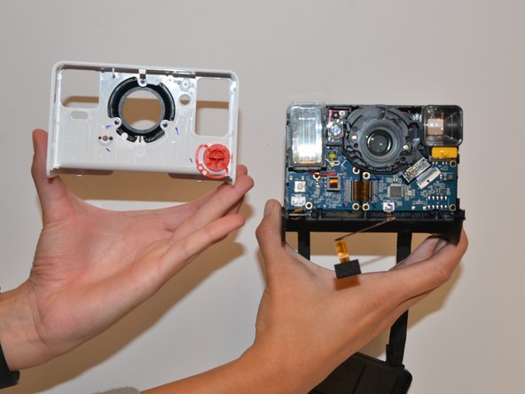

  4. Polaroid OneStep 2 Lens Replacement: crwdns2935265:04crwdnd2935265:01crwdnd2935265:02crwdne2935265:0 Polaroid OneStep 2 Lens Replacement: crwdns2935265:04crwdnd2935265:02crwdnd2935265:02crwdne2935265:0
    • With force separate the white front piece from the back of the camera. You will use your hands and pull it apart.

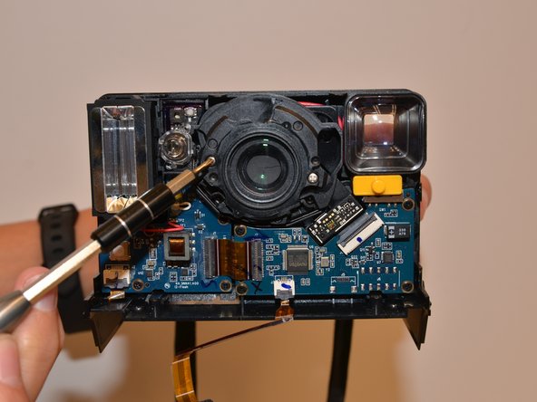

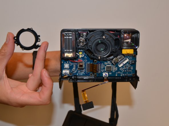

  5. Polaroid OneStep 2 Lens Replacement: crwdns2935265:05crwdnd2935265:01crwdnd2935265:03crwdne2935265:0 Polaroid OneStep 2 Lens Replacement: crwdns2935265:05crwdnd2935265:02crwdnd2935265:03crwdne2935265:0 Polaroid OneStep 2 Lens Replacement: crwdns2935265:05crwdnd2935265:03crwdnd2935265:03crwdne2935265:0
    • Remove the two Phillips #0 3mm screws on the black ring holding the lens in place and remove the ring.
  6. Polaroid OneStep 2 Lens Replacement: crwdns2935265:06crwdnd2935265:01crwdnd2935265:02crwdne2935265:0 Polaroid OneStep 2 Lens Replacement: crwdns2935265:06crwdnd2935265:02crwdnd2935265:02crwdne2935265:0
    • Remove the clear plastic lens with tweezers.

I followed this guide to a T, but it stops right before the replacement. I can even see the cracked lense in the last photo beneath the plastic lense you removed. How would one remove that internal lense and replace it?
