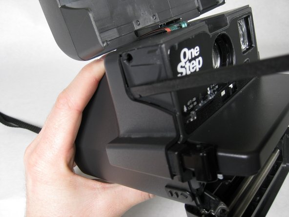

      • Open the flash compartment of the camera so it makes a 30 degree angle with the horizontal.
    2. Polaroid One-Step 600 Lens Replacement: crwdns2935265:02crwdnd2935265:01crwdnd2935265:03crwdne2935265:0 Polaroid One-Step 600 Lens Replacement: crwdns2935265:02crwdnd2935265:02crwdnd2935265:03crwdne2935265:0 Polaroid One-Step 600 Lens Replacement: crwdns2935265:02crwdnd2935265:03crwdnd2935265:03crwdne2935265:0
      • Separate the flash section of the camera from the main body by unhooking the sides with the spudger.
      • BE CAREFUL NOT TO YANK THE TWO SECTIONS APART BECAUSE THE BAND WIRE STILL ATTACHES THEM!

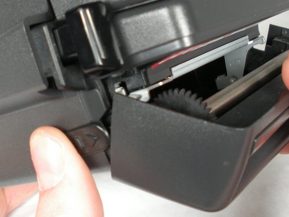

      • Fully open the battery/ cartridge compartment by sliding the side tab toward you.
    4. Polaroid One-Step 600 Lens Replacement: crwdns2935265:04crwdnd2935265:01crwdnd2935265:03crwdne2935265:0 Polaroid One-Step 600 Lens Replacement: crwdns2935265:04crwdnd2935265:02crwdnd2935265:03crwdne2935265:0 Polaroid One-Step 600 Lens Replacement: crwdns2935265:04crwdnd2935265:03crwdnd2935265:03crwdne2935265:0
      • Insert spudger in between face of camera and sides where the four tabs are located.
      • BE CAREFUL! The button that is pressed to take a picture may pop out of the camera at this step.

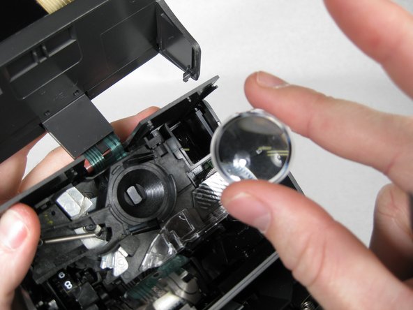

      • Use spudger to twist the notch on the lens into the opening to remove it.
    7. Polaroid One-Step 600 Lens Replacement: crwdns2935265:07crwdnd2935265:01crwdnd2935265:02crwdne2935265:0 Polaroid One-Step 600 Lens Replacement: crwdns2935265:07crwdnd2935265:02crwdnd2935265:02crwdne2935265:0
      • Carefully use spudger to release lens, then lift lens out of camera with fingers.
      • CAUTION: LENS MAY POP OUT OF CAMERA; REMOVE CAREFULLY.

Two questions: What is the function of the small striped part shown in picture 2 of step 5 and picture 1 of step 6? It appears to move with the brightness (exposure?) slider below the lens. Moving it towards the lighter side (right) moves the thicker stripes to cover that area more, and moving it to the darker side (left) moves the thinner stripes over the area, eventually leaving no stripes. Is it used for the camera's circuitry to adjust how long the shutter stays open when a photo is taken?
For a second question, what is the hole under the viewfinder for? It looks like it's a very basic "brightness indicator" you can look through to gauge whether the brightness of your photo will be bright enough; then again, that poses more questions, like, how bright is "bright enough." Thought I'd come ask you guys if anyone here knew. From what I've found, there aren't many people inquiring about its function.
