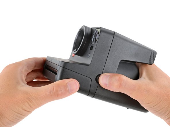

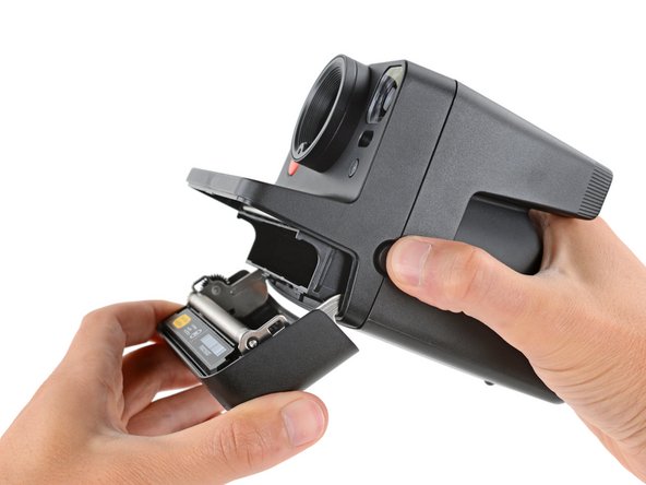

  2. Polaroid Now Gen 3 Rear Shell Replacement, Open the film door: crwdns2935265:02crwdnd2935265:01crwdnd2935265:03crwdne2935265:0 Polaroid Now Gen 3 Rear Shell Replacement, Open the film door: crwdns2935265:02crwdnd2935265:02crwdnd2935265:03crwdne2935265:0 Polaroid Now Gen 3 Rear Shell Replacement, Open the film door: crwdns2935265:02crwdnd2935265:03crwdnd2935265:03crwdne2935265:0

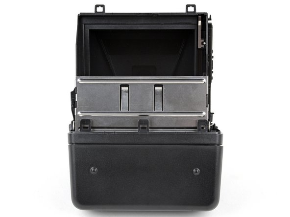

    • Throughout this guide, directional words (front, back, left, right) are from the perspective of using the camera—or when the lens faces away from you.

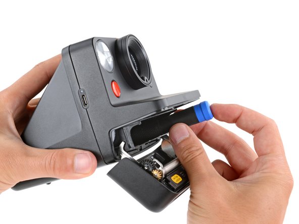

    • Hold down the latch on the left side of the camera and open the film door.

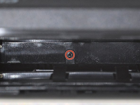

  3. Polaroid Now Gen 3 Rear Shell Replacement, Remove the rear shell screw: crwdns2935265:03crwdnd2935265:01crwdnd2935265:03crwdne2935265:0 Polaroid Now Gen 3 Rear Shell Replacement, Remove the rear shell screw: crwdns2935265:03crwdnd2935265:02crwdnd2935265:03crwdne2935265:0 Polaroid Now Gen 3 Rear Shell Replacement, Remove the rear shell screw: crwdns2935265:03crwdnd2935265:03crwdnd2935265:03crwdne2935265:0
    Magnetic Project Mat
    $19.95

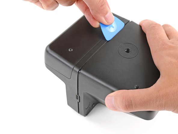

    • Use a Phillips screwdriver to remove the 5.9 mm‑long screw securing the rear shell.
    • The screw is hidden inside the camera on the back edge—you may need to use a flashlight to see it, as well as a skinny, long‑shank screwdriver to reach it.
    • Be careful when removing your screwdriver, as the screw can easily fall inside the camera. If it does, hold the camera above your work surface and gently shake it so the screw falls out.

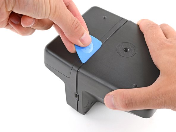

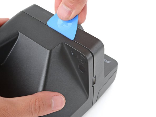

  4. Polaroid Now Gen 3 Rear Shell Replacement, Release the rear shell clips: crwdns2935265:04crwdnd2935265:01crwdnd2935265:03crwdne2935265:0 Polaroid Now Gen 3 Rear Shell Replacement, Release the rear shell clips: crwdns2935265:04crwdnd2935265:02crwdnd2935265:03crwdne2935265:0 Polaroid Now Gen 3 Rear Shell Replacement, Release the rear shell clips: crwdns2935265:04crwdnd2935265:03crwdnd2935265:03crwdne2935265:0

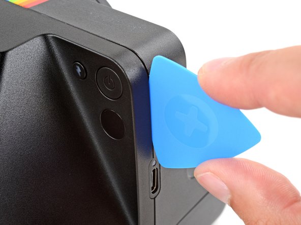

    • Insert the flat edge of an opening pick in the seam between the front and rear shells, just above the USB‑C port on the right edge.
    • Use your pick to pry the rear shell away from the front shell.
    • Keep the inserted edge of the pick pointed toward the rear shell when separating it. This helps release the tight plastic clips holding them together.

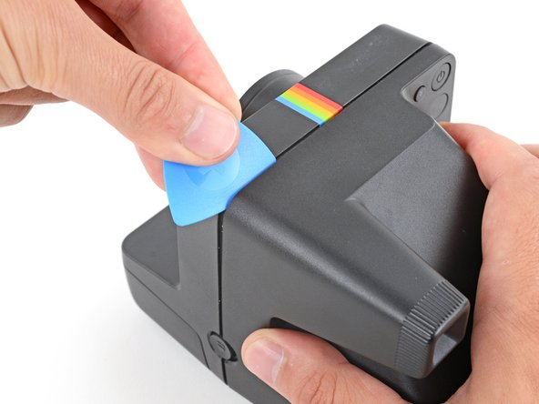

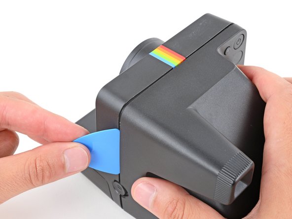

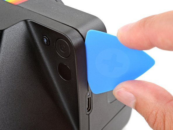

  5. Polaroid Now Gen 3 Rear Shell Replacement: crwdns2935265:05crwdnd2935265:01crwdnd2935265:03crwdne2935265:0 Polaroid Now Gen 3 Rear Shell Replacement: crwdns2935265:05crwdnd2935265:02crwdnd2935265:03crwdne2935265:0 Polaroid Now Gen 3 Rear Shell Replacement: crwdns2935265:05crwdnd2935265:03crwdnd2935265:03crwdne2935265:0
    • You should feel and hear distinct "clicks" as the clips release. If you don't, try again—it may take multiple attempts.
    • Slide your pick around the top right corner and along the top edge to release the clips.

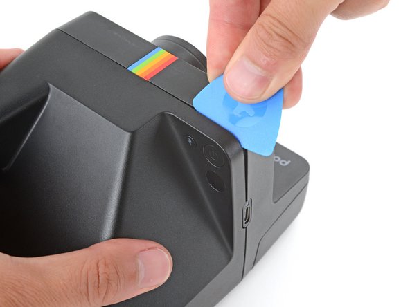

  6. Polaroid Now Gen 3 Rear Shell Replacement: crwdns2935265:06crwdnd2935265:01crwdnd2935265:03crwdne2935265:0 Polaroid Now Gen 3 Rear Shell Replacement: crwdns2935265:06crwdnd2935265:02crwdnd2935265:03crwdne2935265:0 Polaroid Now Gen 3 Rear Shell Replacement: crwdns2935265:06crwdnd2935265:03crwdnd2935265:03crwdne2935265:0
    • Continue sliding your pick along the top edge, around the top left corner, and down the left edge to release the clips. Stop when you get to the film door latch.

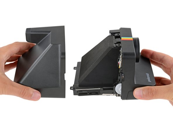

  9. Polaroid Now Gen 3 Rear Shell Replacement, Camera mirror warning: crwdns2935265:09crwdnd2935265:01crwdnd2935265:02crwdne2935265:0 Polaroid Now Gen 3 Rear Shell Replacement, Camera mirror warning: crwdns2935265:09crwdnd2935265:02crwdnd2935265:02crwdne2935265:0
    • Removing the rear shell in the next step exposes the camera mirror. Be careful not to smudge it or get any debris on it. If you accidentally do, use a lint‑free cloth to gently wipe the mirror clean.
  10. Polaroid Now Gen 3 Rear Shell Replacement, Remove the rear shell: crwdns2935265:010crwdnd2935265:01crwdnd2935265:02crwdne2935265:0 Polaroid Now Gen 3 Rear Shell Replacement, Remove the rear shell: crwdns2935265:010crwdnd2935265:02crwdnd2935265:02crwdne2935265:0
    • Gently pull the rear shell off the main body of the camera.
    • The shell should slide off easily. If it doesn't, check to see if any clips re‑engaged and use your opening pick to release them.
    • During reassembly:
    • Press the shell firmly onto the main body so all the clips engage.
    • You should feel and hear distinct "clicks" as the clips engage.
    • Check around the shell seam and make sure there are no gaps. If there are, firmly press the shells together to engage the clip near the gap.

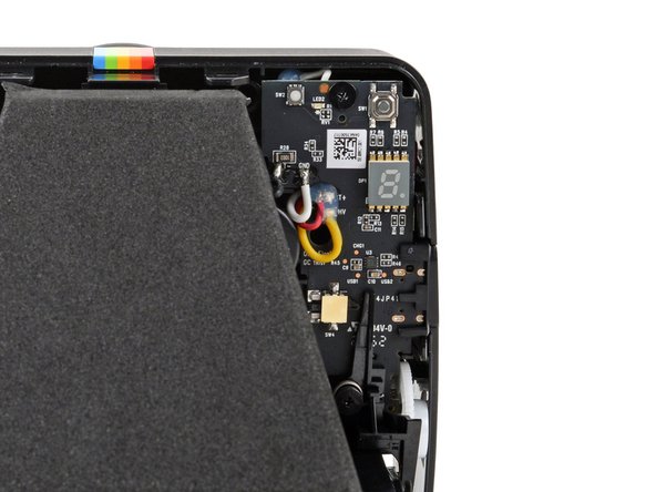

  11. Polaroid Now Gen 3 Rear Shell Replacement, Capacitor warning: crwdns2935265:011crwdnd2935265:01crwdnd2935265:02crwdne2935265:0 Polaroid Now Gen 3 Rear Shell Replacement, Capacitor warning: crwdns2935265:011crwdnd2935265:02crwdnd2935265:02crwdne2935265:0
    • The capacitor in your camera holds an electrical charge and can deliver a potentially dangerous electric shock if you touch the boards incorrectly.
    • To minimize risk, avoid touching the boards, wires, and other exposed components with your fingers or metal tools. Consider wearing rubber gloves if working near the board.
