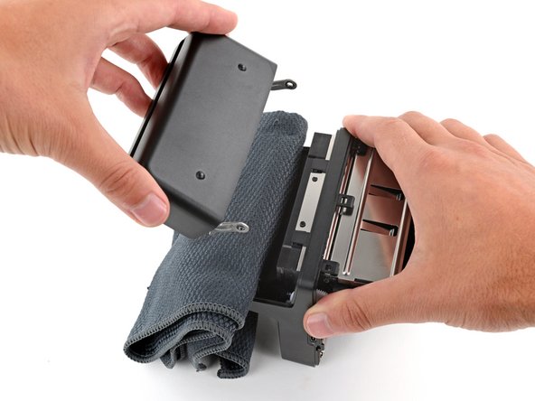

  18. Polaroid Now Gen 3 Front Shell Replacement, Insert a clean cloth: crwdns2935265:018crwdnd2935265:01crwdnd2935265:03crwdne2935265:0 Polaroid Now Gen 3 Front Shell Replacement, Insert a clean cloth: crwdns2935265:018crwdnd2935265:02crwdnd2935265:03crwdne2935265:0 Polaroid Now Gen 3 Front Shell Replacement, Insert a clean cloth: crwdns2935265:018crwdnd2935265:03crwdnd2935265:03crwdne2935265:0
    • Open the film door and place a clean cloth in the compartment.
    • This prevents the door from re‑securing while detaching the hinges.
  19. Polaroid Now Gen 3 Front Shell Replacement, Detach the film door: crwdns2935265:019crwdnd2935265:01crwdnd2935265:03crwdne2935265:0 Polaroid Now Gen 3 Front Shell Replacement, Detach the film door: crwdns2935265:019crwdnd2935265:02crwdnd2935265:03crwdne2935265:0 Polaroid Now Gen 3 Front Shell Replacement, Detach the film door: crwdns2935265:019crwdnd2935265:03crwdnd2935265:03crwdne2935265:0
    • The small, plastic grommets inside the film door hinges can easily fall off during this step. Don't lose them—you'll need them for reassembly.
    • Use the flat end of a spudger to push one of the film door hinges away from the camera and off its post.
    • Repeat the process to detach the other hinge.
    • Hold the film door steady so the already detached hinge doesn't slide back into place.
  20. Polaroid Now Gen 3 Front Shell Replacement: crwdns2935265:020crwdnd2935265:01crwdnd2935265:03crwdne2935265:0 Polaroid Now Gen 3 Front Shell Replacement: crwdns2935265:020crwdnd2935265:02crwdnd2935265:03crwdne2935265:0 Polaroid Now Gen 3 Front Shell Replacement: crwdns2935265:020crwdnd2935265:03crwdnd2935265:03crwdne2935265:0
    • Check to see if either of the small, plastic hinge grommets stayed on their posts.
    • If they did, remove them and set them aside.
  21. Polaroid Now Gen 3 Front Shell Replacement, Remove the film door: crwdns2935265:021crwdnd2935265:01crwdnd2935265:03crwdne2935265:0 Polaroid Now Gen 3 Front Shell Replacement, Remove the film door: crwdns2935265:021crwdnd2935265:02crwdnd2935265:03crwdne2935265:0 Polaroid Now Gen 3 Front Shell Replacement, Remove the film door: crwdns2935265:021crwdnd2935265:03crwdnd2935265:03crwdne2935265:0
    • Lift the film door and remove it.
    • At this point, you can remove the cloth from the film door compartment.
    • During reassembly:
    • Make sure there are grommets installed in the film door hinges. To install them, press the grommets into the film door hinges, with the wide end facing in.
    • Hook one of the hinges on its post and then push the other one into place until it snaps over its post.
