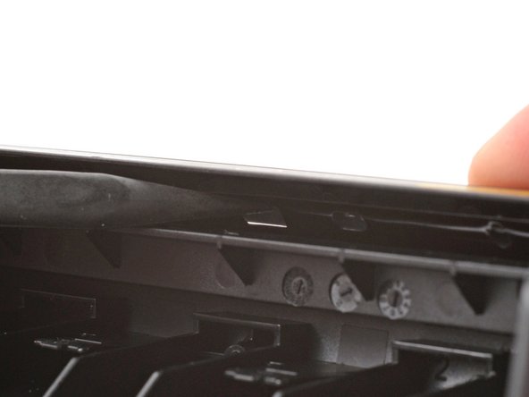

  4. Polaroid Now Gen 3 Film Shield Replacement, Release the rear shell clips: crwdns2935265:04crwdnd2935265:01crwdnd2935265:03crwdne2935265:0 Polaroid Now Gen 3 Film Shield Replacement, Release the rear shell clips: crwdns2935265:04crwdnd2935265:02crwdnd2935265:03crwdne2935265:0 Polaroid Now Gen 3 Film Shield Replacement, Release the rear shell clips: crwdns2935265:04crwdnd2935265:03crwdnd2935265:03crwdne2935265:0
    • Insert the flat edge of an opening pick in the seam between the front and rear shells, just above the USB‑C port on the right edge.
    • Use your pick to pry the rear shell away from the front shell.
    • Keep the inserted edge of the pick pointed toward the rear shell when separating it. This helps release the tight plastic clips holding them together.
  5. Polaroid Now Gen 3 Film Shield Replacement: crwdns2935265:05crwdnd2935265:01crwdnd2935265:03crwdne2935265:0 Polaroid Now Gen 3 Film Shield Replacement: crwdns2935265:05crwdnd2935265:02crwdnd2935265:03crwdne2935265:0 Polaroid Now Gen 3 Film Shield Replacement: crwdns2935265:05crwdnd2935265:03crwdnd2935265:03crwdne2935265:0
    • You should feel and hear distinct "clicks" as the clips release. If you don't, try again—it may take multiple attempts.
    • Slide your pick around the top right corner and along the top edge to release the clips.
