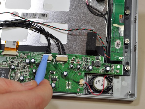

  3. Polaroid LCD-0700P Motherboard Replacement: crwdns2935265:03crwdnd2935265:01crwdnd2935265:01crwdne2935265:0
    • Locate the input/output board on the top left hand corner of the device. It will look like a green circuit board with wires protruding and connecting to the case cover.
    • Using your blue plastic opening tool, disconnect the multicolored wires located on the input/output board. These will be the same multicolored wires that connect the back cover to the input/output board.
  4. Polaroid LCD-0700P Motherboard Replacement, Input/Output Board: crwdns2935265:04crwdnd2935265:01crwdnd2935265:03crwdne2935265:0 Polaroid LCD-0700P Motherboard Replacement, Input/Output Board: crwdns2935265:04crwdnd2935265:02crwdnd2935265:03crwdne2935265:0 Polaroid LCD-0700P Motherboard Replacement, Input/Output Board: crwdns2935265:04crwdnd2935265:03crwdnd2935265:03crwdne2935265:0
    • Use two blue plastic opening tools to remove the three wire connectors on the side of the input/output board.
    • Use a Philips #0 screwdriver to remove the five screws on the board.
    • One of the screws is hidden below the black tape, so gently pull the tape to the side to gain access to it. Be sure to replace the tape when reinstalling the board.
    • Lift board from case.

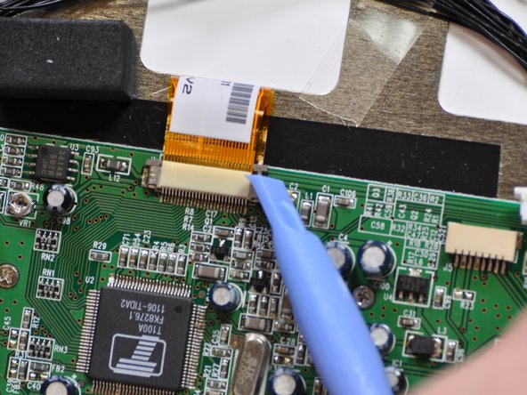

  5. Polaroid LCD-0700P Motherboard Replacement, Motherboard: crwdns2935265:05crwdnd2935265:01crwdnd2935265:03crwdne2935265:0 Polaroid LCD-0700P Motherboard Replacement, Motherboard: crwdns2935265:05crwdnd2935265:02crwdnd2935265:03crwdne2935265:0 Polaroid LCD-0700P Motherboard Replacement, Motherboard: crwdns2935265:05crwdnd2935265:03crwdnd2935265:03crwdne2935265:0
    • Remove the five different connections to this board. Two from the speakers, two from input/output board and the orange ribbon cable.
    • Remove connections from input/output board and speaker with the plastic opening tool.
    • Remove the orange ribbon cable using the plastic opening tool to release the two brown retention tabs.
  6. Polaroid LCD-0700P Motherboard Replacement: crwdns2935265:06crwdnd2935265:01crwdnd2935265:03crwdne2935265:0 Polaroid LCD-0700P Motherboard Replacement: crwdns2935265:06crwdnd2935265:02crwdnd2935265:03crwdne2935265:0 Polaroid LCD-0700P Motherboard Replacement: crwdns2935265:06crwdnd2935265:03crwdnd2935265:03crwdne2935265:0
    • Remove the seven 5mm screws using the Phillips #0 screwdriver.
    • Detach the wire mesh tape connection the logic board to the LCD screen with the sharp end of the spudger.
    • Remove the logic board with your hands.
