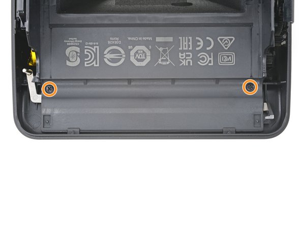

  13. Polaroid I-2 Front Cover Replacement, Unfasten the back cover: crwdns2935265:013crwdnd2935265:01crwdnd2935265:01crwdne2935265:0
    • Use a Phillips screwdriver to remove the two 3.9 mm-long screws securing the back cover.

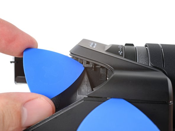

  16. Polaroid I-2 Front Cover Replacement, Insert an opening pick: crwdns2935265:016crwdnd2935265:01crwdnd2935265:03crwdne2935265:0 Polaroid I-2 Front Cover Replacement, Insert an opening pick: crwdns2935265:016crwdnd2935265:02crwdnd2935265:03crwdne2935265:0 Polaroid I-2 Front Cover Replacement, Insert an opening pick: crwdns2935265:016crwdnd2935265:03crwdnd2935265:03crwdne2935265:0
    • Releasing the clips requires getting a tool between the covered "thin" edge of the front cover and the clips themselves.
    • Angle an opening pick upward and insert it at the gap where the bottom right corner of the back cover meets the triangular tip of the front cover’s right edge.
    • Push the pick up to get it above the overhanging lip in the back cover.
    • You'll see the plastic warp a little. This is normal.
    • While pushing upward, slowly rotate the pick towards the left edge of the camera until it's under the front cover.
    • The pick can slip out easily, so this may take a few tries.

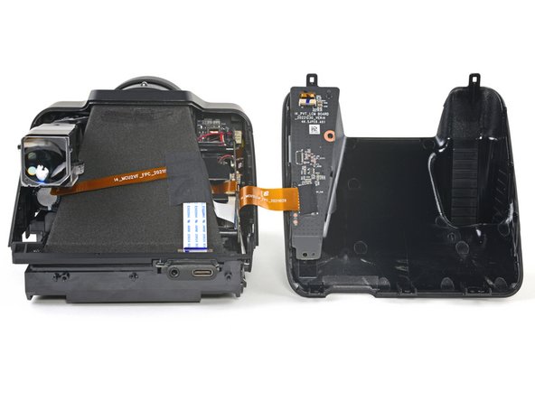

  20. Polaroid I-2 Front Cover Replacement, Reposition the back cover: crwdns2935265:020crwdnd2935265:01crwdnd2935265:03crwdne2935265:0 Polaroid I-2 Front Cover Replacement, Reposition the back cover: crwdns2935265:020crwdnd2935265:02crwdnd2935265:03crwdne2935265:0 Polaroid I-2 Front Cover Replacement, Reposition the back cover: crwdns2935265:020crwdnd2935265:03crwdnd2935265:03crwdne2935265:0
    • Don't try to pull the back cover off just yet, as it's still connected by a cable.
    • At this point, the back cover should feel loose. If any parts still feel connected, repeat the last four steps until all the clips release.
    • Pull the back cover off the camera and rotate it over the right edge to expose the flex cable.
    • During reassembly, make sure the the flex cable isn't caught between the covers before re‑engaging the clips.
  21. Polaroid I-2 Front Cover Replacement, Remove the tape: crwdns2935265:021crwdnd2935265:01crwdnd2935265:03crwdne2935265:0 Polaroid I-2 Front Cover Replacement, Remove the tape: crwdns2935265:021crwdnd2935265:02crwdnd2935265:03crwdne2935265:0 Polaroid I-2 Front Cover Replacement, Remove the tape: crwdns2935265:021crwdnd2935265:03crwdnd2935265:03crwdne2935265:0
    • Use tweezers to peel off the tape covering the interconnect cable ZIF connector on the control board.
    • Set the tape aside. You'll reuse it during reassembly.
  22. Polaroid I-2 Front Cover Replacement, Disconnect the control board: crwdns2935265:022crwdnd2935265:01crwdnd2935265:02crwdne2935265:0 Polaroid I-2 Front Cover Replacement, Disconnect the control board: crwdns2935265:022crwdnd2935265:02crwdnd2935265:02crwdne2935265:0
    • Use the flat end of a spudger to lift up the locking flap on the control board ZIF connector.
  23. Polaroid I-2 Front Cover Replacement: crwdns2935265:023crwdnd2935265:01crwdnd2935265:03crwdne2935265:0 Polaroid I-2 Front Cover Replacement: crwdns2935265:023crwdnd2935265:02crwdnd2935265:03crwdne2935265:0 Polaroid I-2 Front Cover Replacement: crwdns2935265:023crwdnd2935265:03crwdnd2935265:03crwdne2935265:0
    • Use tweezers to pull the interconnect cable out of its slot in the control board.
    • Remove the back cover.

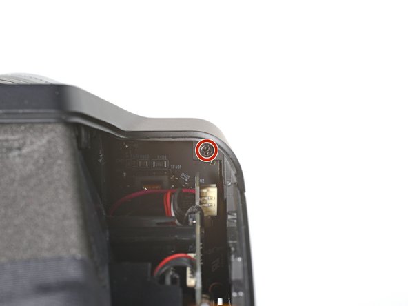

  24. Polaroid I-2 Front Cover Replacement, Unfasten the top cover: crwdns2935265:024crwdnd2935265:01crwdnd2935265:03crwdne2935265:0 Polaroid I-2 Front Cover Replacement, Unfasten the top cover: crwdns2935265:024crwdnd2935265:02crwdnd2935265:03crwdne2935265:0 Polaroid I-2 Front Cover Replacement, Unfasten the top cover: crwdns2935265:024crwdnd2935265:03crwdnd2935265:03crwdne2935265:0
    • Use a Phillips screwdriver to remove the two 3.9 mm-long screws securing the top cover.

    • Remove the front cover.
    • If you're disassembling further, put the lens cover back on to prevent scratching the lens.
    • At this point, the metal film door lever and spring are at risk of falling out. If they do, follow this guide to reinstall them.
Compare your new replacement part to the original part—you may need to transfer remaining components or remove adhesive backings from the new part before you install it.
