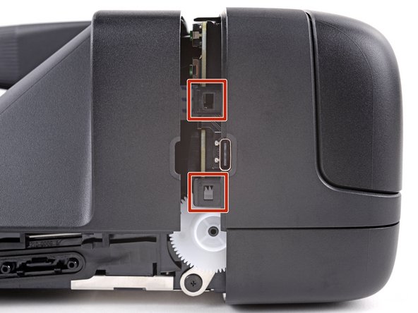

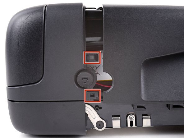

  6. Polaroid Flip Top Shell Replacement, Clip information: crwdns2935265:06crwdnd2935265:01crwdnd2935265:03crwdne2935265:0 Polaroid Flip Top Shell Replacement, Clip information: crwdns2935265:06crwdnd2935265:02crwdnd2935265:03crwdne2935265:0 Polaroid Flip Top Shell Replacement, Clip information: crwdns2935265:06crwdnd2935265:03crwdnd2935265:03crwdne2935265:0
    • Tight plastic clips secure the top shell to the camera. Releasing them can be very tricky and will most likely take a few attempts. Be patient and use these photos as reference for the location of the clips.

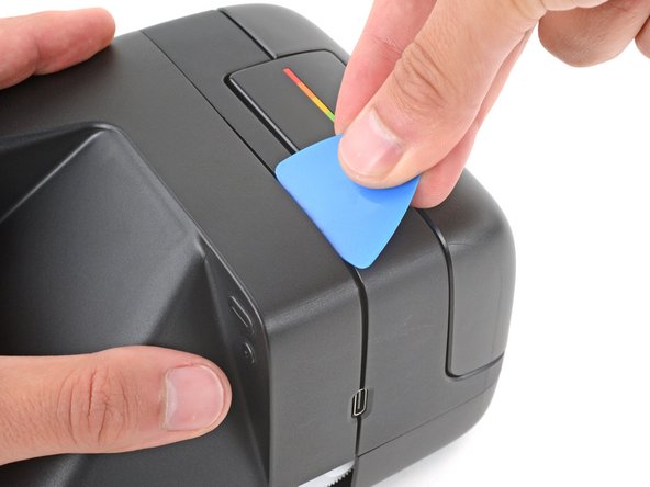

  7. Polaroid Flip Top Shell Replacement, Release the clips: crwdns2935265:07crwdnd2935265:01crwdnd2935265:03crwdne2935265:0 Polaroid Flip Top Shell Replacement, Release the clips: crwdns2935265:07crwdnd2935265:02crwdnd2935265:03crwdne2935265:0 Polaroid Flip Top Shell Replacement, Release the clips: crwdns2935265:07crwdnd2935265:03crwdnd2935265:03crwdne2935265:0

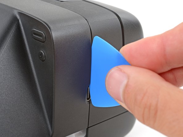

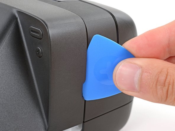

    • Insert the flat edge of an opening pick in the seam between the front and top shells, just above the USB‑C port on the right edge.
    • Use your pick to pry the top shell away from the front shell.
    • Keep the inserted edge of the pick pointed toward the top shell when separating it. This helps release the tight plastic clips holding them together.

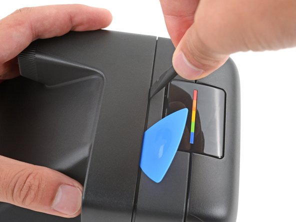

  8. Polaroid Flip Top Shell Replacement: crwdns2935265:08crwdnd2935265:01crwdnd2935265:03crwdne2935265:0 Polaroid Flip Top Shell Replacement: crwdns2935265:08crwdnd2935265:02crwdnd2935265:03crwdne2935265:0 Polaroid Flip Top Shell Replacement: crwdns2935265:08crwdnd2935265:03crwdnd2935265:03crwdne2935265:0

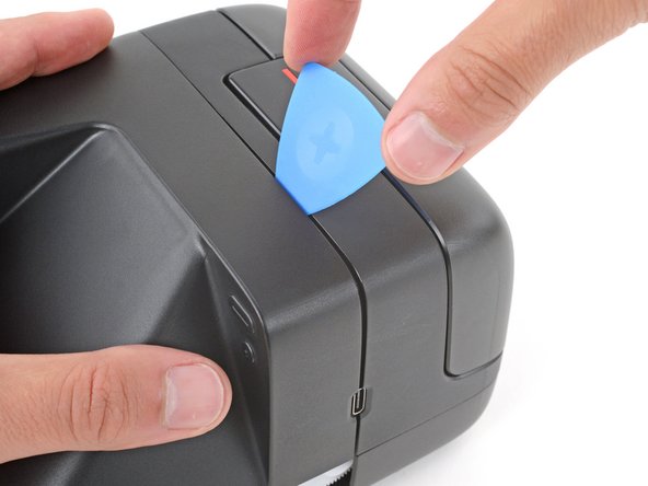

    • Slide your pick around the top right corner to release the clip.
    • You should feel and hear a distinct "click" as the clip releases. If you don't, go back to the previous step and try again—it may take multiple attempts.
    • Rotate your opening pick so the tip is under the top shell (between the two top clips) and leave it inserted to prevent the clip from re‑engaging.
  9. Polaroid Flip Top Shell Replacement: crwdns2935265:09crwdnd2935265:01crwdnd2935265:03crwdne2935265:0 Polaroid Flip Top Shell Replacement: crwdns2935265:09crwdnd2935265:02crwdnd2935265:03crwdne2935265:0 Polaroid Flip Top Shell Replacement: crwdns2935265:09crwdnd2935265:03crwdnd2935265:03crwdne2935265:0
    • Releasing the clip in this step is difficult and will probably take a few tries. Be patient and don't try to force the clip free, or you may damage your camera.
    • If the opening pick falls out, repeat the previous step to re‑insert it. Having it inserted under the shell is necessary to ensure the right‑side clip doesn't re‑engage.

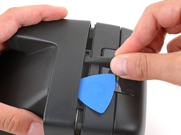

    • Insert the flat end of a spudger into the seam near the center of the camera, just to the left of the opening pick.
    • Slide the spudger along the seam towards the viewfinder until it stops—this means the spudger is in the correct spot against the clip.
    • Push the spudger under the top shell and pry up to release the clip and separate the shells.
    • It shouldn't take much force to release the clip. If the clip isn't releasing, remove the spudger and try again from the beginning of this step.

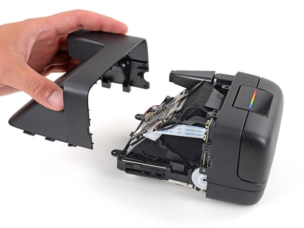

  10. Polaroid Flip Top Shell Replacement, Remove the top shell: crwdns2935265:010crwdnd2935265:01crwdnd2935265:02crwdne2935265:0 Polaroid Flip Top Shell Replacement, Remove the top shell: crwdns2935265:010crwdnd2935265:02crwdnd2935265:02crwdne2935265:0
    • Remove the top shell.
    • During reassembly:
    • Press the shell firmly onto the main body so all the clips engage.
    • You should feel and hear distinct "clicks" as the clips engage.
    • Check around the perimeter of the shell seam and make sure there are no gaps. If there are, firmly press the shells together to engage the clip near the gap.

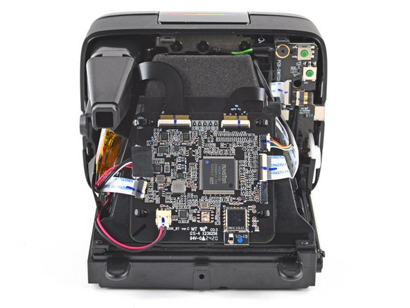

  11. Polaroid Flip Top Shell Replacement, Capacitor information: crwdns2935265:011crwdnd2935265:01crwdnd2935265:02crwdne2935265:0 Polaroid Flip Top Shell Replacement, Capacitor information: crwdns2935265:011crwdnd2935265:02crwdnd2935265:02crwdne2935265:0
    • The capacitor in your camera holds an electrical charge and can deliver a potentially dangerous electric shock if you touch the boards incorrectly.
    • To minimize risk, avoid touching the boards, wires, and other exposed components with your fingers or metal tools. Consider wearing rubber gloves if working near the board.
