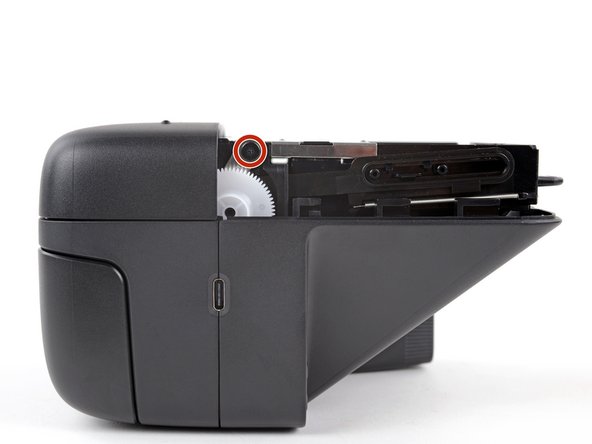

  6. Polaroid Flip Film Door Replacement, Remove the film door screws: crwdns2935265:06crwdnd2935265:01crwdnd2935265:02crwdne2935265:0 Polaroid Flip Film Door Replacement, Remove the film door screws: crwdns2935265:06crwdnd2935265:02crwdnd2935265:02crwdne2935265:0
    • Use a Phillips screwdriver to remove the two 3 mm‑long film door hinge screws (one on either side of the camera).

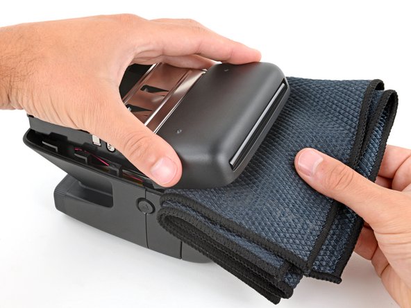

  7. Polaroid Flip Film Door Replacement, Open the film door: crwdns2935265:07crwdnd2935265:01crwdnd2935265:03crwdne2935265:0 Polaroid Flip Film Door Replacement, Open the film door: crwdns2935265:07crwdnd2935265:02crwdnd2935265:03crwdne2935265:0 Polaroid Flip Film Door Replacement, Open the film door: crwdns2935265:07crwdnd2935265:03crwdnd2935265:03crwdne2935265:0
    • Open the film door and place a clean cloth in the compartment.
    • This prevents the door from re‑securing when detaching it.

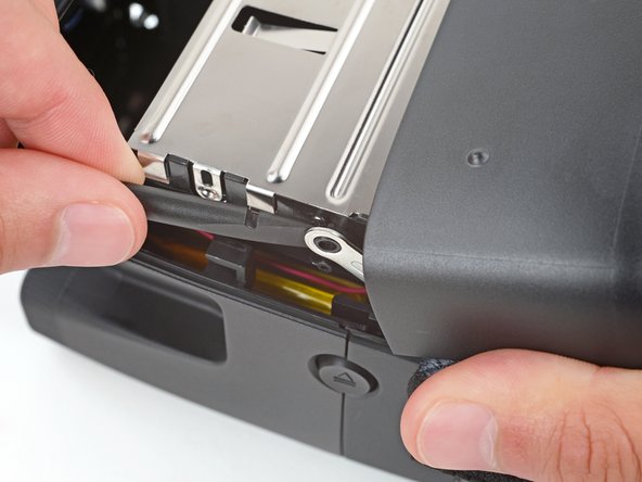

  8. Polaroid Flip Film Door Replacement, Unclip the film door: crwdns2935265:08crwdnd2935265:01crwdnd2935265:03crwdne2935265:0 Polaroid Flip Film Door Replacement, Unclip the film door: crwdns2935265:08crwdnd2935265:02crwdnd2935265:03crwdne2935265:0 Polaroid Flip Film Door Replacement, Unclip the film door: crwdns2935265:08crwdnd2935265:03crwdnd2935265:03crwdne2935265:0

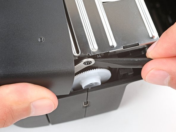

    • The small, plastic grommets inside the film door hinges can easily fall off during this step. Don't lose them—you'll need them for reassembly.
    • Use the flat end of a spudger to push one of the film door hinges away from the camera and off its post.
    • Repeat the process to detach the other hinge.
    • Hold the film door steady so the already detached hinge doesn't slide back into place.
    • Check to see if either of the small, plastic hinge grommets stayed on their posts. If they did, remove them and set them aside.

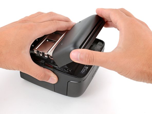

  9. Polaroid Flip Film Door Replacement, Detach the film door: crwdns2935265:09crwdnd2935265:01crwdnd2935265:02crwdne2935265:0 Polaroid Flip Film Door Replacement, Detach the film door: crwdns2935265:09crwdnd2935265:02crwdnd2935265:02crwdne2935265:0
    • Remove the film door.
    • At this point, you can remove the cloth from the film door compartment.

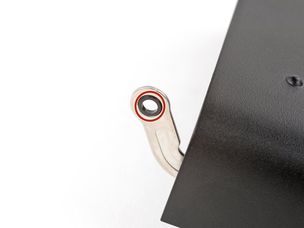

    • During reassembly:
    • Make sure there are grommets installed in the film door hinges. To install them, press the grommets into the film door hinges, with the wide end facing in.
    • Hook one of the hinges on its post and then push the other one into place until it snaps over its post.
