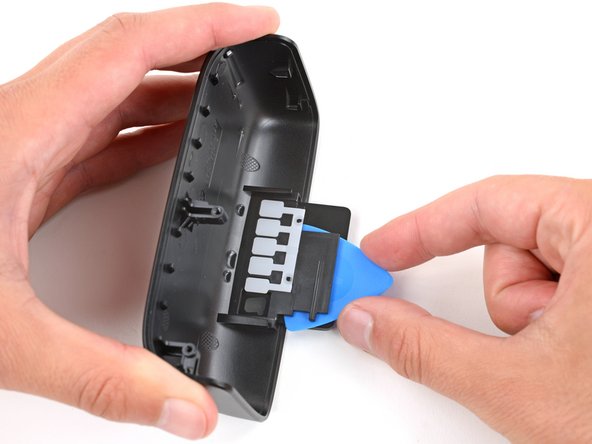

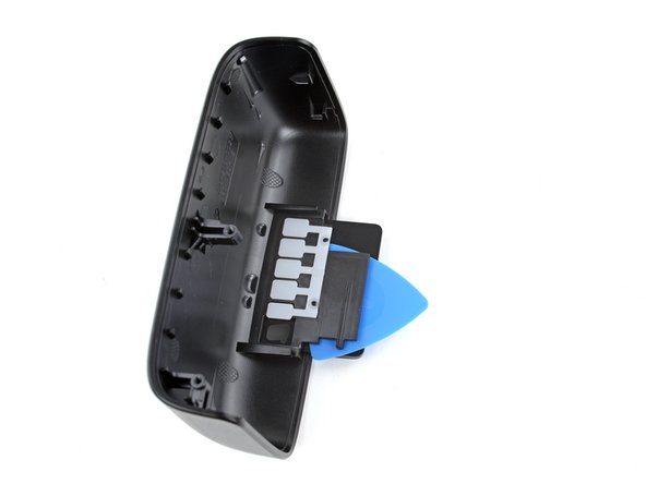

  7. Polaroid Flip Display Cover Replacement, Separate the adhesive: crwdns2935265:07crwdnd2935265:01crwdnd2935265:03crwdne2935265:0 Polaroid Flip Display Cover Replacement, Separate the adhesive: crwdns2935265:07crwdnd2935265:02crwdnd2935265:03crwdne2935265:0 Polaroid Flip Display Cover Replacement, Separate the adhesive: crwdns2935265:07crwdnd2935265:03crwdnd2935265:03crwdne2935265:0
    • With one hand, hold the flip shell so the display cover is facing down.
    • Use your free hand to slide the flat edge of an opening pick under the display cover, separating the adhesive that secures it.
    • Leave the pick inserted for the next step.

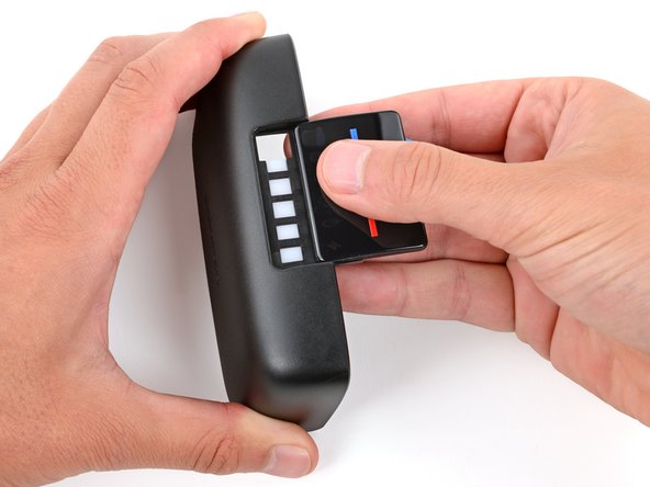

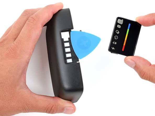

  8. Polaroid Flip Display Cover Replacement, Remove the display cover: crwdns2935265:08crwdnd2935265:01crwdnd2935265:03crwdne2935265:0 Polaroid Flip Display Cover Replacement, Remove the display cover: crwdns2935265:08crwdnd2935265:02crwdnd2935265:03crwdne2935265:0 Polaroid Flip Display Cover Replacement, Remove the display cover: crwdns2935265:08crwdnd2935265:03crwdnd2935265:03crwdne2935265:0
    • Flip the shell over and secure it with one hand.
    • Use your free hand to slide the display cover away from the shell and remove it.
