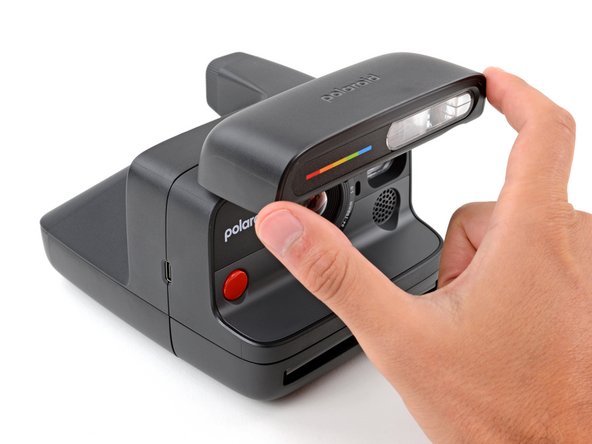

      • If you have any film left, take some photos! Then remove the cartridge. Disassembly will expose any leftover film.
      • Before you begin:
      • Unplug all cables from your camera.
      • Fully close the flash unit at the front of the camera to turn it off.

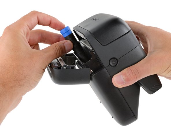

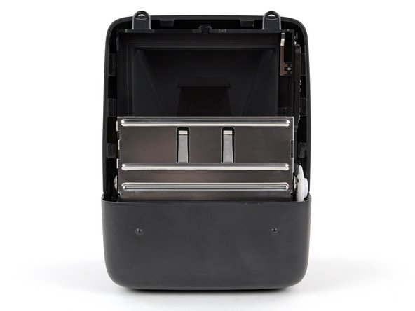

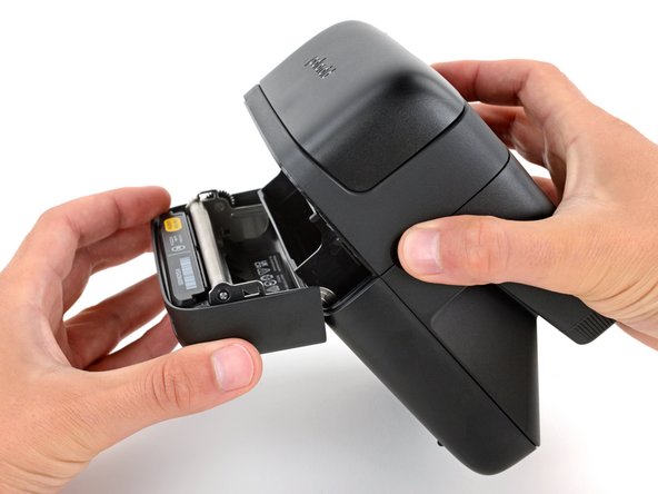

      • Hold down the latch on the left side of the camera and open the film door.

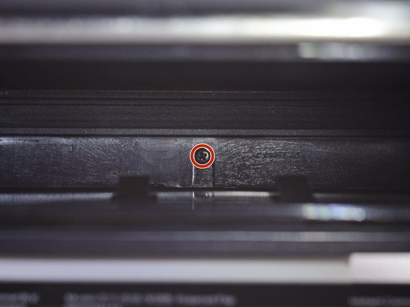

      • Use a Phillips screwdriver to remove the 5.9 mm‑long screw securing the rear shell.
      • The screw is hidden inside the camera on the back edge—you may need to use a flashlight to see it, as well as a skinny, long‑shank screwdriver to reach it.
      • Be careful when removing your screwdriver, as the screw can easily fall inside the camera. If it does, hold the camera above your work surface and gently shake it so the screw falls out.

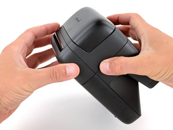

    4. Polaroid Flip Bottom Shell Replacement, Camera mirror warning: crwdns2935265:04crwdnd2935265:01crwdnd2935265:02crwdne2935265:0 Polaroid Flip Bottom Shell Replacement, Camera mirror warning: crwdns2935265:04crwdnd2935265:02crwdnd2935265:02crwdne2935265:0

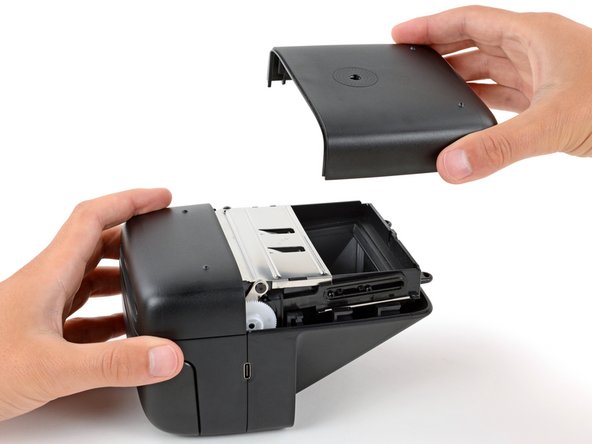

      • Removing the bottom shell in the next step exposes the camera mirror. Be careful not to smudge it or get any debris on it. If you accidentally do, use a lint‑free cloth to gently wipe the mirror clean.

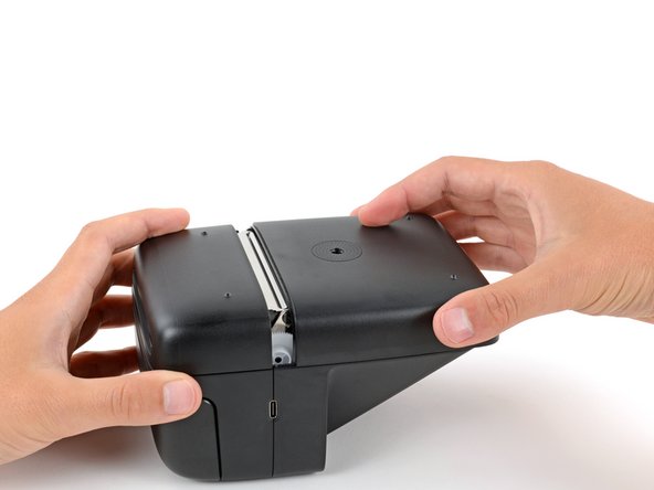

    5. Polaroid Flip Bottom Shell Replacement, Remove the bottom shell: crwdns2935265:05crwdnd2935265:01crwdnd2935265:03crwdne2935265:0 Polaroid Flip Bottom Shell Replacement, Remove the bottom shell: crwdns2935265:05crwdnd2935265:02crwdnd2935265:03crwdne2935265:0 Polaroid Flip Bottom Shell Replacement, Remove the bottom shell: crwdns2935265:05crwdnd2935265:03crwdnd2935265:03crwdne2935265:0
      • Slide the bottom shell towards the back of the camera to release the clips securing it.
      • Lift and remove the shell.
      • During reassembly:
      • Place the shell onto the frame so it hangs over the back about about half an inch (~13 mm), creating a gap near the center of the camera. This allows room for the clips to slide into place.
      • Push down on the shell and slide it towards the front of the camera to engage the clips—you should feel them slide into place.
