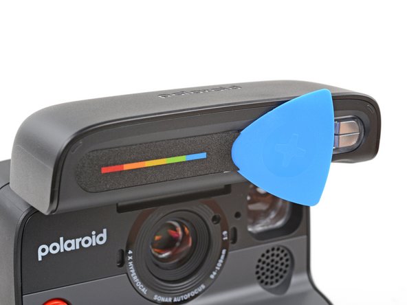

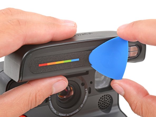

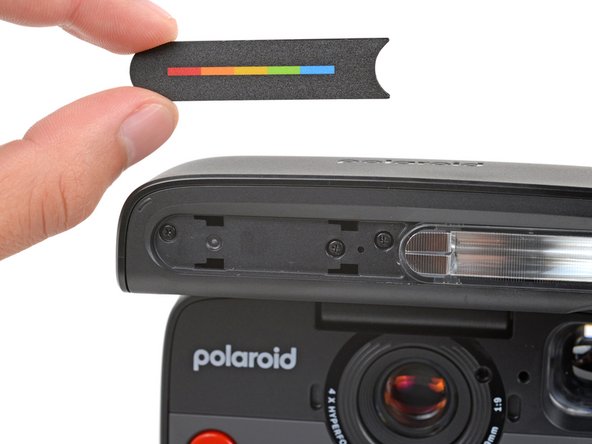

    3. Polaroid Flash Unit Shell Replacement, Remove the screw cover: crwdns2935265:03crwdnd2935265:01crwdnd2935265:03crwdne2935265:0 Polaroid Flash Unit Shell Replacement, Remove the screw cover: crwdns2935265:03crwdnd2935265:02crwdnd2935265:03crwdne2935265:0 Polaroid Flash Unit Shell Replacement, Remove the screw cover: crwdns2935265:03crwdnd2935265:03crwdnd2935265:03crwdne2935265:0
      • Slide the tip of an opening pick under the right edge of the screw cover, near the flash.
      • Leave the pick inserted under the cover for the next step.

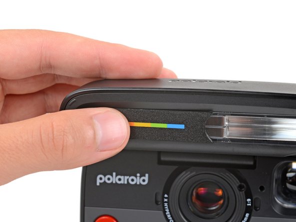

    4. Polaroid Flash Unit Shell Replacement: crwdns2935265:04crwdnd2935265:01crwdnd2935265:03crwdne2935265:0 Polaroid Flash Unit Shell Replacement: crwdns2935265:04crwdnd2935265:02crwdnd2935265:03crwdne2935265:0 Polaroid Flash Unit Shell Replacement: crwdns2935265:04crwdnd2935265:03crwdnd2935265:03crwdne2935265:0
      • Slide the cover towards the flash to release the clips securing it.
      • Your pick might fall out—that's fine.
      • Pull the cover straight away from the camera and remove it.

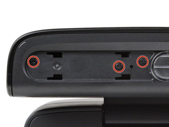

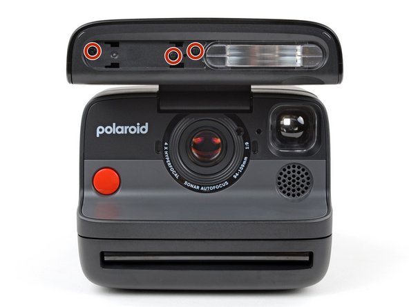

    5. Polaroid Flash Unit Shell Replacement, Remove the flash unit shell screws: crwdns2935265:05crwdnd2935265:01crwdnd2935265:03crwdne2935265:0 Polaroid Flash Unit Shell Replacement, Remove the flash unit shell screws: crwdns2935265:05crwdnd2935265:02crwdnd2935265:03crwdne2935265:0 Polaroid Flash Unit Shell Replacement, Remove the flash unit shell screws: crwdns2935265:05crwdnd2935265:03crwdnd2935265:03crwdne2935265:0
      • Hold the flash unit open with one hand.
      • With your free hand, use a Phillips screwdriver to remove the three 5.9 mm‑long screws securing the flash unit shell.

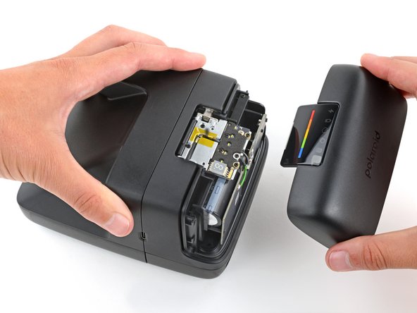

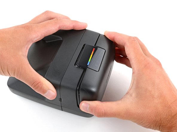

    6. Polaroid Flash Unit Shell Replacement, Remove the flash unit shell: crwdns2935265:06crwdnd2935265:01crwdnd2935265:03crwdne2935265:0 Polaroid Flash Unit Shell Replacement, Remove the flash unit shell: crwdns2935265:06crwdnd2935265:02crwdnd2935265:03crwdne2935265:0 Polaroid Flash Unit Shell Replacement, Remove the flash unit shell: crwdns2935265:06crwdnd2935265:03crwdnd2935265:03crwdne2935265:0
      • Fully close the flash unit for a better grip on the shell.
      • Secure the camera with one hand, and firmly grip the flash unit shell with the other.
      • Lift the right edge of the shell (the side closest to the charging port) to release the clips securing it.
      • You should feel and hear "clicks" as the clips release.
      • Pull the shell up and away from the camera to remove it.
      • During reassembly, put the shell in place and push down firmly to engage the clips.
