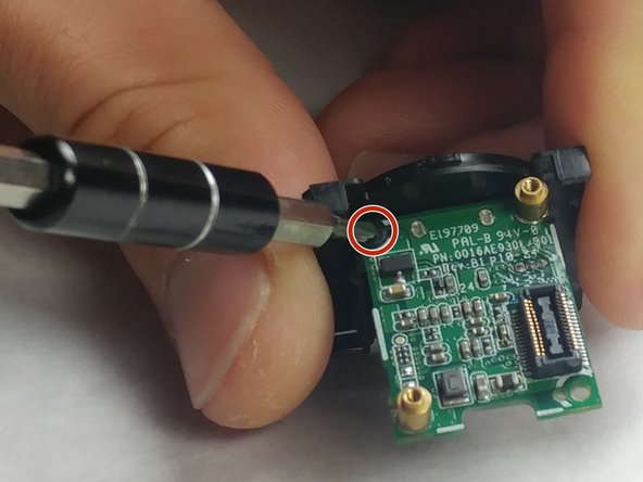

  11. Polaroid Cube Video Quality Switch Replacement, Video Quality Switch: crwdns2935265:011crwdnd2935265:01crwdnd2935265:02crwdne2935265:0 Polaroid Cube Video Quality Switch Replacement, Video Quality Switch: crwdns2935265:011crwdnd2935265:02crwdnd2935265:02crwdne2935265:0
    • Using a J00 head screwdriver, unscrew the 3.46mm screw that connects the top circuit board to the video quality switch board.
  12. Polaroid Cube Video Quality Switch Replacement: crwdns2935265:012crwdnd2935265:01crwdnd2935265:01crwdne2935265:0
    • Remove the circuit board.
  13. Polaroid Cube Video Quality Switch Replacement: crwdns2935265:013crwdnd2935265:01crwdnd2935265:02crwdne2935265:0 Polaroid Cube Video Quality Switch Replacement: crwdns2935265:013crwdnd2935265:02crwdnd2935265:02crwdne2935265:0
    • Using a J00 head screwdriver, unscrew the two 3.46mm screws connecting the video quality switch to the case.
    • Remove and replace the broken video quality switch.
