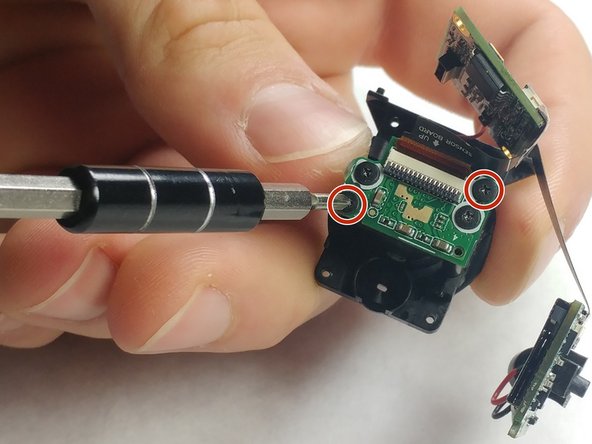

  11. Polaroid Cube Lens Replacement, Lens: crwdns2935265:011crwdnd2935265:01crwdnd2935265:02crwdne2935265:0 Polaroid Cube Lens Replacement, Lens: crwdns2935265:011crwdnd2935265:02crwdnd2935265:02crwdne2935265:0
    • Use a J00 screwdriver to unscrew the two circled 3.5mm Phillips-head screws from the circuit board.

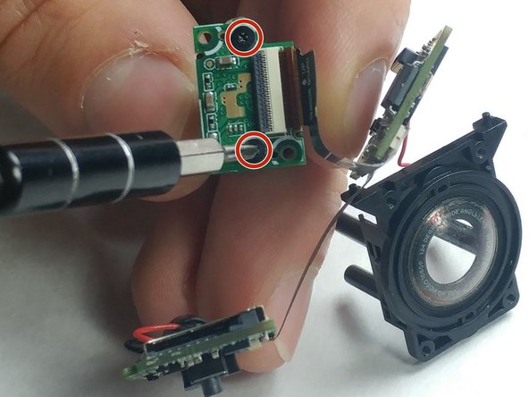

  12. Polaroid Cube Lens Replacement: crwdns2935265:012crwdnd2935265:01crwdnd2935265:02crwdne2935265:0 Polaroid Cube Lens Replacement: crwdns2935265:012crwdnd2935265:02crwdnd2935265:02crwdne2935265:0
    • Use a J00 head screwdriver to unscrew the two 3.5mm screws from the circuit board.
  13. Polaroid Cube Lens Replacement: crwdns2935265:013crwdnd2935265:01crwdnd2935265:01crwdne2935265:0
    • Remove the lens from the unscrewed circuit board and replace the broken lens.
