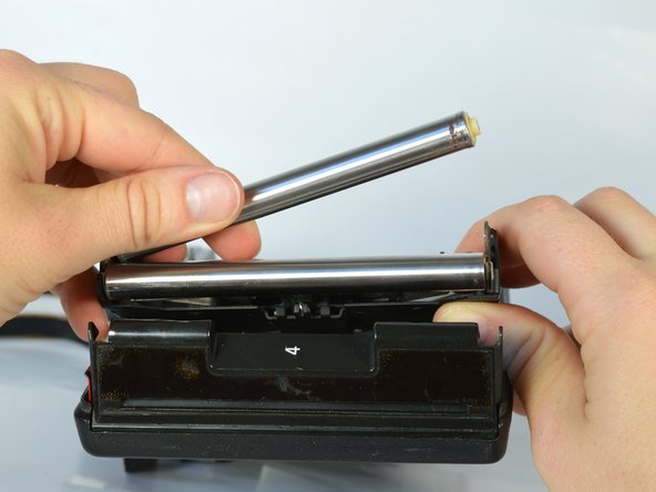

    2. Polaroid Automatic 100 Spread Roll Replacement: crwdns2935265:02crwdnd2935265:01crwdnd2935265:03crwdne2935265:0 Polaroid Automatic 100 Spread Roll Replacement: crwdns2935265:02crwdnd2935265:02crwdnd2935265:03crwdne2935265:0 Polaroid Automatic 100 Spread Roll Replacement: crwdns2935265:02crwdnd2935265:03crwdnd2935265:03crwdne2935265:0
      • Unlatch the red clip on the side.
      • Lift the rollers up.
      • Position the camera with the back cover closest to you.

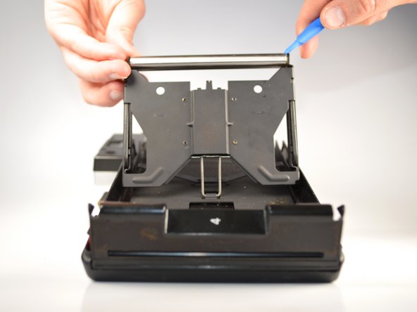

    3. Polaroid Automatic 100 Spread Roll Replacement: crwdns2935265:03crwdnd2935265:01crwdnd2935265:03crwdne2935265:0 Polaroid Automatic 100 Spread Roll Replacement: crwdns2935265:03crwdnd2935265:02crwdnd2935265:03crwdne2935265:0 Polaroid Automatic 100 Spread Roll Replacement: crwdns2935265:03crwdnd2935265:03crwdnd2935265:03crwdne2935265:0
      • Remove the rear roll by using the plastic opening tool to take it off the metal frame.
      • Then remove the front roll by pushing away from you with the plastic opening tool.
