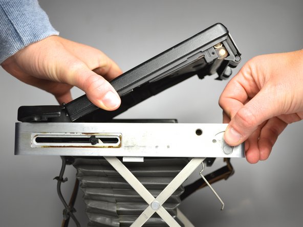

    • Fully extend the bellows by lifting the #1 lever.
    • Remove the camera cover in order to make the camera easier to work with.
    • When collapsing bellows, press down on the metal frame above the bellows.

    • Peel the two battery cable tabs off of the bellows.

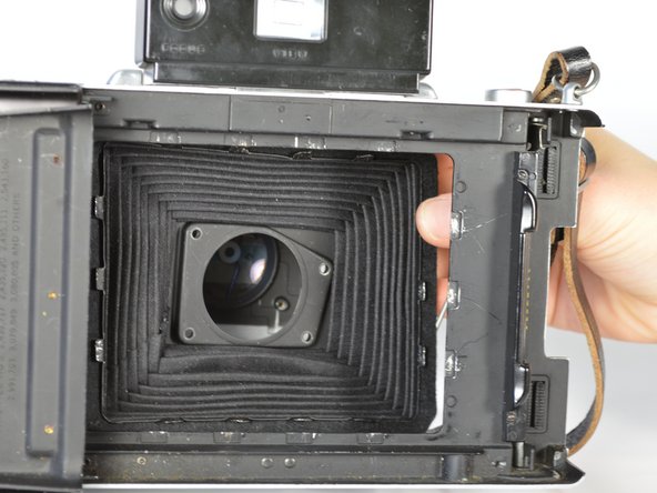

    • Open the back cover by pushing the lever on the bottom towards the left.
  5. Polaroid Automatic 100 Bellows Replacement: crwdns2935265:05crwdnd2935265:01crwdnd2935265:01crwdne2935265:0
    • Remove the four 3 mm screws, which are attached to the lens of the camera, using a Phillips #0 screwdriver.
    • To make the screws easily accessible, close the bellows by pushing on the metal frame.
    • When reassembling, orient the camera so that screws are screwed in downward and stay in place.
  6. Polaroid Automatic 100 Bellows Replacement: crwdns2935265:06crwdnd2935265:01crwdnd2935265:01crwdne2935265:0
    • Carefully use a classic wide metal spudger to bend the tabs of the bellows.
  7. Polaroid Automatic 100 Bellows Replacement: crwdns2935265:07crwdnd2935265:01crwdnd2935265:02crwdne2935265:0 Polaroid Automatic 100 Bellows Replacement: crwdns2935265:07crwdnd2935265:02crwdnd2935265:02crwdne2935265:0
    • Pull the bellow tabs back with long needle nose pliers.
    • Remove the bellows.
