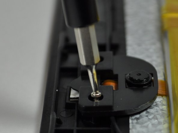

      • Start by locating the two left and right screws which hold the camera head in place.
      • Using the Phillip's 000 screwdriver, remove the two 7 mm screws located in the picture by rotating the screw counter-clockwise.

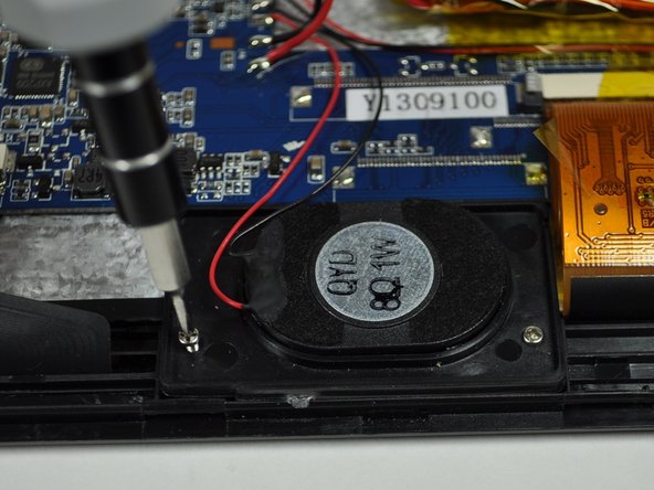

      • Using the Phillips #000 screwdriver, remove the two 7 mm screws located in the picture by rotating the screw counter-clockwise.
      • Carefully remove the speakers from original position without pulling out the wires.

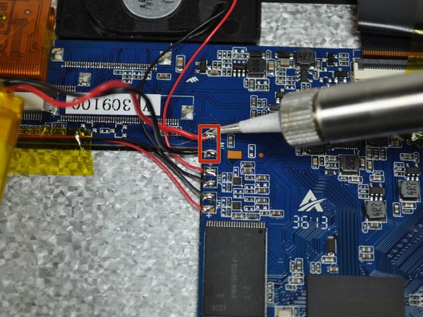

    3. Polaroid A10 LCD Replacement: crwdns2935265:010crwdnd2935265:01crwdnd2935265:01crwdne2935265:0
      • Using the soldering tool, remove the two small black wires and two small red wires from the motherboard.
      • The wire connections are located on the motherboard next to the corner of the battery closest to the motherboard.
      • Removal and installation of wires requires soldering. Here's a helpful link to assist you with great soldering techniques.

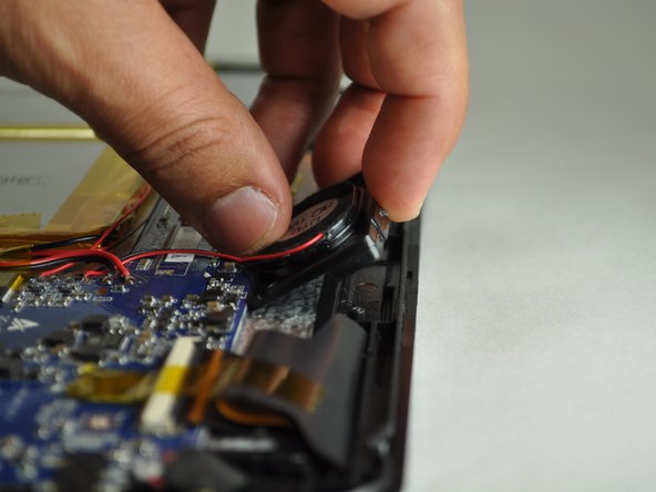

      • Gently lift the speakers up and out of the device.

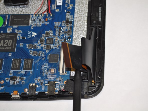

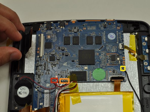

      • Take off yellow tapes that are surrounding the motherboard.
      • Use the plastic opening tools to disconnect the three ribbon cables: battery, screen, and volume/power buttons.

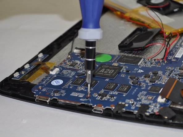

    2. Polaroid A10 LCD Replacement: crwdns2935265:013crwdnd2935265:01crwdnd2935265:03crwdne2935265:0 Polaroid A10 LCD Replacement: crwdns2935265:013crwdnd2935265:02crwdnd2935265:03crwdne2935265:0 Polaroid A10 LCD Replacement: crwdns2935265:013crwdnd2935265:03crwdnd2935265:03crwdne2935265:0

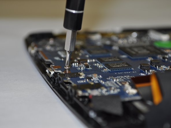

      • Using the Phillips #000 screwdriver, remove the four 5 mm screws located in the picture by rotating the screw counter-clockwise.

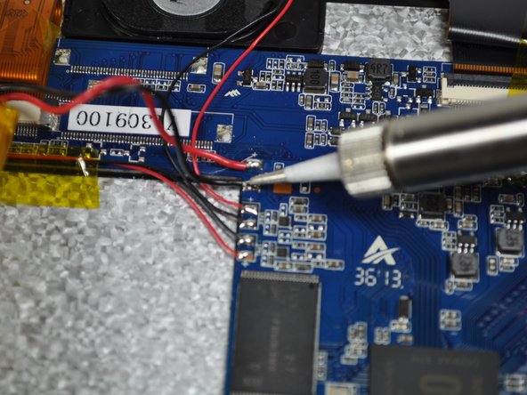

      • Use the soldering tool to unsolder the two bigger metals from the wires of the battery.
      • Use the same soldering tool to unsolder the four smaller metals from the wires of the speakers.
      • Use the same soldering tool to unsolder the ground wire.

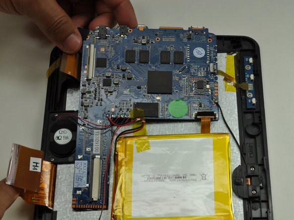

    4. Polaroid A10 LCD Replacement: crwdns2935265:015crwdnd2935265:01crwdnd2935265:03crwdne2935265:0 Polaroid A10 LCD Replacement: crwdns2935265:015crwdnd2935265:02crwdnd2935265:03crwdne2935265:0 Polaroid A10 LCD Replacement: crwdns2935265:015crwdnd2935265:03crwdnd2935265:03crwdne2935265:0
      • Gently lift the motherboard up and out of the device.

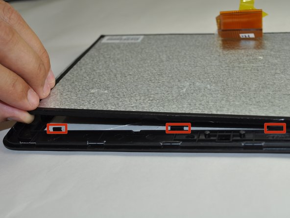

      • Hold the outer plastic rim (the black plastic that holds the LCD display in place), as shown in the first picture.
      • Use your hand that is holding the device and start by pushing the glass screen upwards from the back with your fingers while pulling the outer plastic rim downwards from the display with your thumb.
      • Using your free hand, use the flat end of the spudger to pry apart the clips holding the LCD screen in place.
      • To release the clips, maintain continuous pressure on the display by gradually holding up the display.

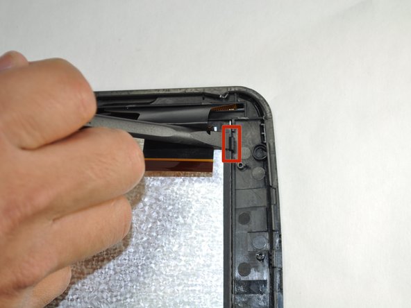

    3. Polaroid A10 LCD Replacement, Screen Is Now Disconnected: crwdns2935265:018crwdnd2935265:01crwdnd2935265:01crwdne2935265:0
      • Gently separate the LCD panel from the digitizer.
