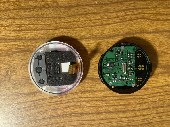

    3. Pokewalker Disassembly, Remove internal cover: crwdns2935265:03crwdnd2935265:01crwdnd2935265:02crwdne2935265:0 Pokewalker Disassembly, Remove internal cover: crwdns2935265:03crwdnd2935265:02crwdnd2935265:02crwdne2935265:0
      • There is a second cover protecting the motherboard. At this point we will remove it. Please take this step with extra caution as there is a ribbon cable beneath it.
      • Please grab your Tri-Wing Y0 screwdriver, and remove the 4 screws on this cover.
      • Shown in Image 2 - Once the screws are removed, please set your screws aside for organization. Once the screws are put aside, please gently lift away the internal cover as to not damage the ribbon cable. Try not to set it down unless something can prop it up.

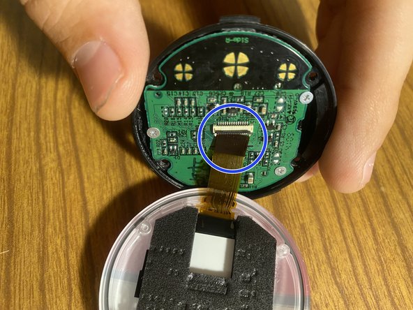

    4. Pokewalker Disassembly, Disconnect the screen: crwdns2935265:04crwdnd2935265:01crwdnd2935265:03crwdne2935265:0 Pokewalker Disassembly, Disconnect the screen: crwdns2935265:04crwdnd2935265:02crwdnd2935265:03crwdne2935265:0 Pokewalker Disassembly, Disconnect the screen: crwdns2935265:04crwdnd2935265:03crwdnd2935265:03crwdne2935265:0
      • We will now gently disconnect the "Pokéwalker" screen.
      • With a Spudger or your fingernail, please carefully lift the flap, thereby releasing the ribbon cable (shown in image 2).
      • Once you gently complete this task, please gently pull the ribbon cable away.

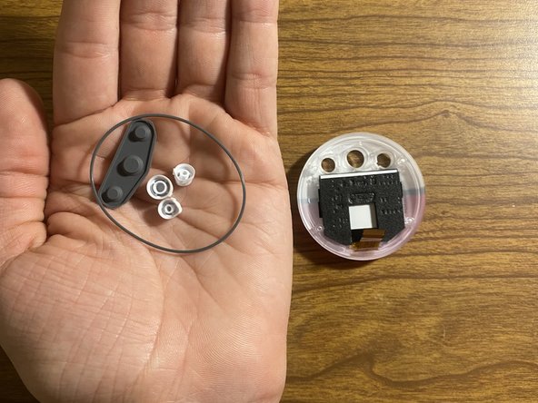

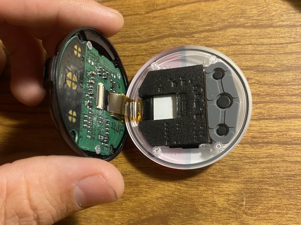

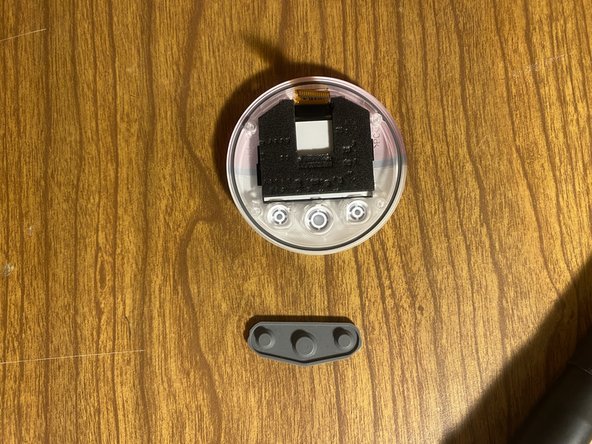

    5. Pokewalker Disassembly, Removing parts from the screen: crwdns2935265:05crwdnd2935265:01crwdnd2935265:03crwdne2935265:0 Pokewalker Disassembly, Removing parts from the screen: crwdns2935265:05crwdnd2935265:02crwdnd2935265:03crwdne2935265:0 Pokewalker Disassembly, Removing parts from the screen: crwdns2935265:05crwdnd2935265:03crwdnd2935265:03crwdne2935265:0
      • Before we continue disassembling the main unit, we will remove the parts that come with the screen.
      • Gently pull away the contacts for the "Pokéwalker" buttons (Image 2).
      • Then, place your hand over the ribbon cable side and turn over the screen to collect the rubber band, and buttons, while also avoiding the mess (results in image 3).
      • This will complete the removal of parts in the screen. Please set these pieces aside.

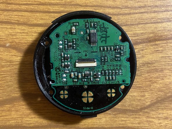

    6. Pokewalker Disassembly, Removing the motherboard: crwdns2935265:06crwdnd2935265:01crwdnd2935265:02crwdne2935265:0 Pokewalker Disassembly, Removing the motherboard: crwdns2935265:06crwdnd2935265:02crwdnd2935265:02crwdne2935265:0
      • Next, we will remove the "Pokéwalker" motherboard.
      • Please grab your PH000 screwdriver, and remove the 3 screws located on the board.
      • Once these screws are removed, set them aside and we will move on.

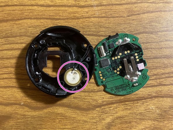

    7. Pokewalker Disassembly, Lift the motherboard away: crwdns2935265:07crwdnd2935265:01crwdnd2935265:02crwdne2935265:0 Pokewalker Disassembly, Lift the motherboard away: crwdns2935265:07crwdnd2935265:02crwdnd2935265:02crwdne2935265:0
      • Finally we will lift the motherboard away from the casing. Please do this gently.
      • As we can see in Image 2, the "Pokéwalker" speaker appears to be attached to the internal casing. It could be separated from the motherboard with soldering, but this unnecessary for this disassembly.
      • Congratulations! You have successfully disassembled a "Pokéwalker"!
