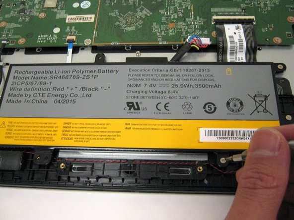

    4. Poin2 Chromebook 11 Touchpad Replacement: crwdns2935265:04crwdnd2935265:01crwdnd2935265:02crwdne2935265:0 Poin2 Chromebook 11 Touchpad Replacement: crwdns2935265:04crwdnd2935265:02crwdnd2935265:02crwdne2935265:0
      • Remove the six 4mm screws using a Phillips #0 screwdriver.
    5. Poin2 Chromebook 11 Touchpad Replacement: crwdns2935265:05crwdnd2935265:01crwdnd2935265:01crwdne2935265:0
      • Lift the battery from the frame.

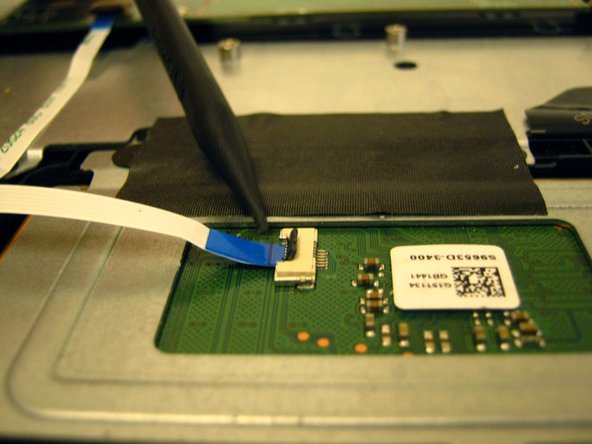

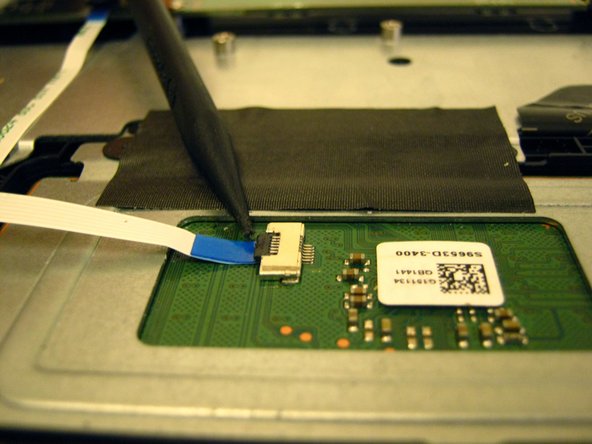

    1. Poin2 Chromebook 11 Touchpad Replacement, Touchpad: crwdns2935265:06crwdnd2935265:01crwdnd2935265:03crwdne2935265:0 Poin2 Chromebook 11 Touchpad Replacement, Touchpad: crwdns2935265:06crwdnd2935265:02crwdnd2935265:03crwdne2935265:0 Poin2 Chromebook 11 Touchpad Replacement, Touchpad: crwdns2935265:06crwdnd2935265:03crwdnd2935265:03crwdne2935265:0
      • Locate the ZIF connector on the touchpad's circuit board.
      • Use the tip of the spudger to flip the locking flap to the perpendicular position and pull the cable out.
      • See also the Connectors Guide for detailed instructions, as well as iFixit's cable connectors guide.

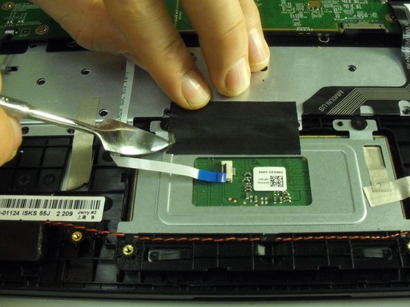

    2. Poin2 Chromebook 11 Touchpad Replacement: crwdns2935265:07crwdnd2935265:01crwdnd2935265:03crwdne2935265:0 Poin2 Chromebook 11 Touchpad Replacement: crwdns2935265:07crwdnd2935265:02crwdnd2935265:03crwdne2935265:0 Poin2 Chromebook 11 Touchpad Replacement: crwdns2935265:07crwdnd2935265:03crwdnd2935265:03crwdne2935265:0
      • Remove the black tape holding down the touchpad.
      • Remove the strips of gold electrostatic tape also holding down the touchpad.
      • Use a metal spudger or tweezers to help pry up the corners of the tape, but be careful not to use to much force or risk damaging the heat sink.
      • Applying new tape is suggested, but the tape can be re-used.

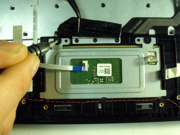

    3. Poin2 Chromebook 11 Touchpad Replacement: crwdns2935265:08crwdnd2935265:01crwdnd2935265:02crwdne2935265:0 Poin2 Chromebook 11 Touchpad Replacement: crwdns2935265:08crwdnd2935265:02crwdnd2935265:02crwdne2935265:0
      • Use a Phillips #00 screwdriver to remove the two 2 mm screws securing the metal plate that holds the touchpad in place
    4. Poin2 Chromebook 11 Touchpad Replacement: crwdns2935265:09crwdnd2935265:01crwdnd2935265:01crwdne2935265:0
      • Slide the touchpad plate in the direction of the screw holes to free the plates bottom edge from under the plastic frame.

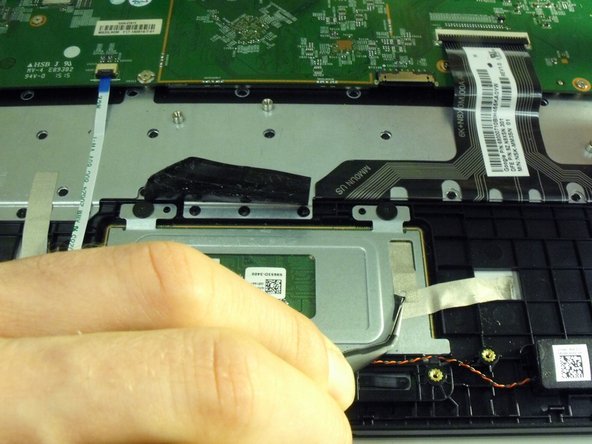

    5. Poin2 Chromebook 11 Touchpad Replacement: crwdns2935265:010crwdnd2935265:01crwdnd2935265:01crwdne2935265:0
      • Remove touchpad from the opposite side of the metal plate.
