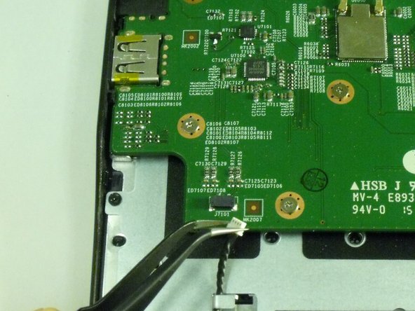

  6. Poin2 Chromebook 11 Speaker Replacement, Speakers: crwdns2935265:06crwdnd2935265:01crwdnd2935265:02crwdne2935265:0 Poin2 Chromebook 11 Speaker Replacement, Speakers: crwdns2935265:06crwdnd2935265:02crwdnd2935265:02crwdne2935265:0
    • Unplug the black speaker cable from the lower, left side of the motherboard.

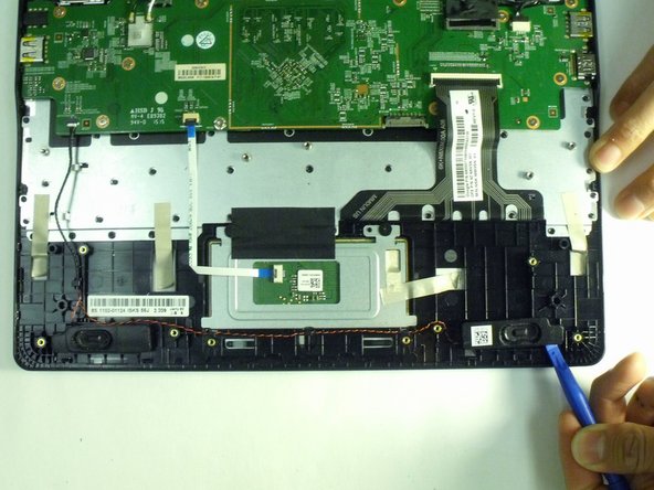

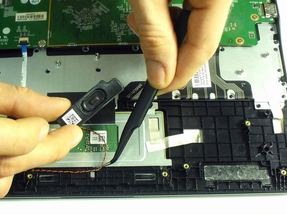

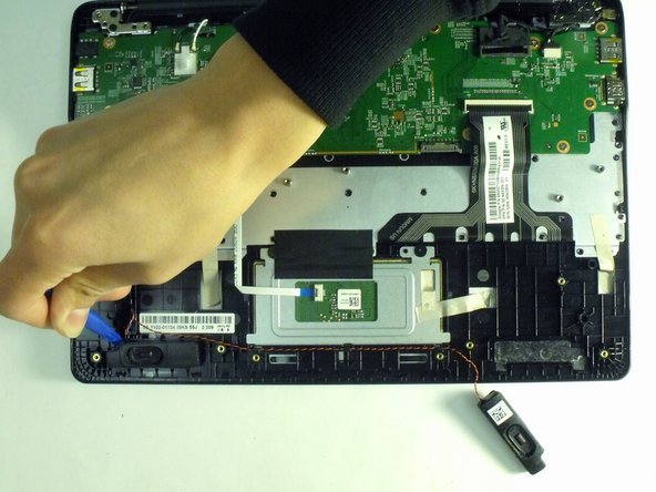

  7. Poin2 Chromebook 11 Speaker Replacement: crwdns2935265:07crwdnd2935265:01crwdnd2935265:03crwdne2935265:0 Poin2 Chromebook 11 Speaker Replacement: crwdns2935265:07crwdnd2935265:02crwdnd2935265:03crwdne2935265:0 Poin2 Chromebook 11 Speaker Replacement: crwdns2935265:07crwdnd2935265:03crwdnd2935265:03crwdne2935265:0
    • Use the opening tool to pry the two speakers away from the frame.
    • An adhesive strip attaches each speaker to the frame. The speakers should pull away with moderate force.
  8. Poin2 Chromebook 11 Speaker Replacement: crwdns2935265:08crwdnd2935265:01crwdnd2935265:02crwdne2935265:0 Poin2 Chromebook 11 Speaker Replacement: crwdns2935265:08crwdnd2935265:02crwdnd2935265:02crwdne2935265:0
    • Detach the speaker cord from the hooks holding it to the frame and lift the speakers away.
