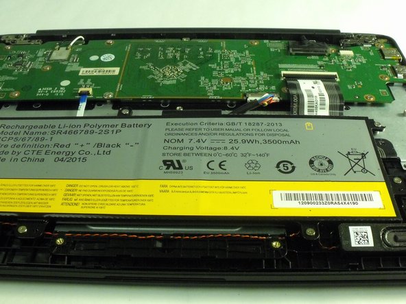

    • Power down the Poin2 Chrombook 11 and disconnect the power adapter.
    • Close the Chromebook and position it with the base facing up.
    • Use a #0 Phillips screwdriver to unscrew the ten 7mm screws that hold the base to the rest of the frame
    • Poin2 Chromebook 11 does not have screws under its rubber feet at the base.
  2. Poin2 Chromebook 11 Motherboard Replacement: crwdns2935265:02crwdnd2935265:01crwdnd2935265:03crwdne2935265:0 Poin2 Chromebook 11 Motherboard Replacement: crwdns2935265:02crwdnd2935265:02crwdnd2935265:03crwdne2935265:0 Poin2 Chromebook 11 Motherboard Replacement: crwdns2935265:02crwdnd2935265:03crwdnd2935265:03crwdne2935265:0
    • Insert a 1cm-wide plastic opening tool between the base and top frame.
    • Applying pressure up and down with the tool may be necessary. When you hear a "click," this indicates the separation of the frame.
    • Pry (up and down) around the entire border of the Chromebook to separate.
    • Use your hands to gently lift the base away from the frame.
  3. Poin2 Chromebook 11 Motherboard Replacement: crwdns2935265:03crwdnd2935265:01crwdnd2935265:03crwdne2935265:0 Poin2 Chromebook 11 Motherboard Replacement: crwdns2935265:03crwdnd2935265:02crwdnd2935265:03crwdne2935265:0 Poin2 Chromebook 11 Motherboard Replacement: crwdns2935265:03crwdnd2935265:03crwdnd2935265:03crwdne2935265:0

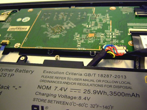

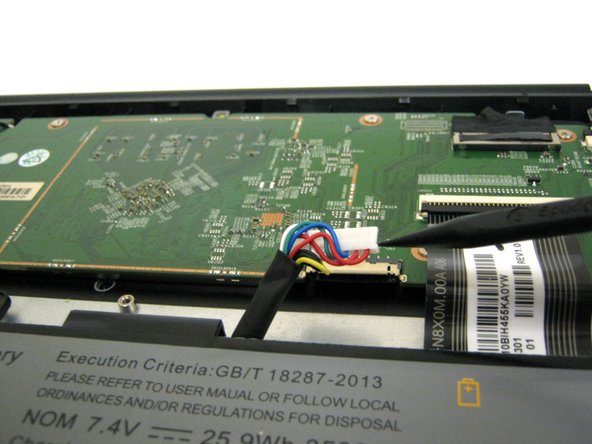

    • Unplug the white 8-wire battery connector using a spudger to push the two L-shaped clips out of the socket.
    • The connector is a tight fit and requires careful pressure for release.

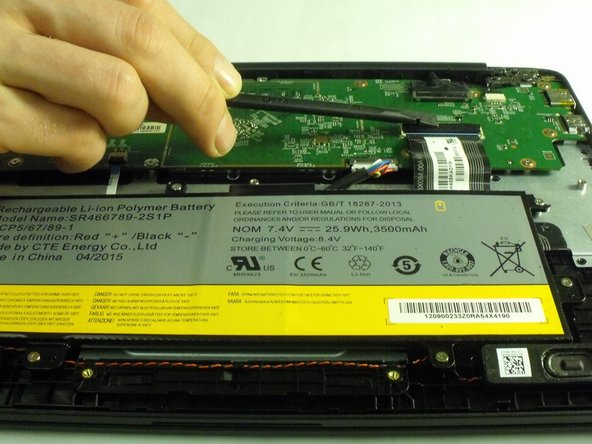

  4. Poin2 Chromebook 11 Motherboard Replacement: crwdns2935265:04crwdnd2935265:01crwdnd2935265:03crwdne2935265:0 Poin2 Chromebook 11 Motherboard Replacement: crwdns2935265:04crwdnd2935265:02crwdnd2935265:03crwdne2935265:0 Poin2 Chromebook 11 Motherboard Replacement: crwdns2935265:04crwdnd2935265:03crwdnd2935265:03crwdne2935265:0
    • Use a spudger (or fingertips) to flip up the plastic clamps that hold down the two ribbon cables connected to the motherboard.
    • Pull the cables from their sockets.

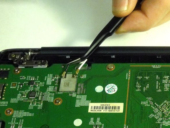

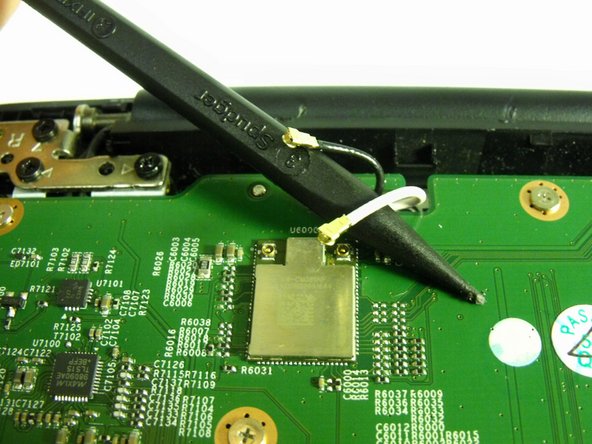

    • Disconnect the coaxial connectors from the motherboard using tweezers (or a spudger) to "snap" off the connectors from their sockets.
    • To reinstall, hold the connectors in place and gently press them straight down. The connectors will “snap” back in place.

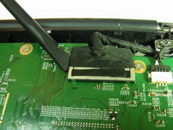

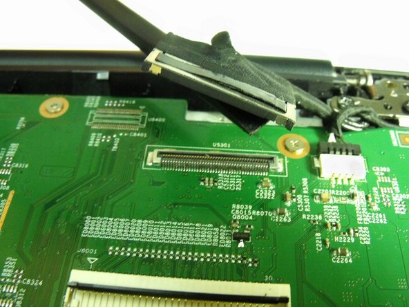

    • Disconnect the LCD screen connector from the motherboard using a spudger.
