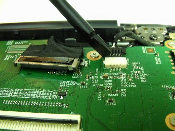

  6. Poin2 Chromebook 11 Charging Port Replacement, Charging Port: crwdns2935265:06crwdnd2935265:01crwdnd2935265:02crwdne2935265:0 Poin2 Chromebook 11 Charging Port Replacement, Charging Port: crwdns2935265:06crwdnd2935265:02crwdnd2935265:02crwdne2935265:0
    • The changing port is located on the upper-right corner of the computer.
    • Disconnect the charging port from the motherboard using a spudger to push the 4-wire connector out from the port.

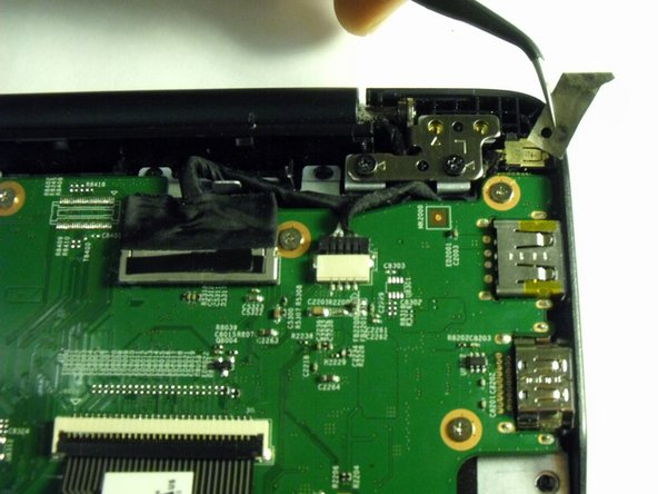

  7. Poin2 Chromebook 11 Charging Port Replacement: crwdns2935265:07crwdnd2935265:01crwdnd2935265:02crwdne2935265:0 Poin2 Chromebook 11 Charging Port Replacement: crwdns2935265:07crwdnd2935265:02crwdnd2935265:02crwdne2935265:0
    • Remove silver tape covering hinge.

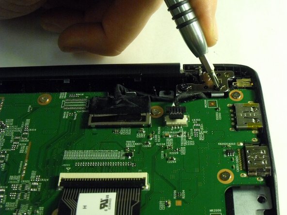

  8. Poin2 Chromebook 11 Charging Port Replacement: crwdns2935265:08crwdnd2935265:01crwdnd2935265:02crwdne2935265:0 Poin2 Chromebook 11 Charging Port Replacement: crwdns2935265:08crwdnd2935265:02crwdnd2935265:02crwdne2935265:0
    • The metal hinge at the top right corner must be lifted to access the charging port.
    • Use a Phillips #0 screwdriver and remove the two 7mm screws from the hinge.

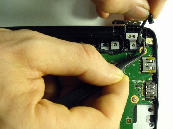

  9. Poin2 Chromebook 11 Charging Port Replacement: crwdns2935265:09crwdnd2935265:01crwdnd2935265:01crwdne2935265:0
    • Pry the metal hinge up, until it sits perpendicular to the motherboard.
    • The metal hinge is a tight fit and requires careful strength when lifting.
  10. Poin2 Chromebook 11 Charging Port Replacement: crwdns2935265:010crwdnd2935265:01crwdnd2935265:02crwdne2935265:0 Poin2 Chromebook 11 Charging Port Replacement: crwdns2935265:010crwdnd2935265:02crwdnd2935265:02crwdne2935265:0
    • Use tweezers to gently pull the charging port out of the frame.
