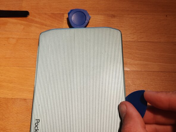

  1. PocketBook Verse PB629 Screen Replacement, Remove back cover: crwdns2935265:01crwdnd2935265:01crwdnd2935265:02crwdne2935265:0 PocketBook Verse PB629 Screen Replacement, Remove back cover: crwdns2935265:01crwdnd2935265:02crwdnd2935265:02crwdne2935265:0
    • Pry open with picks or plastic cards.
    • Some force is need. Try pulling outwards to unleash the hooks. Start on one side and work your way around leaving picks in.

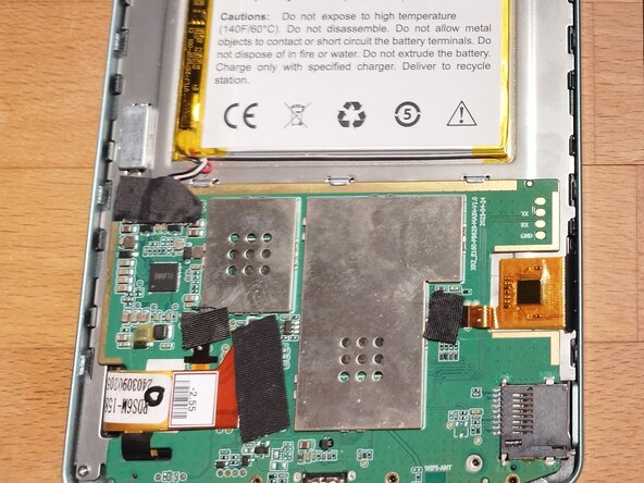

  2. PocketBook Verse PB629 Screen Replacement, Romove connectors covers: crwdns2935265:02crwdnd2935265:01crwdnd2935265:02crwdne2935265:0 PocketBook Verse PB629 Screen Replacement, Romove connectors covers: crwdns2935265:02crwdnd2935265:02crwdnd2935265:02crwdne2935265:0
    • Remove all covers of the connectors.
  3. PocketBook Verse PB629 Screen Replacement, Remove battery connector: crwdns2935265:03crwdnd2935265:01crwdnd2935265:03crwdne2935265:0 PocketBook Verse PB629 Screen Replacement, Remove battery connector: crwdns2935265:03crwdnd2935265:02crwdnd2935265:03crwdne2935265:0 PocketBook Verse PB629 Screen Replacement, Remove battery connector: crwdns2935265:03crwdnd2935265:03crwdnd2935265:03crwdne2935265:0
    • Lift up the connector from the top.
