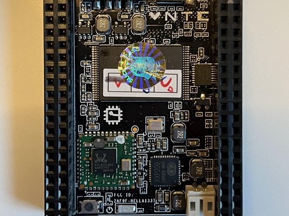

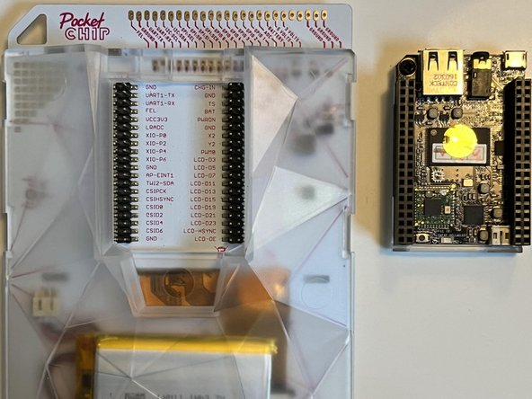

  3. Pocket C.H.I.P. Teardown, Yummy Chips: crwdns2935265:03crwdnd2935265:01crwdnd2935265:02crwdne2935265:0 Pocket C.H.I.P. Teardown, Yummy Chips: crwdns2935265:03crwdnd2935265:02crwdnd2935265:02crwdne2935265:0
    • This is the main CHIP computer.
    • To access the rest of the computer, you need to remove the cover with a single Philips screw.

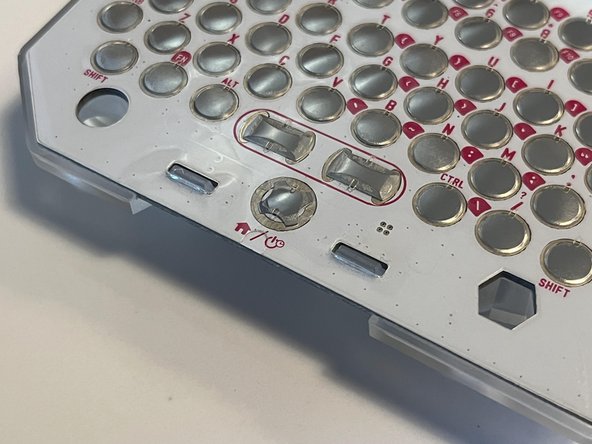

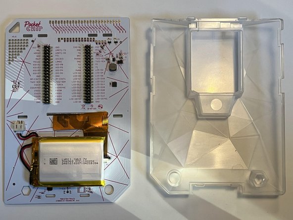

  4. Pocket C.H.I.P. Teardown, Remove the back: crwdns2935265:04crwdnd2935265:01crwdnd2935265:03crwdne2935265:0 Pocket C.H.I.P. Teardown, Remove the back: crwdns2935265:04crwdnd2935265:02crwdnd2935265:03crwdne2935265:0 Pocket C.H.I.P. Teardown, Remove the back: crwdns2935265:04crwdnd2935265:03crwdnd2935265:03crwdne2935265:0
    • Remove the clear back cover
    • There are four clips, two on the top, two on the bottom that should be unclipped to remove it.

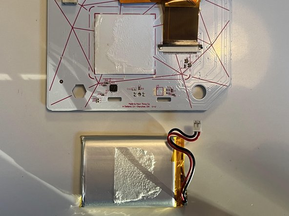

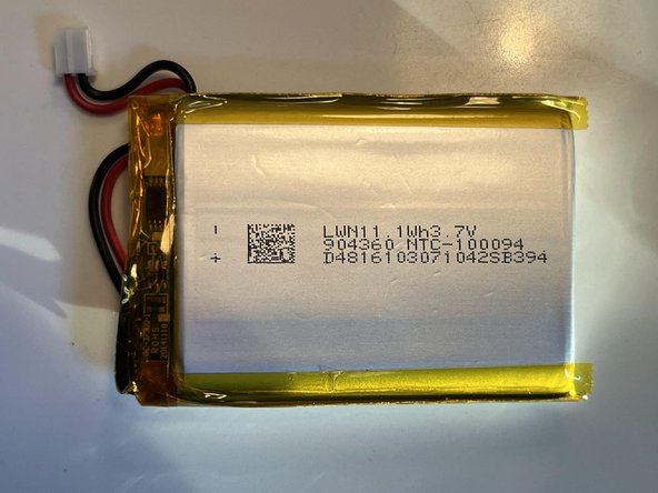

  5. Pocket C.H.I.P. Teardown, Remove the battery: crwdns2935265:05crwdnd2935265:01crwdnd2935265:03crwdne2935265:0 Pocket C.H.I.P. Teardown, Remove the battery: crwdns2935265:05crwdnd2935265:02crwdnd2935265:03crwdne2935265:0 Pocket C.H.I.P. Teardown, Remove the battery: crwdns2935265:05crwdnd2935265:03crwdnd2935265:03crwdne2935265:0
    • Next, we need to remove the LiPo battery.
    • First, we need to unplug it from the CHIP. Simply pull it from the connector.
    • There is some adhesive holding the battery to the main board. I found twisting it while pulling worked wonders.
    • Be careful not to puncture the battery and follow proper battery-handling precautions.

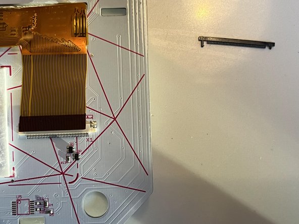

  6. Pocket C.H.I.P. Teardown, Unplug the screen: crwdns2935265:06crwdnd2935265:01crwdnd2935265:02crwdne2935265:0 Pocket C.H.I.P. Teardown, Unplug the screen: crwdns2935265:06crwdnd2935265:02crwdnd2935265:02crwdne2935265:0
    • The screen connector was hidden by the battery. Now that it's revealed, we can do our thing.
    • Pull the black bar up on both sides. It should come out completely.
    • You can now pull the ribbon cable up.

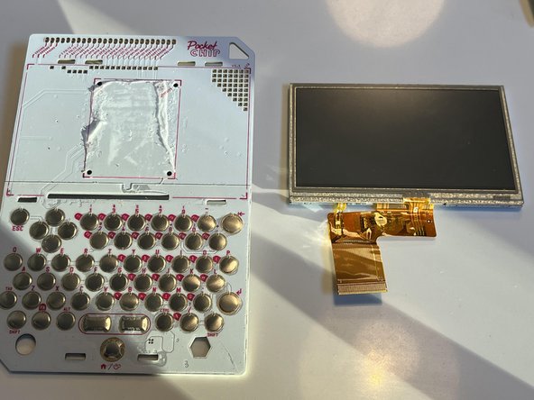

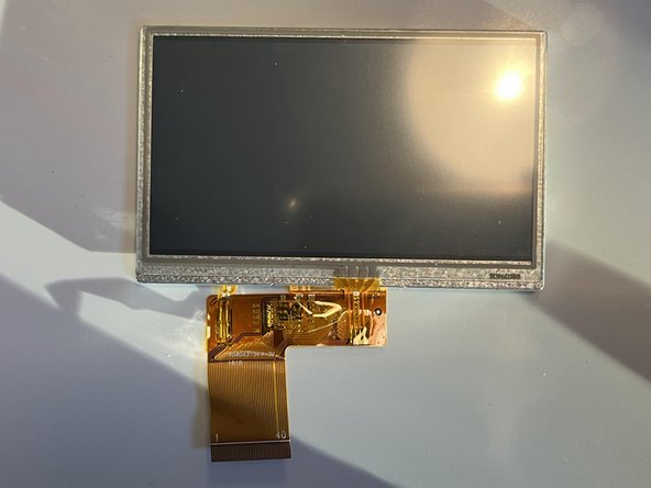

  7. Pocket C.H.I.P. Teardown, Removing the screen: crwdns2935265:07crwdnd2935265:01crwdnd2935265:03crwdne2935265:0 Pocket C.H.I.P. Teardown, Removing the screen: crwdns2935265:07crwdnd2935265:02crwdnd2935265:03crwdne2935265:0 Pocket C.H.I.P. Teardown, Removing the screen: crwdns2935265:07crwdnd2935265:03crwdnd2935265:03crwdne2935265:0
    • There is some adhesive behind the screen. I put a card behind it and kind of sawed it off to remove it.
  8. Pocket C.H.I.P. Teardown, The finale: crwdns2935265:08crwdnd2935265:01crwdnd2935265:01crwdne2935265:0
    • That's it, we've taken apart the Pocket chip! The only pieces are
    • The main board with the keyboard
    • The main CHIP computer
    • The LiPo battery
    • The screen
    • And the back case.
