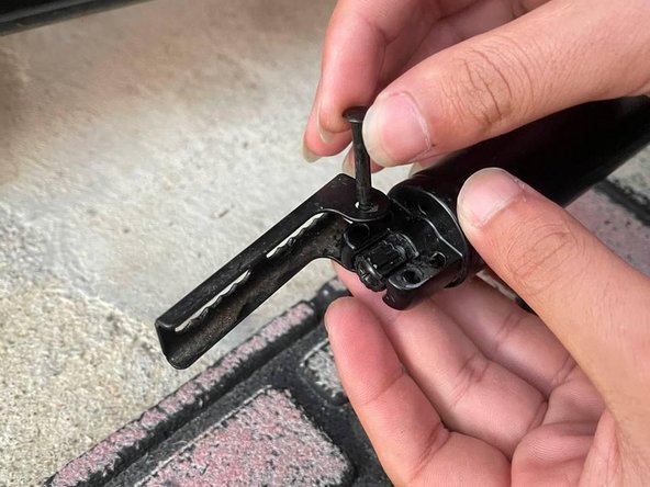

    • Identify the broken part of the door.

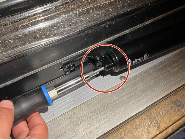

  2. Pneumatic Door Closer Replacement: crwdns2935265:02crwdnd2935265:01crwdnd2935265:02crwdne2935265:0 Pneumatic Door Closer Replacement: crwdns2935265:02crwdnd2935265:02crwdnd2935265:02crwdne2935265:0

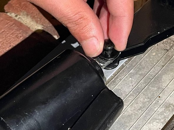

    • Remove the screws from the inner brackets that connect to the door closer using a screwdriver.

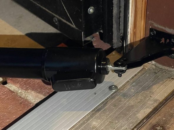

  3. Pneumatic Door Closer Replacement: crwdns2935265:03crwdnd2935265:01crwdnd2935265:03crwdne2935265:0 Pneumatic Door Closer Replacement: crwdns2935265:03crwdnd2935265:02crwdnd2935265:03crwdne2935265:0 Pneumatic Door Closer Replacement: crwdns2935265:03crwdnd2935265:03crwdnd2935265:03crwdne2935265:0

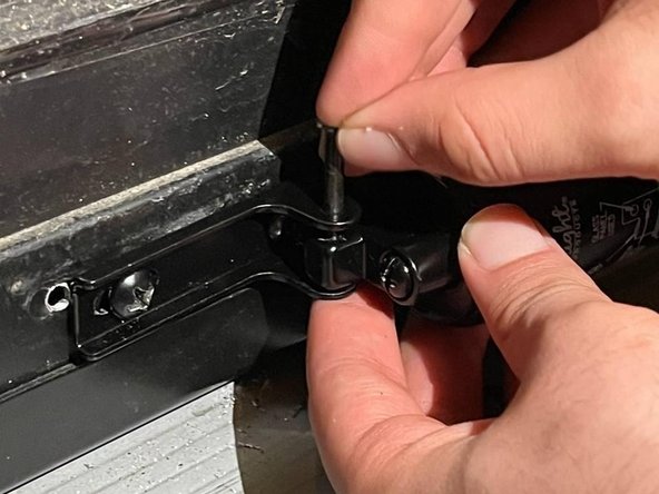

    • Remove the screws from the outer bracket that connect to the door closer using a screwdriver.

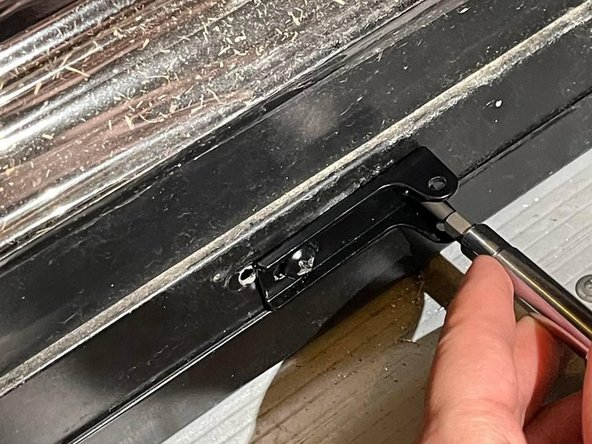

  4. Pneumatic Door Closer Replacement: crwdns2935265:04crwdnd2935265:01crwdnd2935265:02crwdne2935265:0 Pneumatic Door Closer Replacement: crwdns2935265:04crwdnd2935265:02crwdnd2935265:02crwdne2935265:0

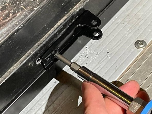

    • Install the inner bracket that attaches to the door closer by screwing the inner part into the wall using a screwdriver.

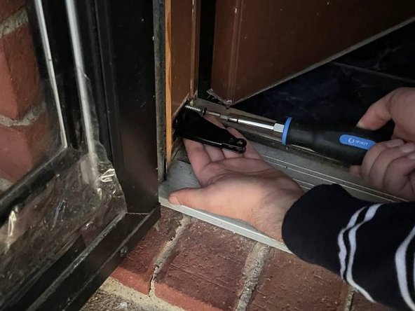

  5. Pneumatic Door Closer Replacement: crwdns2935265:05crwdnd2935265:01crwdnd2935265:03crwdne2935265:0 Pneumatic Door Closer Replacement: crwdns2935265:05crwdnd2935265:02crwdnd2935265:03crwdne2935265:0 Pneumatic Door Closer Replacement: crwdns2935265:05crwdnd2935265:03crwdnd2935265:03crwdne2935265:0
    • Plug the smallest included screw into the inner bracket to attach the door closer.

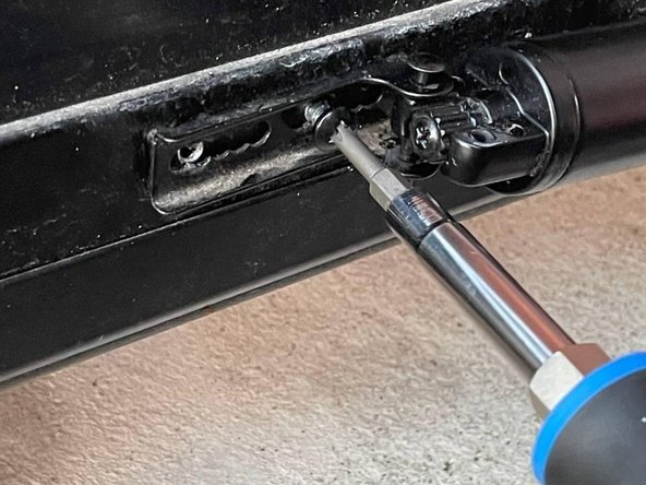

  6. Pneumatic Door Closer Replacement: crwdns2935265:06crwdnd2935265:01crwdnd2935265:03crwdne2935265:0 Pneumatic Door Closer Replacement: crwdns2935265:06crwdnd2935265:02crwdnd2935265:03crwdne2935265:0 Pneumatic Door Closer Replacement: crwdns2935265:06crwdnd2935265:03crwdnd2935265:03crwdne2935265:0
    • Close the door.
    • Install the outer bracket that attaches to the door closer by screwing it into the door using a screwdriver.
  7. Pneumatic Door Closer Replacement: crwdns2935265:07crwdnd2935265:01crwdnd2935265:03crwdne2935265:0 Pneumatic Door Closer Replacement: crwdns2935265:07crwdnd2935265:02crwdnd2935265:03crwdne2935265:0 Pneumatic Door Closer Replacement: crwdns2935265:07crwdnd2935265:03crwdnd2935265:03crwdne2935265:0

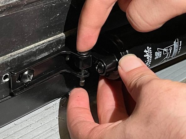

    • Attach the door closer into the installed outer bracket by plugging the larger included screw into the inner part.
  8. Pneumatic Door Closer Replacement: crwdns2935265:08crwdnd2935265:01crwdnd2935265:02crwdne2935265:0 Pneumatic Door Closer Replacement: crwdns2935265:08crwdnd2935265:02crwdnd2935265:02crwdne2935265:0
    • Make sure the door closes and opens properly.
    • Adjust the hydraulics by loosening or tightening the screw on the top of the hydraulic axle to have optimal performance.
