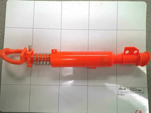

    4. Plunger and O-ring Replacement Guide: crwdns2935265:04crwdnd2935265:01crwdnd2935265:02crwdne2935265:0 Plunger and O-ring Replacement Guide: crwdns2935265:04crwdnd2935265:02crwdnd2935265:02crwdne2935265:0
      • Lift the barrel and plunger strait up being carful to not lose the locking spring.
      • Pull the plunger out of the barrel
    5. Plunger and O-ring Replacement Guide: crwdns2935265:05crwdnd2935265:01crwdnd2935265:01crwdne2935265:0
      • At this point you will be able to tell whether the O-ring has failed or if the plunger has broken.
      • If the O-ring has failed, simply buy a replacement O-ring of appropriate size from a hardware store and slip it over the end of the plunger.
      • If the plunger has broken see step 6
    6. Plunger and O-ring Replacement Guide: crwdns2935265:06crwdnd2935265:01crwdnd2935265:01crwdne2935265:0
      • Attempting to glue the plunger will most likely result in a bad O-ring seal causing the blaster to not function correctly.
      • The best course of action would be to obtain an new plunger and replace it.
      • Be sure to put the locking mechanism on in the correct orientation.
