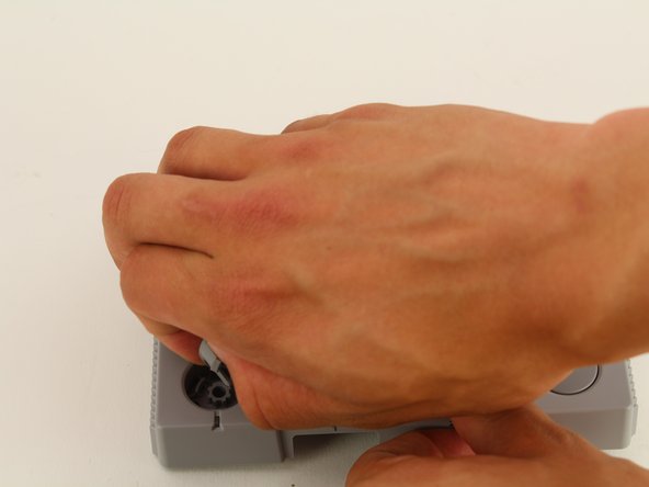

      • Flip the console so its back is facing up.
    2. Playstation Classic Power Button Replacement: crwdns2935265:02crwdnd2935265:01crwdnd2935265:01crwdne2935265:0
      • Remove the five 8mm screws using the Phillips #00 screwdriver.
      • Make sure to keep your screws together in a secure location to avoid misplacement.

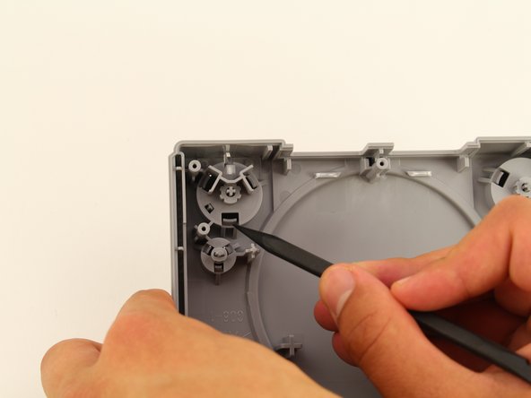

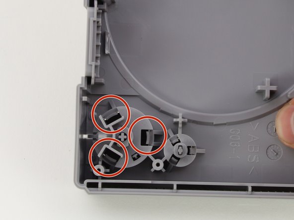

      • After removing the motherboard, position the casing so that the back of the power button is visible.
      • Use a spudger to apply pressure inward on the three plastic clips.
      • This will loosen the button enough to remove it from its position.

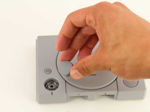

    2. Playstation Classic Power Button Replacement: crwdns2935265:08crwdnd2935265:01crwdnd2935265:03crwdne2935265:0 Playstation Classic Power Button Replacement: crwdns2935265:08crwdnd2935265:02crwdnd2935265:03crwdne2935265:0 Playstation Classic Power Button Replacement: crwdns2935265:08crwdnd2935265:03crwdnd2935265:03crwdne2935265:0
      • Flip the casing to its front and remove the loose button with your hand.
      • Leave the spring in its original position.
To reassemble your device, follow these instructions in reverse order.
