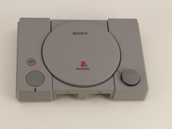

    • Flip the console so its back is facing up.
  2. Playstation Classic Open Button Replacement: crwdns2935265:02crwdnd2935265:01crwdnd2935265:01crwdne2935265:0
    • Remove the five 8mm screws using the Phillips #00 screwdriver.
    • Make sure to keep your screws together in a secure location to avoid misplacement.

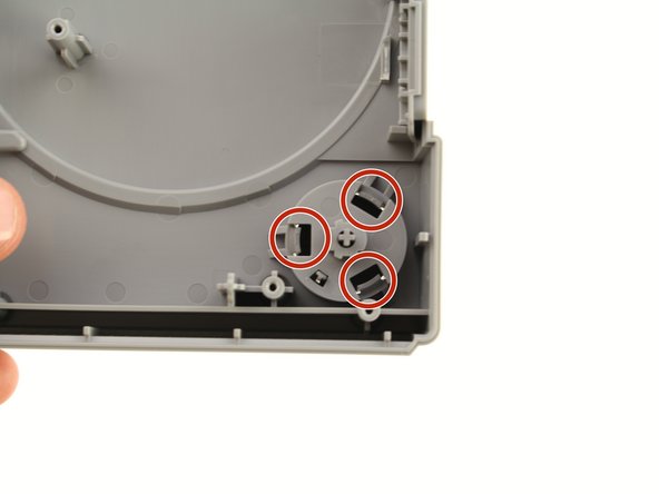

  7. Playstation Classic Open Button Replacement, Open Button: crwdns2935265:07crwdnd2935265:01crwdnd2935265:03crwdne2935265:0 Playstation Classic Open Button Replacement, Open Button: crwdns2935265:07crwdnd2935265:02crwdnd2935265:03crwdne2935265:0 Playstation Classic Open Button Replacement, Open Button: crwdns2935265:07crwdnd2935265:03crwdnd2935265:03crwdne2935265:0
    • Remove the motherboard using the previous guide and isolate the top shell of the casing.
    • Use the Spudger to apply pressure inwards on the three plastic clips highlighted in the red circles.

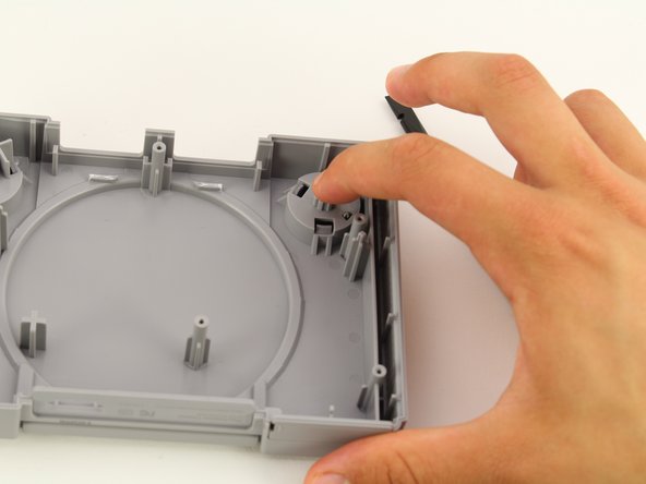

  8. Playstation Classic Open Button Replacement: crwdns2935265:08crwdnd2935265:01crwdnd2935265:03crwdne2935265:0 Playstation Classic Open Button Replacement: crwdns2935265:08crwdnd2935265:02crwdnd2935265:03crwdne2935265:0 Playstation Classic Open Button Replacement: crwdns2935265:08crwdnd2935265:03crwdnd2935265:03crwdne2935265:0
    • After all three clips are pushed in, apply pressure on the cylindrical piece circled in red.
    • Push softly on the button till a small gap is created on the other side.
    • You are not trying to fully remove the Open Button in this step.

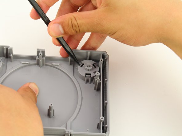

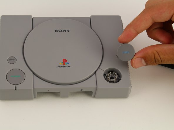

  9. Playstation Classic Open Button Replacement: crwdns2935265:09crwdnd2935265:01crwdnd2935265:03crwdne2935265:0 Playstation Classic Open Button Replacement: crwdns2935265:09crwdnd2935265:02crwdnd2935265:03crwdne2935265:0 Playstation Classic Open Button Replacement: crwdns2935265:09crwdnd2935265:03crwdnd2935265:03crwdne2935265:0
    • Use the black spudger to softly pry out the open button from the top of the casing.
    • Once enough of a gap has been created, use your fingers to grab and slowly remove the open piece.
    • An unrestrained string is under the open button and can fall out easily. To avoid losing the spring, complete this step on a flat surface and be gentle while removing the open button.
