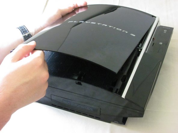

    • Slide the top cover down about half an inch.
    • Lift the cover off of the PS3.

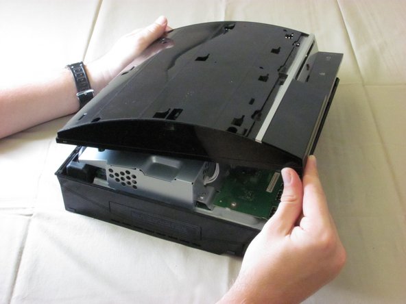

  4. Playstation 3 Optical Drive Replacement: crwdns2935265:04crwdnd2935265:01crwdnd2935265:02crwdne2935265:0 Playstation 3 Optical Drive Replacement: crwdns2935265:04crwdnd2935265:02crwdnd2935265:02crwdne2935265:0

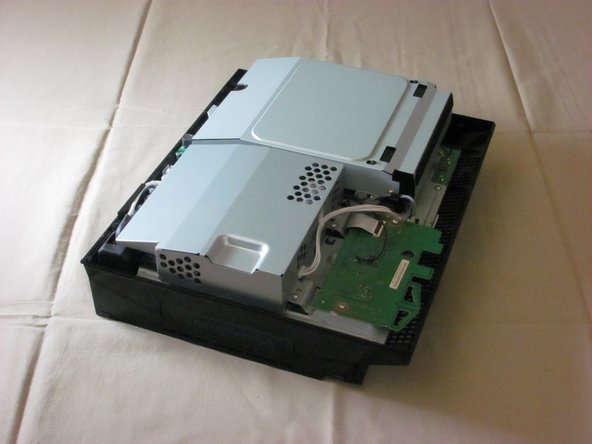

    • Remove the seven screws in the top cover with a Phillips #2 screwdriver.
    • One of the screws is shorter than the others. The short screw is marked in yellow.

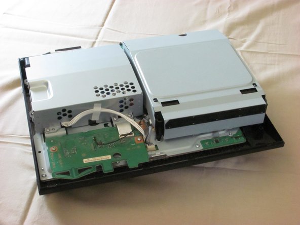

  5. Playstation 3 Optical Drive Replacement: crwdns2935265:05crwdnd2935265:01crwdnd2935265:03crwdne2935265:0 Playstation 3 Optical Drive Replacement: crwdns2935265:05crwdnd2935265:02crwdnd2935265:03crwdne2935265:0 Playstation 3 Optical Drive Replacement: crwdns2935265:05crwdnd2935265:03crwdnd2935265:03crwdne2935265:0
    • You can now lift off the top cover.

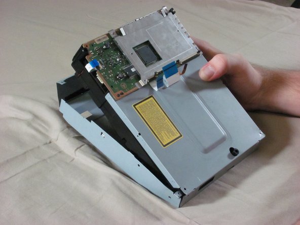

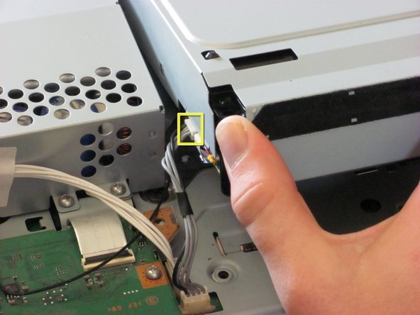

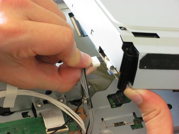

  6. Playstation 3 Optical Drive Replacement, Optical Drive: crwdns2935265:06crwdnd2935265:01crwdnd2935265:03crwdne2935265:0 Playstation 3 Optical Drive Replacement, Optical Drive: crwdns2935265:06crwdnd2935265:02crwdnd2935265:03crwdne2935265:0 Playstation 3 Optical Drive Replacement, Optical Drive: crwdns2935265:06crwdnd2935265:03crwdnd2935265:03crwdne2935265:0
    • Lift the optical drive enclosure and disconnect the grey wires.
    • Do not lift it too far up before disconnecting the wires.

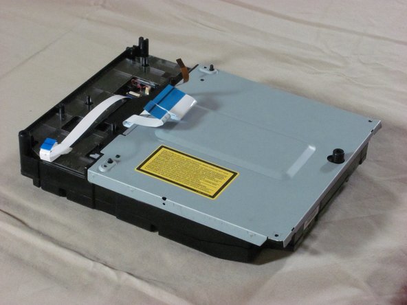

  8. Playstation 3 Optical Drive Replacement: crwdns2935265:08crwdnd2935265:01crwdnd2935265:01crwdne2935265:0
    • Remove the optical drive enclosure from the PS3.

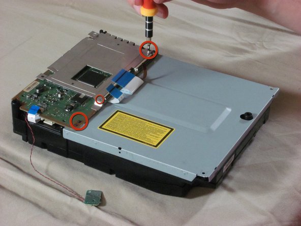

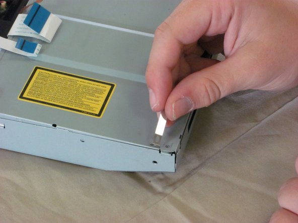

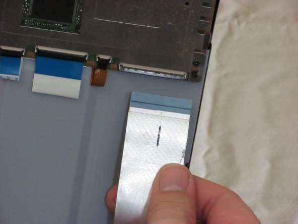

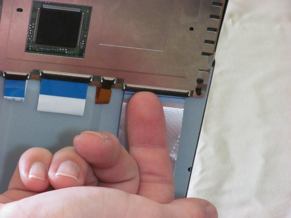

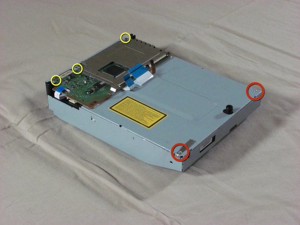

    • Flip over the optical drive enclosure. There are four ribbon cables connected to the circuit board. Using a spudger or your finger, lift each ribbon cable latch and disconnect each ribbon cable.
    • Remove the three screws on the board with a Phillips #00 screwdriver.
    • Remove the two silver screws on the bottom of the case. These screws are different from the ones on the board and should be kept separate.
    • Note: The longer of these two screws holds down a metal tab that comes loose as seen in the third picture.
  10. Playstation 3 Optical Drive Replacement: crwdns2935265:010crwdnd2935265:01crwdnd2935265:02crwdne2935265:0 Playstation 3 Optical Drive Replacement: crwdns2935265:010crwdnd2935265:02crwdnd2935265:02crwdne2935265:0
    • Using your thumbs, carefully bend out the sides of the metal enclosure.
    • Lift the plastic enclosure out of the metal enclosure.

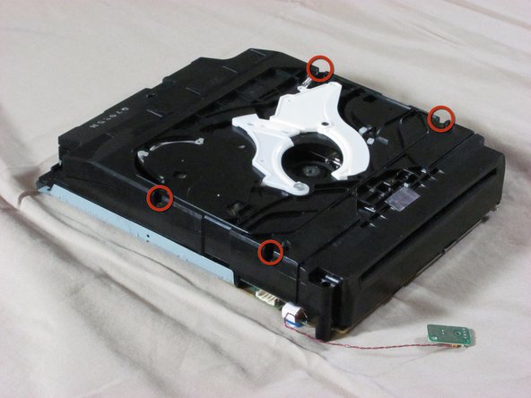

  11. Playstation 3 Optical Drive Replacement: crwdns2935265:011crwdnd2935265:01crwdnd2935265:03crwdne2935265:0 Playstation 3 Optical Drive Replacement: crwdns2935265:011crwdnd2935265:02crwdnd2935265:03crwdne2935265:0 Playstation 3 Optical Drive Replacement: crwdns2935265:011crwdnd2935265:03crwdnd2935265:03crwdne2935265:0

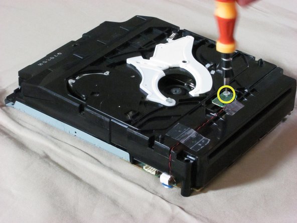

    • Flip over the enclosure so that the circuit board is on the bottom and the optical sensor is on top.
    • Remove the screw on the optical sensor using a Phillips #00 screwdriver.
    • Remove the tape on the red and black wires that connect to the optical sensor. With the wires still attached, take the sensor off the ensclosure.
    • The wires on the optical sensor are very weak. They will break easily if excessive force is applied to them.
    • Remove the four black screws on the edges of the enclosure using a Phillips #00 screwdriver.
    • After taking out the screws, you don't have to open the enclosure just yet.

  13. Playstation 3 Optical Drive Replacement: crwdns2935265:013crwdnd2935265:01crwdnd2935265:03crwdne2935265:0 Playstation 3 Optical Drive Replacement: crwdns2935265:013crwdnd2935265:02crwdnd2935265:03crwdne2935265:0 Playstation 3 Optical Drive Replacement: crwdns2935265:013crwdnd2935265:03crwdnd2935265:03crwdne2935265:0
    • Lift the circuit board off the enclosure.
    • The metal EM shield on the circuit board is loose, so make sure to keep it together with the circuit board.
    • Remove the metal plate.

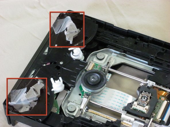

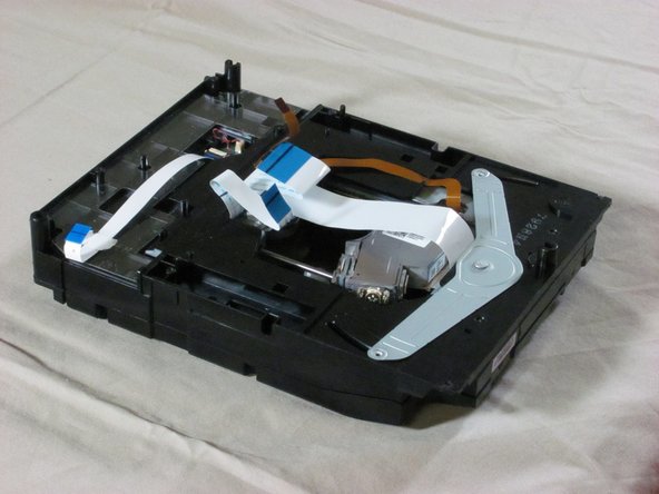

    • Flip over the enclosure. Remove the black, plastic cover so that the drive and its enclosure match the first picture.
    • Proceed carefully. There are loose parts inside the optical drive. We recommend that you tape these parts.

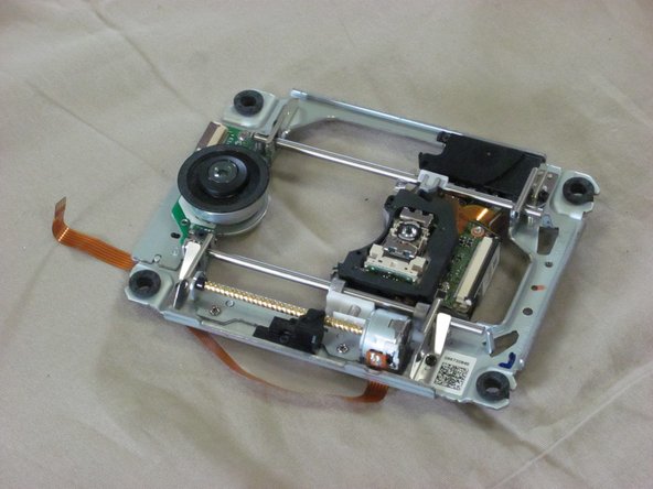

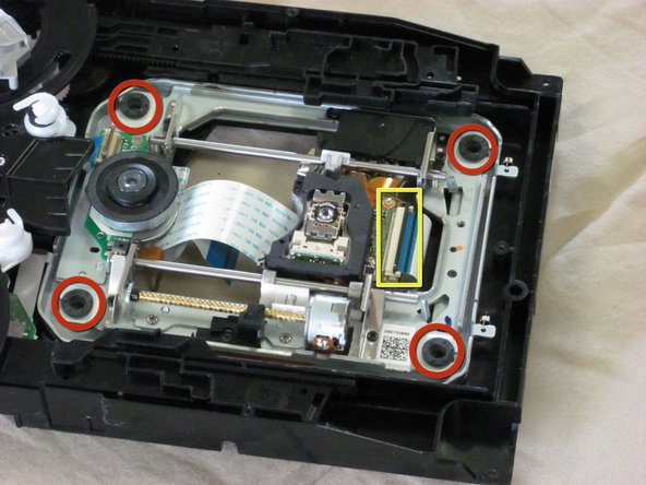

  15. Playstation 3 Optical Drive Replacement: crwdns2935265:015crwdnd2935265:01crwdnd2935265:02crwdne2935265:0 Playstation 3 Optical Drive Replacement: crwdns2935265:015crwdnd2935265:02crwdnd2935265:02crwdne2935265:0
    • Using a spudger, lift the brown latch and disconnect the small ribbon cable.
    • Remove the four fat screws in the corners of the optical drive.
    • Using a spudger, lift the black latch and disconnect the larger ribbon cable.
  16. Playstation 3 Optical Drive Replacement: crwdns2935265:016crwdnd2935265:01crwdnd2935265:02crwdne2935265:0 Playstation 3 Optical Drive Replacement: crwdns2935265:016crwdnd2935265:02crwdnd2935265:02crwdne2935265:0
    • Carefully lift the optical drive out of the enclosure.
