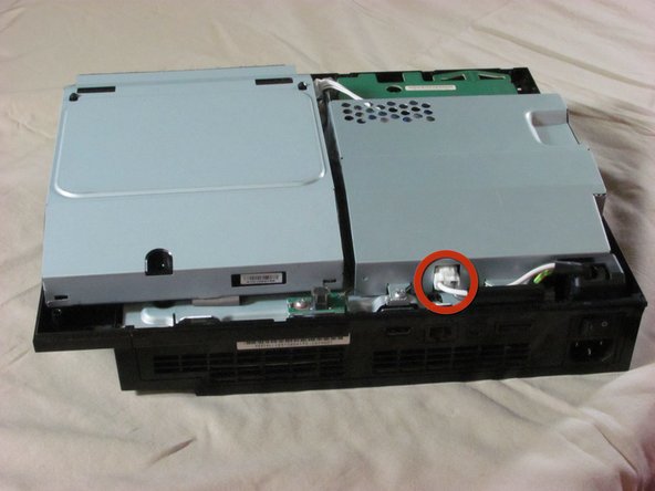

  6. Playstation 3 Motherboard Enclosure Replacement, Power Supply: crwdns2935265:06crwdnd2935265:01crwdnd2935265:02crwdne2935265:0 Playstation 3 Motherboard Enclosure Replacement, Power Supply: crwdns2935265:06crwdnd2935265:02crwdnd2935265:02crwdne2935265:0
    • Unplug the white wires connected to the wireless board. There are two sets of wires: one set in the front, one in the back.
    • Push down the tab on the connector to disconnect the wires.
    • Remove the two screws on the front of the power supply.

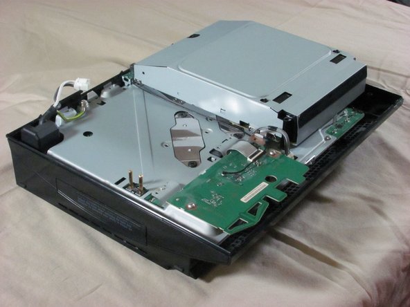

    • Unplug the optical drive power cable.
    • Detach the ribbon cable that connects the optical drive to the motherboard.
    • Set the optical drive aside.

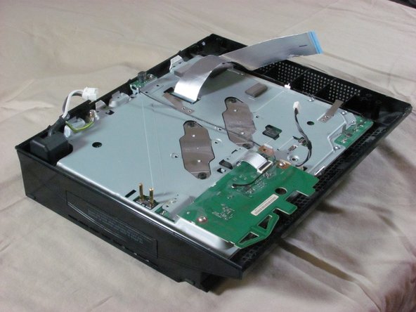

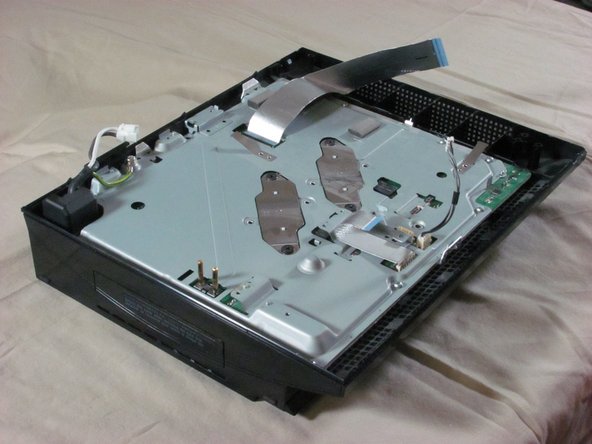

    • Remove three screws (Phillips #2) from the wireless board and antenna.
    • Detach the ribbon cable that connects the wireless board to the motherboard.
  11. Playstation 3 Motherboard Enclosure Replacement: crwdns2935265:011crwdnd2935265:01crwdnd2935265:01crwdne2935265:0

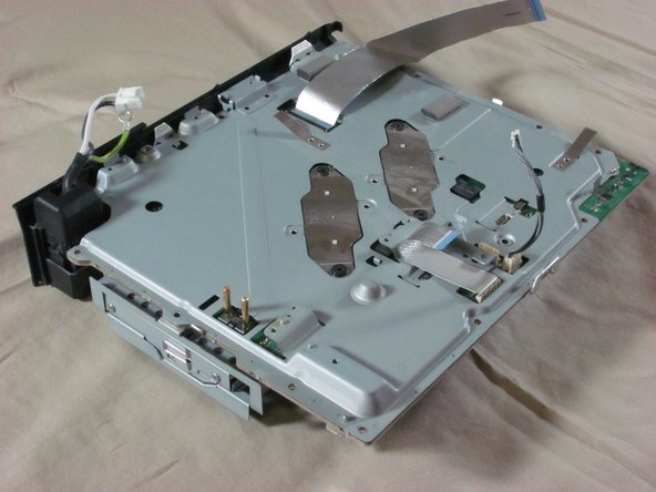

    • Remove nine screws (Phillips #2) from the perimeter of the metal plate covering the motherboard.
  12. Playstation 3 Motherboard Enclosure Replacement: crwdns2935265:012crwdnd2935265:01crwdnd2935265:03crwdne2935265:0 Playstation 3 Motherboard Enclosure Replacement: crwdns2935265:012crwdnd2935265:02crwdnd2935265:03crwdne2935265:0 Playstation 3 Motherboard Enclosure Replacement: crwdns2935265:012crwdnd2935265:03crwdnd2935265:03crwdne2935265:0

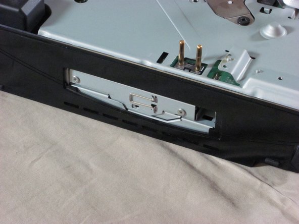

    • Remove the hard drive door with a spudger.
    • Lift the metal enclosure out of the plastic bottom case.
