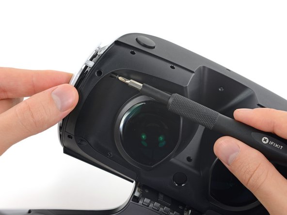

    • The scope relies on a rubber mask, rather than goggle foam and a tight fit, to block light. As a bonus, it's probably more washable than foam.
    • With the user-replaceable rubber shield peeled away, we're treated to simple JIS screws (Phillips' pointed-headed cousins) holding the scope together.
    • We gleefully pry the futuristic plastic trim (and LED diffusers) away with our trusty opening pick.
    • And peeking out just behind, we've found the first of the 9 position-tracking LEDs. Soon.

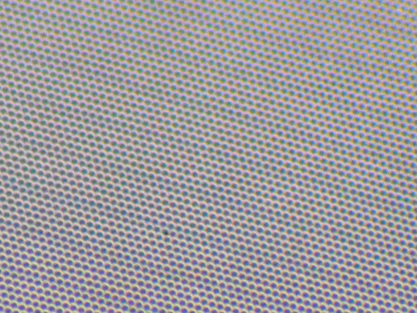

  12. PlayStation VR Teardown: crwdns2935265:013crwdnd2935265:01crwdnd2935265:03crwdne2935265:0 PlayStation VR Teardown: crwdns2935265:013crwdnd2935265:02crwdnd2935265:03crwdne2935265:0 PlayStation VR Teardown: crwdns2935265:013crwdnd2935265:03crwdnd2935265:03crwdne2935265:0

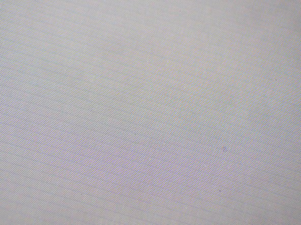

    • Sony's been touting the subpixel matrix in this display, so we decided to whip out our microscope and take a closer look.
    • On the left we have a traditional LED-backlit IPS display from an iPhone 6s.
    • And on the right is PS VR's AMOLED display featuring a hexagonal subpixel matrix, consistent with other Samsung-made OLED displays found in their flagship smartphones.
    • And because we know you can't see those subpixels we've included a magnified view of the OLED panel. Although there is only an 18% increase in pixel density, the pixels on the headset display seem tiny due to its unique subpixel matrix.

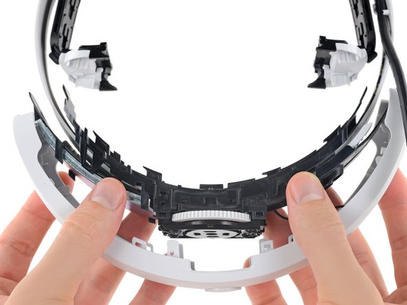

    • Time to tackle that headband!
    • First up, we pop out the squishy headband cushions. No glue or screws here, so fret not, sweaty friends. The prospect of future cushion swaps look good.
    • We have nice little counterweights on either side of of the adjustment knob to offset the scope's display and lens mass. There's just a dab of glue and some clips holding them in place, so they're easily scooped out.
    • Because these weights are purely for balance, let's take them out and then compare across the big three, to see who could make the lightest headset. Removing their 95 g puts the PS VR at around 515 g. That puts it right between the Vive's 563 g and the Rift's 470 g.

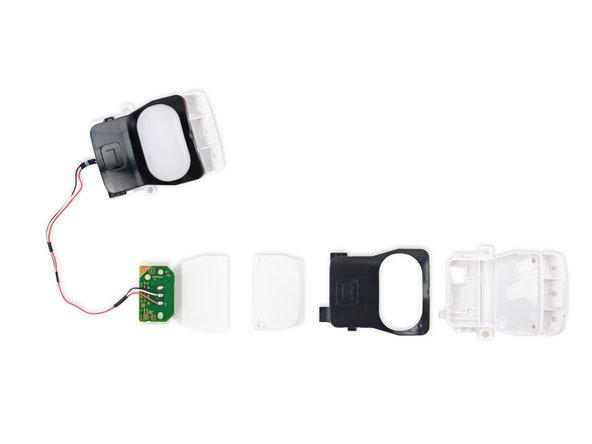

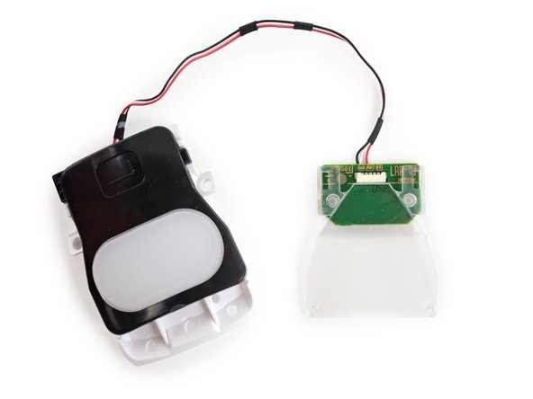

    • Last out of the headband, the pair of "back up" lights.
    • These are the two LED assemblies that allow the position tracking system to keep an eye on you when you're looking over your shoulder, keeping the in-world feel alive.
    • The assemblies are also conveniently labeled right and left. Labels make a fixer's heart glad.
    • With a bit less space to spare in the headband than in the visor section, these LEDs light the edge of a light guide before passing through the diffuser.

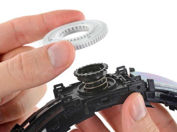

    • Before we leave the headband for dead(band), we pop open the band adjustment mechanism.
    • A spring-loaded pinion gear assembly rotates against two racks that spread or contract, tightening or loosening the band.
    • A locking mechanism built into the gear assembly prevents the band's adjustment from slipping while you're swinging your head around in the zone.
