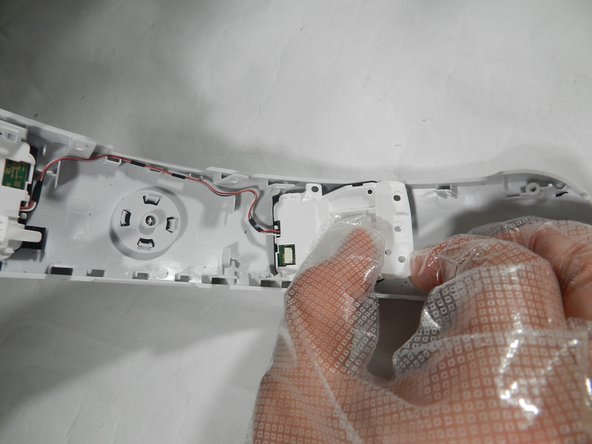

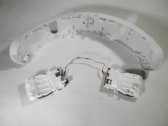

  8. PlayStation VR Rear LED Tracker Board Replacement, Rear LED Tracker Board: crwdns2935265:08crwdnd2935265:01crwdnd2935265:03crwdne2935265:0 PlayStation VR Rear LED Tracker Board Replacement, Rear LED Tracker Board: crwdns2935265:08crwdnd2935265:02crwdnd2935265:03crwdne2935265:0 PlayStation VR Rear LED Tracker Board Replacement, Rear LED Tracker Board: crwdns2935265:08crwdnd2935265:03crwdnd2935265:03crwdne2935265:0
    • Once the rear headband is removed, both rear LED tracker boards can be identified as the white components labelled 'L' and 'R' on the rear of the band.
    • Remove the single 5 mm screw from each of the LED tracker boards using a Phillips #00 screwdriver.
    • Gently pull up and slide each tracker board outward, away from the center of the band, in order to free it from the rear headband shell.

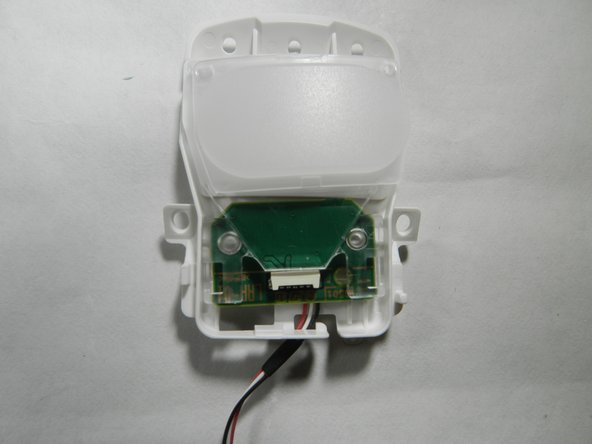

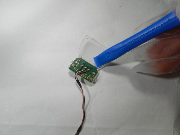

  9. PlayStation VR Rear LED Tracker Board Replacement: crwdns2935265:09crwdnd2935265:01crwdnd2935265:03crwdne2935265:0 PlayStation VR Rear LED Tracker Board Replacement: crwdns2935265:09crwdnd2935265:02crwdnd2935265:03crwdne2935265:0 PlayStation VR Rear LED Tracker Board Replacement: crwdns2935265:09crwdnd2935265:03crwdnd2935265:03crwdne2935265:0
    • The tracker board assembly is comprised of two shell halves.
    • Gently pry on the black tabs on the outward edge of the shell to free the two halves from each other.
    • Then gently pry outward on the internal tracker board to free each one from the opaque lens.

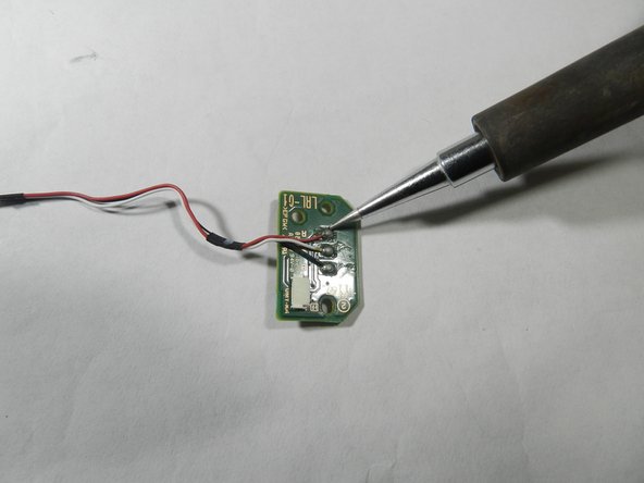

  10. PlayStation VR Rear LED Tracker Board Replacement: crwdns2935265:010crwdnd2935265:01crwdnd2935265:02crwdne2935265:0 PlayStation VR Rear LED Tracker Board Replacement: crwdns2935265:010crwdnd2935265:02crwdnd2935265:02crwdne2935265:0
    • Use a soldering iron in order to remove the three wires (black, white, red) from the faulty tracker board.
