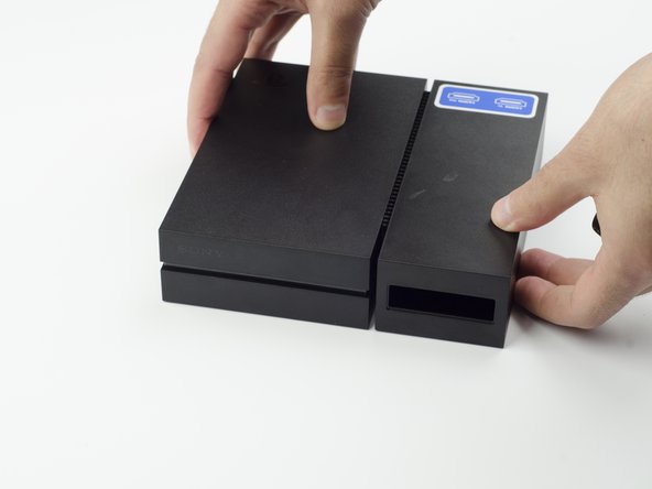

    2. PlayStation VR Processor Unit Cooling Fan Replacement: crwdns2935265:02crwdnd2935265:01crwdnd2935265:03crwdne2935265:0 PlayStation VR Processor Unit Cooling Fan Replacement: crwdns2935265:02crwdnd2935265:02crwdnd2935265:03crwdne2935265:0 PlayStation VR Processor Unit Cooling Fan Replacement: crwdns2935265:02crwdnd2935265:03crwdnd2935265:03crwdne2935265:0
      • Press and slide the side panel (it will have the two ports) back to reveal an additional 6 mm screw.
      • Unscrew the 6mm screw with a PH #000 screwdriver.
    3. PlayStation VR Processor Unit Cooling Fan Replacement: crwdns2935265:03crwdnd2935265:01crwdnd2935265:02crwdne2935265:0 PlayStation VR Processor Unit Cooling Fan Replacement: crwdns2935265:03crwdnd2935265:02crwdnd2935265:02crwdne2935265:0
      • Slide the panel back into place.

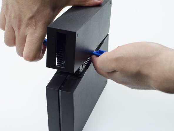

    4. PlayStation VR Processor Unit Cooling Fan Replacement: crwdns2935265:04crwdnd2935265:01crwdnd2935265:03crwdne2935265:0 PlayStation VR Processor Unit Cooling Fan Replacement: crwdns2935265:04crwdnd2935265:02crwdnd2935265:03crwdne2935265:0 PlayStation VR Processor Unit Cooling Fan Replacement: crwdns2935265:04crwdnd2935265:03crwdnd2935265:03crwdne2935265:0
      • Using a plastic opening tool, carefully pry the panel from the main console to reveal the HDMI ports.
      • You will probably need to lift it on both sides in order for the panel to come loose.
