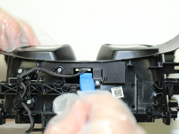

  24. PlayStation VR Infrared Range Finder Replacement, Infrared Range Finder: crwdns2935265:024crwdnd2935265:01crwdnd2935265:02crwdne2935265:0 PlayStation VR Infrared Range Finder Replacement, Infrared Range Finder: crwdns2935265:024crwdnd2935265:02crwdnd2935265:02crwdne2935265:0
    • Remove two silver 4mm screws from the bracket assembly containing IMU/infrared range finder board using a Phillips #00 screwdriver.
    • Use an opening tool to pry the connecter from the board.

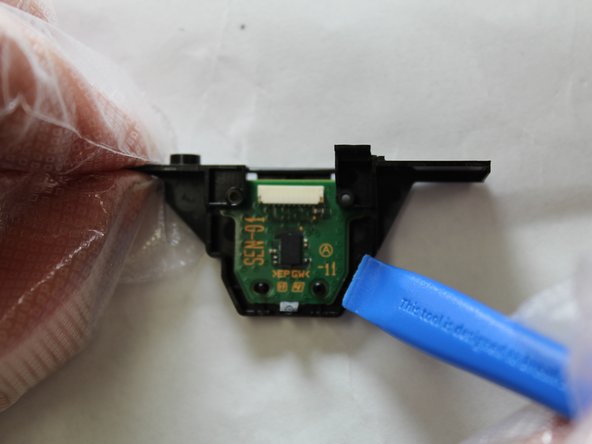

  25. PlayStation VR Infrared Range Finder Replacement: crwdns2935265:025crwdnd2935265:01crwdnd2935265:02crwdne2935265:0 PlayStation VR Infrared Range Finder Replacement: crwdns2935265:025crwdnd2935265:02crwdnd2935265:02crwdne2935265:0
    • Gently pry outward with an opening tool to remove the board from the bracket assembly.
  26. PlayStation VR Infrared Range Finder Replacement: crwdns2935265:026crwdnd2935265:01crwdnd2935265:01crwdne2935265:0
    • Desolder the faulty infrared range finder from the backside of the board.
