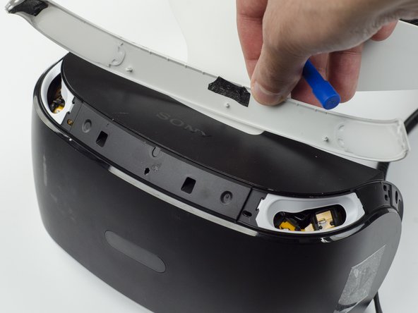

    • Use the plastic opening tool to pry the top white plastic panel free from the headset.
    • Do not try to remove the bottom plastic panel. There is a screw attaching it that must be removed first.
    • There may be a small amount of adhesive attaching the top panel to the headset, in which case you may need to use a bit more force to remove the panel.

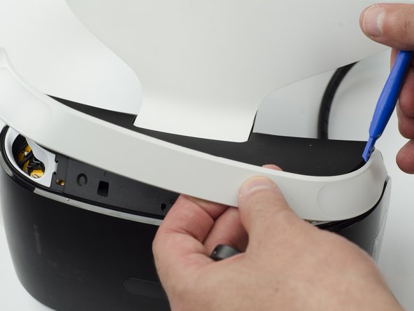

  6. PlayStation VR Headset Lenses Replacement: crwdns2935265:06crwdnd2935265:01crwdnd2935265:03crwdne2935265:0 PlayStation VR Headset Lenses Replacement: crwdns2935265:06crwdnd2935265:02crwdnd2935265:03crwdne2935265:0 PlayStation VR Headset Lenses Replacement: crwdns2935265:06crwdnd2935265:03crwdnd2935265:03crwdne2935265:0
    • Using the plastic opening tool, pry the bottom white plastic panel loose and remove it from the headset.
    • There is adhesive attaching the panel to the headset, in which case it will take more force to remove the panel.

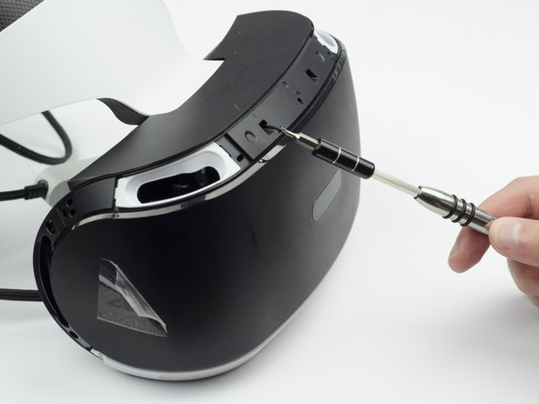

    • Unscrew the two 7 mm screws from the top of the headset.

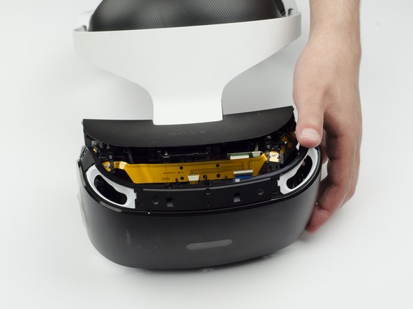

  8. PlayStation VR Headset Lenses Replacement: crwdns2935265:08crwdnd2935265:01crwdnd2935265:03crwdne2935265:0 PlayStation VR Headset Lenses Replacement: crwdns2935265:08crwdnd2935265:02crwdnd2935265:03crwdne2935265:0 PlayStation VR Headset Lenses Replacement: crwdns2935265:08crwdnd2935265:03crwdnd2935265:03crwdne2935265:0
    • Using your fingers, carefully pry the black front panel free from the headset.
    • We recommend that you start the removal from the sides by pulling them forward.
    • There is adhesive holding the front panel in place, which means you will need a bit of extra force to remove it.

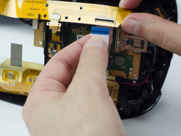

  10. PlayStation VR Headset Lenses Replacement: crwdns2935265:010crwdnd2935265:01crwdnd2935265:03crwdne2935265:0 PlayStation VR Headset Lenses Replacement: crwdns2935265:010crwdnd2935265:02crwdnd2935265:03crwdne2935265:0 PlayStation VR Headset Lenses Replacement: crwdns2935265:010crwdnd2935265:03crwdnd2935265:03crwdne2935265:0

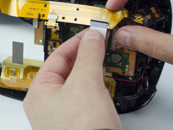

    • Lift the small silver latch attaching the ZIF (zero insertion force) connector to the circuit board.
    • Carefully pull the end of the white ribbon connector from its slot.
    • Be careful not to damage or dirty the ribbon connector.
  11. PlayStation VR Headset Lenses Replacement: crwdns2935265:011crwdnd2935265:01crwdnd2935265:02crwdne2935265:0 PlayStation VR Headset Lenses Replacement: crwdns2935265:011crwdnd2935265:02crwdnd2935265:02crwdne2935265:0
    • Unhitch the yellow led connector ribbon and move it aside.

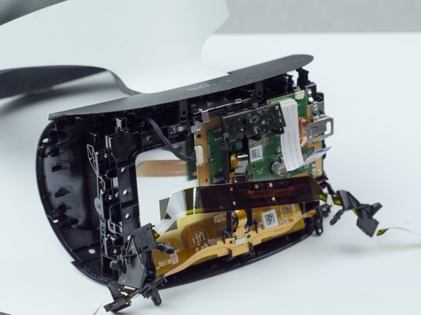

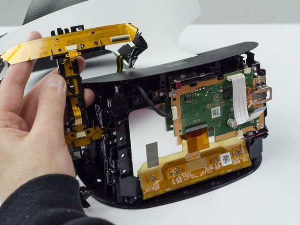

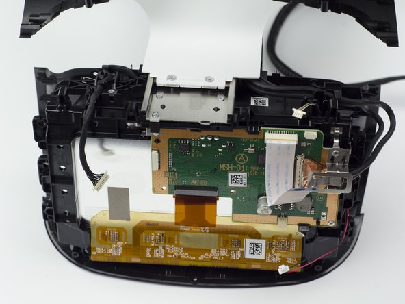

  12. PlayStation VR Headset Lenses Replacement: crwdns2935265:012crwdnd2935265:01crwdnd2935265:03crwdne2935265:0 PlayStation VR Headset Lenses Replacement: crwdns2935265:012crwdnd2935265:02crwdnd2935265:03crwdne2935265:0 PlayStation VR Headset Lenses Replacement: crwdns2935265:012crwdnd2935265:03crwdnd2935265:03crwdne2935265:0
    • Carefully pry the black plastic piece attaching the yellow ribbon to the headset away from the green circuit board.
    • Remove the yellow LED ribbons and black plastic connecting piece from the headset.

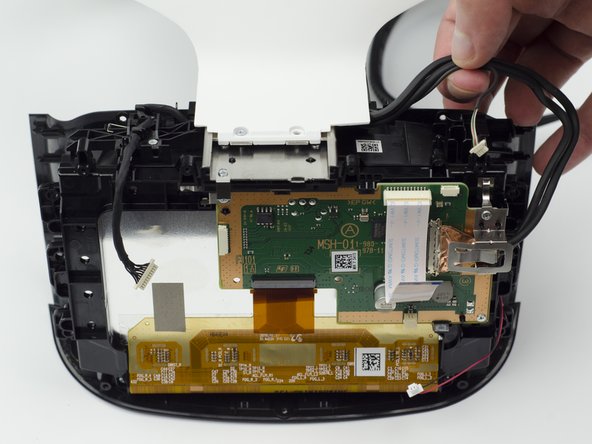

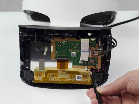

  13. PlayStation VR Headset Lenses Replacement, Headset Lenses: crwdns2935265:013crwdnd2935265:01crwdnd2935265:02crwdne2935265:0 PlayStation VR Headset Lenses Replacement, Headset Lenses: crwdns2935265:013crwdnd2935265:02crwdnd2935265:02crwdne2935265:0
    • Using the tweezers, unplug the three (one black bundled, two multi colored bundled) connector cables from their ports along the circuit board.

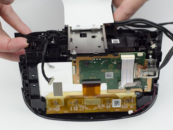

  20. PlayStation VR Headset Lenses Replacement: crwdns2935265:020crwdnd2935265:01crwdnd2935265:02crwdne2935265:0 PlayStation VR Headset Lenses Replacement: crwdns2935265:020crwdnd2935265:02crwdnd2935265:02crwdne2935265:0

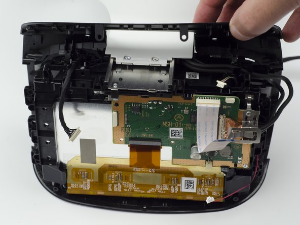

    • Using your fingers, lift up on the sides of the black plastic piece holding the circuit board in place.
    • There are small plastic tabs on the side that latch the piece in place that need to be lifted in order to remove it.

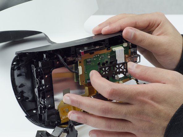

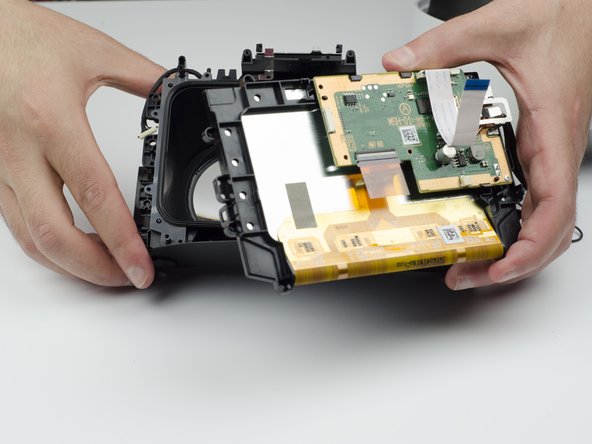

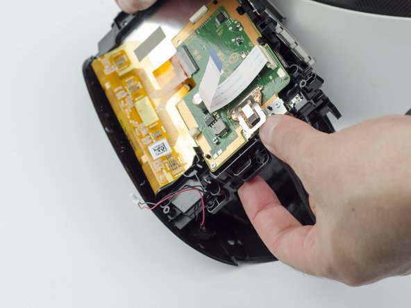

  21. PlayStation VR Headset Lenses Replacement: crwdns2935265:021crwdnd2935265:01crwdnd2935265:02crwdne2935265:0 PlayStation VR Headset Lenses Replacement: crwdns2935265:021crwdnd2935265:02crwdnd2935265:02crwdne2935265:0
    • Carefully lift the circuit board out of the headset and set aside.
    • Take care not to touch the screen.

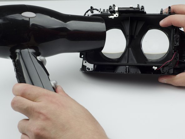

  22. PlayStation VR Headset Lenses Replacement: crwdns2935265:022crwdnd2935265:01crwdnd2935265:02crwdne2935265:0 PlayStation VR Headset Lenses Replacement: crwdns2935265:022crwdnd2935265:02crwdnd2935265:02crwdne2935265:0
    • Using a hairdryer (or heatlamp), warm the area around the lenses. This will help loosen them for removal.
  23. PlayStation VR Headset Lenses Replacement: crwdns2935265:023crwdnd2935265:01crwdnd2935265:02crwdne2935265:0 PlayStation VR Headset Lenses Replacement: crwdns2935265:023crwdnd2935265:02crwdnd2935265:02crwdne2935265:0
    • Using a glass cloth (or any cloth with soft fibers), carefully press on the lenses until they pop out of place.
