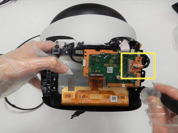

  13. PlayStation VR Display Replacement, Motherboard: crwdns2935265:013crwdnd2935265:01crwdnd2935265:01crwdne2935265:0
    • Remove the two 6mm screws on the L shaped silver clip to the upper left of the motherboard using the Phillips #000 screwdriver.
    • Remove the one 6mm screw that is securing the silver clip on the far right side using the Phillips #000 screwdriver.

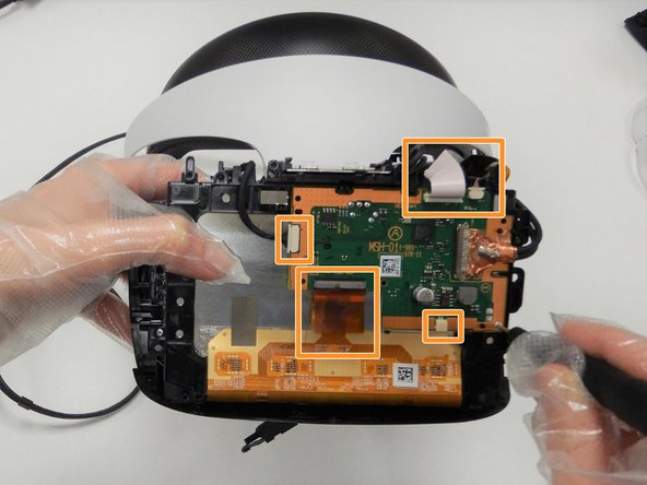

  14. PlayStation VR Display Replacement: crwdns2935265:014crwdnd2935265:01crwdnd2935265:03crwdne2935265:0 PlayStation VR Display Replacement: crwdns2935265:014crwdnd2935265:02crwdnd2935265:03crwdne2935265:0 PlayStation VR Display Replacement: crwdns2935265:014crwdnd2935265:03crwdnd2935265:03crwdne2935265:0
    • Remove the three 6mm screws from the motherboard using the Phillips #000 screwdriver.
    • Unplug the white cable and ribbons from the motherboard(make sure to lift the gates on the ribbons before pulling out).
    • Unplug the HDMI cable by lifting the gate and pulling gently(there will be adhesive).
  15. PlayStation VR Display Replacement: crwdns2935265:015crwdnd2935265:01crwdnd2935265:01crwdne2935265:0
    • Carefully remove the motherboard and place it on a hard dry surface.
