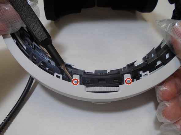

    • Remove a total of four 5 mm screws from inside the left and right sides of the headband using a Phillips #00 screwdriver.

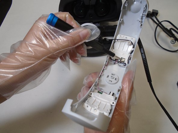

    • Remove three silver 5 mm screws that are securing the rear white cover of the band using a Phillips #00 screwdriver.
  4. PlayStation VR Band Adjuster Replacement: crwdns2935265:04crwdnd2935265:01crwdnd2935265:03crwdne2935265:0 PlayStation VR Band Adjuster Replacement: crwdns2935265:04crwdnd2935265:02crwdnd2935265:03crwdne2935265:0 PlayStation VR Band Adjuster Replacement: crwdns2935265:04crwdnd2935265:03crwdnd2935265:03crwdne2935265:0

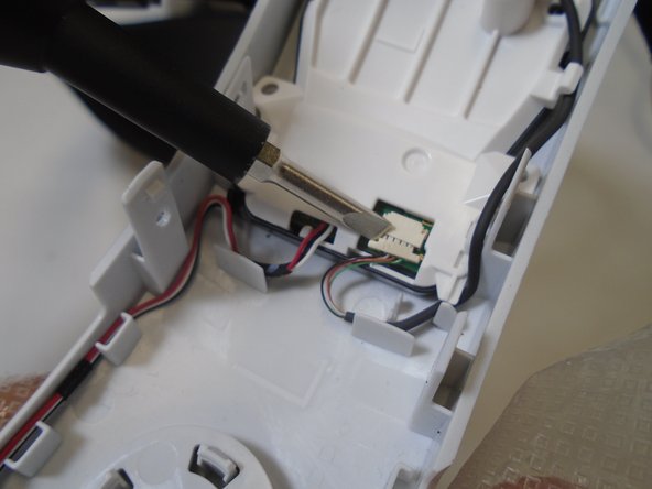

    • Remove the 6 mm screw from the retainer securing wires to the rear band assembly using a Phillips #00 screwdriver.
    • Use a spudger to flip up the retaining flap connected to the rear LEDs.

    • Remove the single 5 mm screw from the center of the headband adjuster using a Phillips #00 screwdriver.

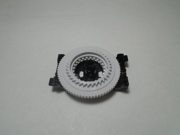

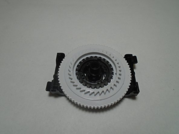

    • Disassemble the adjuster assembly spring, small gear, large gear, and bracket in order to replace the broken component.
