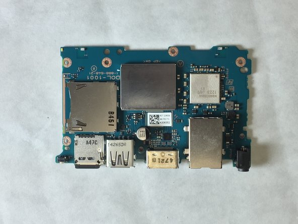

    • Remove the last 6mm Phillips #0 screw from the motherboard.
  5. PlayStation TV Thermal Pad Replacement: crwdns2935265:05crwdnd2935265:01crwdnd2935265:02crwdne2935265:0 PlayStation TV Thermal Pad Replacement: crwdns2935265:05crwdnd2935265:02crwdnd2935265:02crwdne2935265:0
    • Use a plastic opening tool to pry up gently on the motherboard, and remove it.

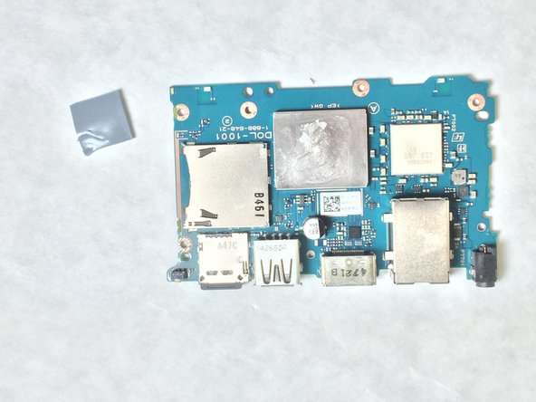

  6. PlayStation TV Thermal Pad Replacement, Thermal Pad: crwdns2935265:06crwdnd2935265:01crwdnd2935265:02crwdne2935265:0 PlayStation TV Thermal Pad Replacement, Thermal Pad: crwdns2935265:06crwdnd2935265:02crwdnd2935265:02crwdne2935265:0
    • Remove the old thermal pad with an ESD safe tool, like a Jimmy.
  7. PlayStation TV Thermal Pad Replacement: crwdns2935265:07crwdnd2935265:01crwdnd2935265:02crwdne2935265:0 PlayStation TV Thermal Pad Replacement: crwdns2935265:07crwdnd2935265:02crwdnd2935265:02crwdne2935265:0
    • Wipe down the area where the old thermal pads were located with rubbing alcohol.
    • It is important that the area be as clean as possible.

Photos for steps 6 through 9 will be posted soon!
Luk Davis - crwdns2934203:0crwdne2934203:0
Do you replace the thermal pad? Your directions do not state where to do this, and if so what part and size do you recommend?
