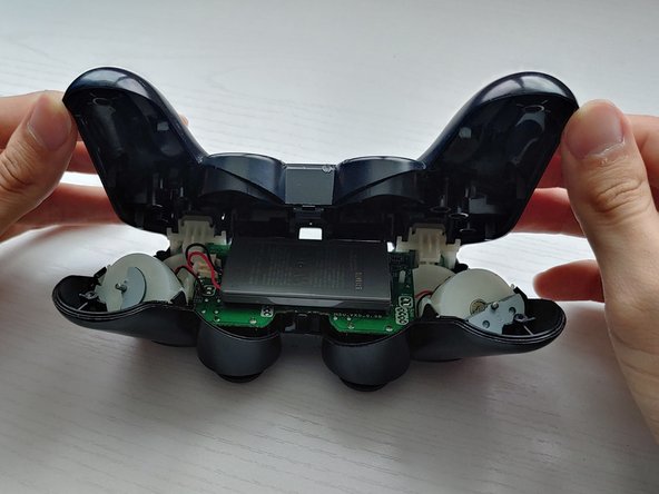

    • Use a Phillips #1 screwdriver to remove the five 7.2 mm screws securing the rear cover.
  3. PlayStation Start and Select Buttons Replacement: crwdns2935265:03crwdnd2935265:01crwdnd2935265:03crwdne2935265:0 PlayStation Start and Select Buttons Replacement: crwdns2935265:03crwdnd2935265:02crwdnd2935265:03crwdne2935265:0 PlayStation Start and Select Buttons Replacement: crwdns2935265:03crwdnd2935265:03crwdnd2935265:03crwdne2935265:0
    • Gently push the rear cover towards the front of the #2 trigger buttons.
    • Lift the rear cover.
    • The #2 trigger buttons may come off when removing the cover.

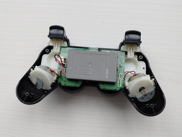

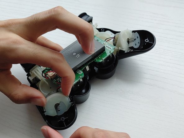

  4. PlayStation Start and Select Buttons Replacement: crwdns2935265:04crwdnd2935265:01crwdnd2935265:02crwdne2935265:0 PlayStation Start and Select Buttons Replacement: crwdns2935265:04crwdnd2935265:02crwdnd2935265:02crwdne2935265:0
    • Lift the battery and set it beside the controller, with care not to strain the wires.

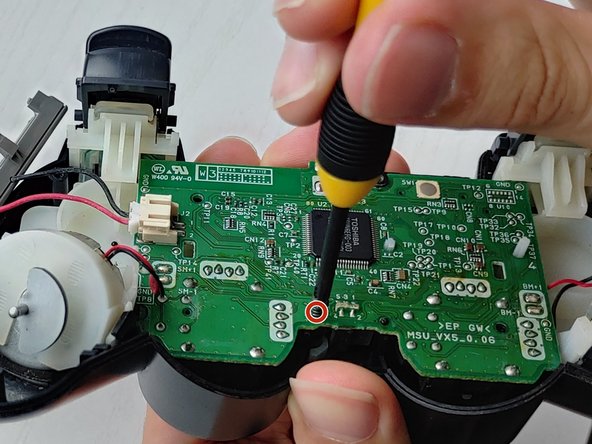

    • Use a Phillips #1 screwdriver to remove the single 7.2 mm screw securing the motherboard.

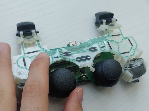

  6. PlayStation Start and Select Buttons Replacement: crwdns2935265:06crwdnd2935265:01crwdnd2935265:02crwdne2935265:0 PlayStation Start and Select Buttons Replacement: crwdns2935265:06crwdnd2935265:02crwdnd2935265:02crwdne2935265:0
    • Lift off the plastic housing holding the motherboard, battery, and vibrating motors.
  7. PlayStation Start and Select Buttons Replacement: crwdns2935265:07crwdnd2935265:01crwdnd2935265:03crwdne2935265:0 PlayStation Start and Select Buttons Replacement: crwdns2935265:07crwdnd2935265:02crwdnd2935265:03crwdne2935265:0 PlayStation Start and Select Buttons Replacement: crwdns2935265:07crwdnd2935265:03crwdnd2935265:03crwdne2935265:0
    • Remove the rubber buttons with a pair of tweezers.
